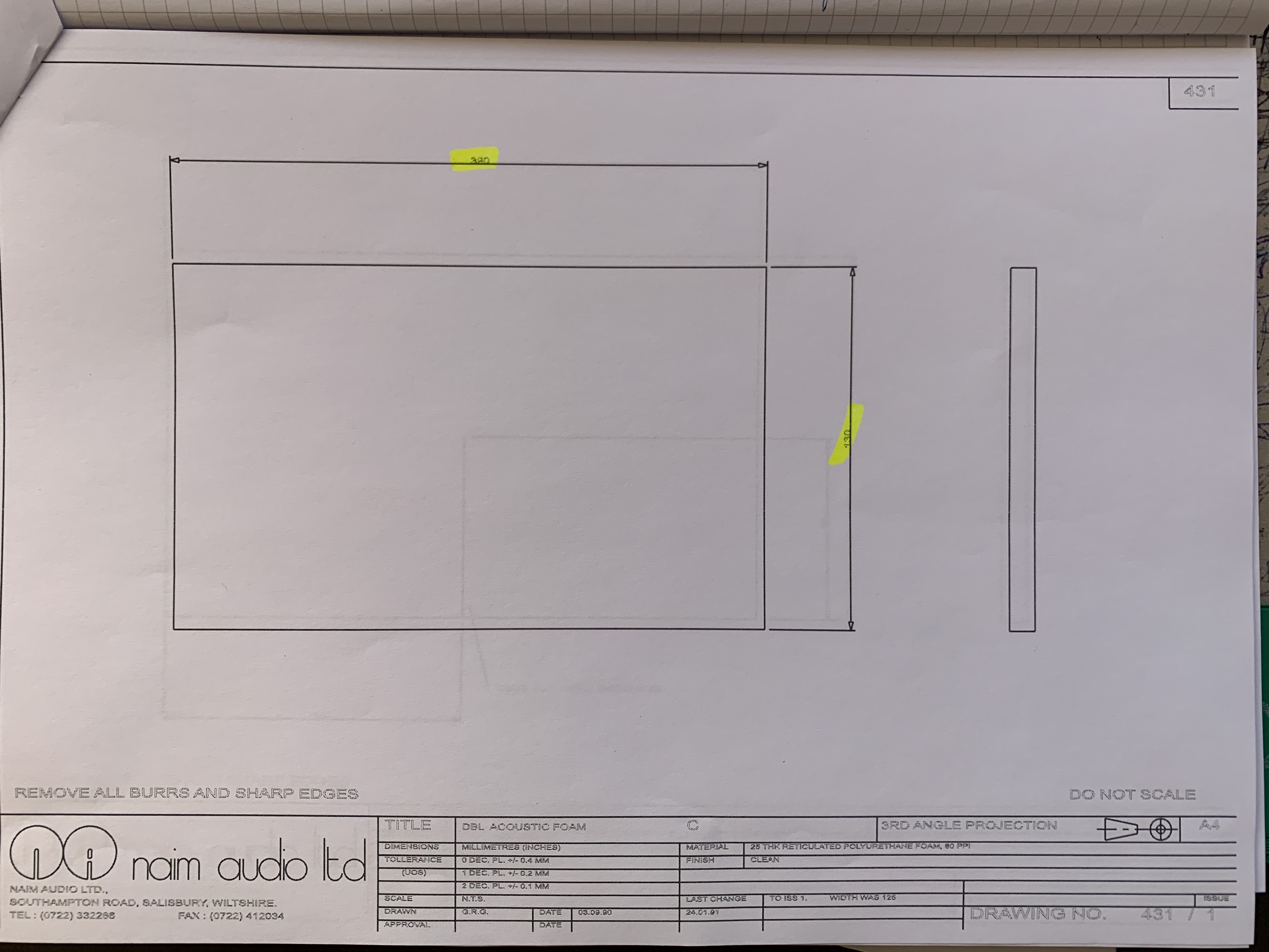

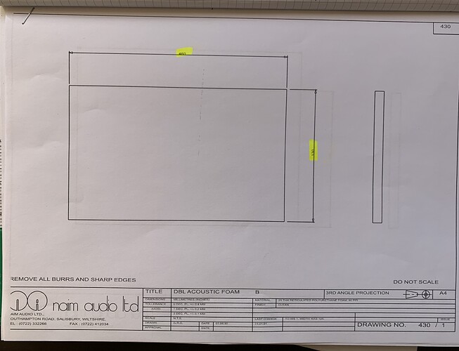

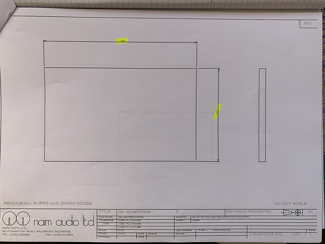

I am looking to refurbish my DBL`s. But like you, I would like to know how the Foam is arranged inside before I strip them down. I got some plans from Naim but I am sure they are not all there. They sent me Sheets 429, 2 of 431 and 432. Can you tell me what they sent you. There is no indication of what goes where. It would be very helpful if you are able to advise.
Hi DBL,
I have those plans as well but quite frankly they didn’t help me when I had to arrange the foam within the cabinet.
The foam needs to be cut a bit wider than the space between the internal wood dividers so that they fit nice and snug, and that snugness keeps them firmly in position. Therefore, you will have several foam strips (don’t remember the exact number) within the cabinet, in between the wood dividers. Rather easy activity.
Hope that helps
Stefano
Hi Stefano,
Thank you for your reply.
Did Naim only send you the same ones that they sent to me, it just seemed odd that there was no 430 sheet and just does not seem enough for all Cabinets.

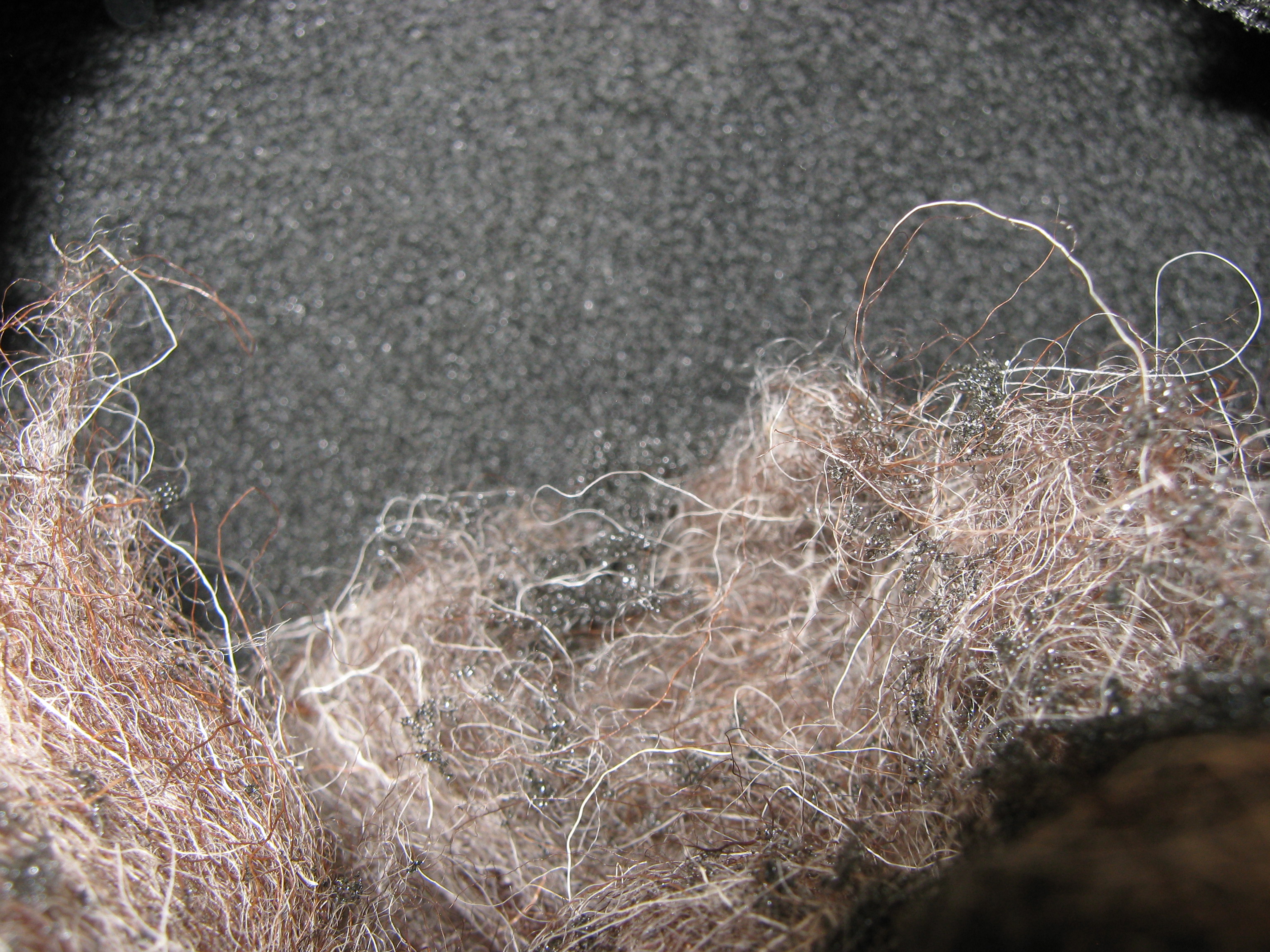

Have you replaced the Foam in all Cabinets? My third Cabinet with the Horsehair type stuff in it, the Foam has just turned to dust.
Actually, I do have the n. 430 diagram. Send me an email at “first name initial”+surname (all attached) at Gmail and I’ll send it over.

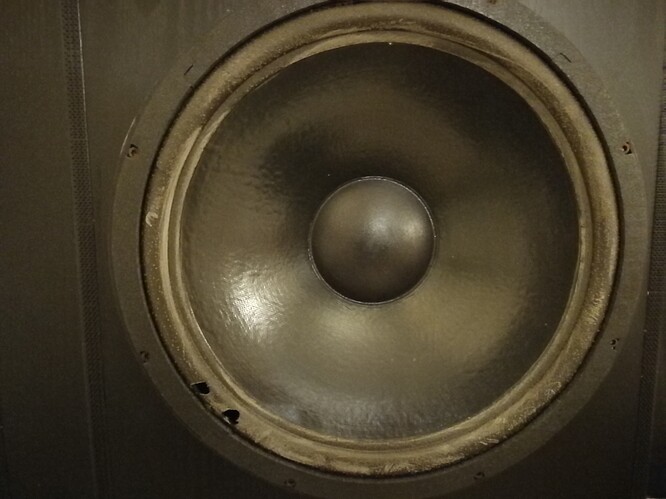

My dBL speakers are from 2004. I always thought that the bass drivers would be ok still. Well, as I realized today the limb of the bass drivers are very week and on the brink of desintegration. So I was right to plan ahead to get the drivers sent to ATC for a refurbishing/reconing. The foaming inside the bass cabinets turned out to be crumbing as well in need for a replacement. I have not removed the foaming yet but probably will do so during the coming week and take a measurement as I am not convinced they match with what’s written on the factory sheets …:roll_eyes:

Have you checked the foam under the Horse hair type stuff in the 3rd and larger cabinet. Mine has just fallen apart. I will be interested to know how you get on.
Hi DBL

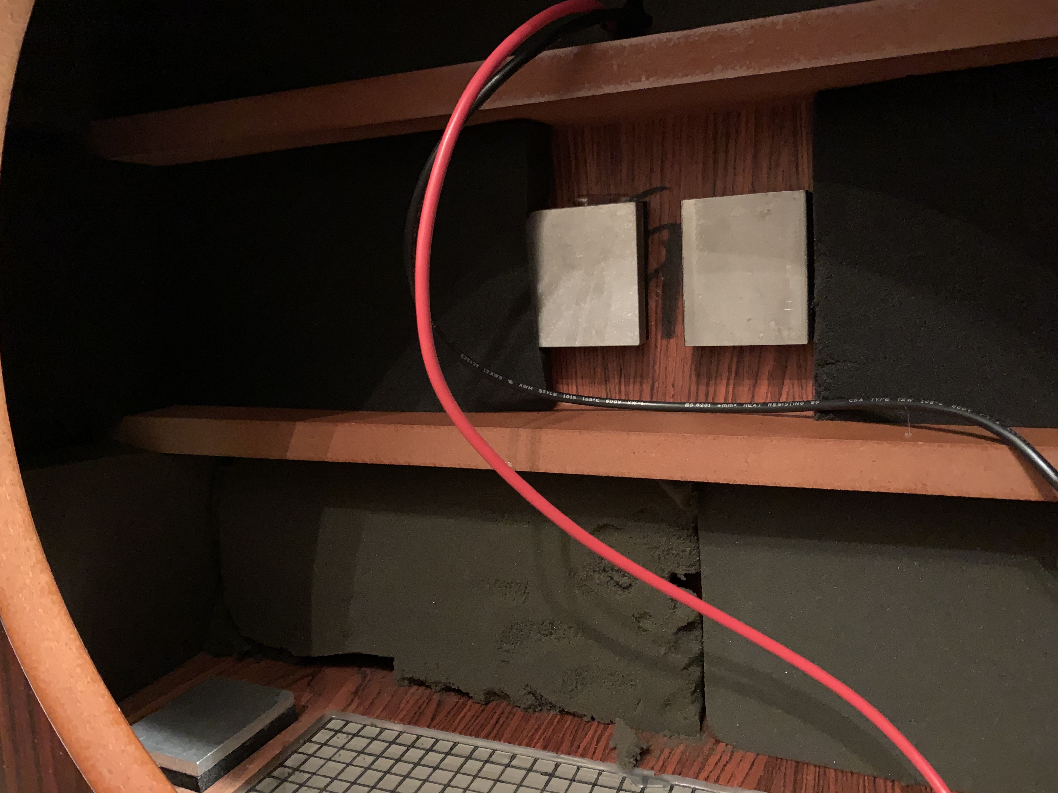

Here are some pics of the foaming snide the bass drivers.
The foaming is in really bad shape and barely tolerate to be taken out for a life size measurement. They crumble or break just by gently touching. I have to compare my measures with the sheets I got from naim ..

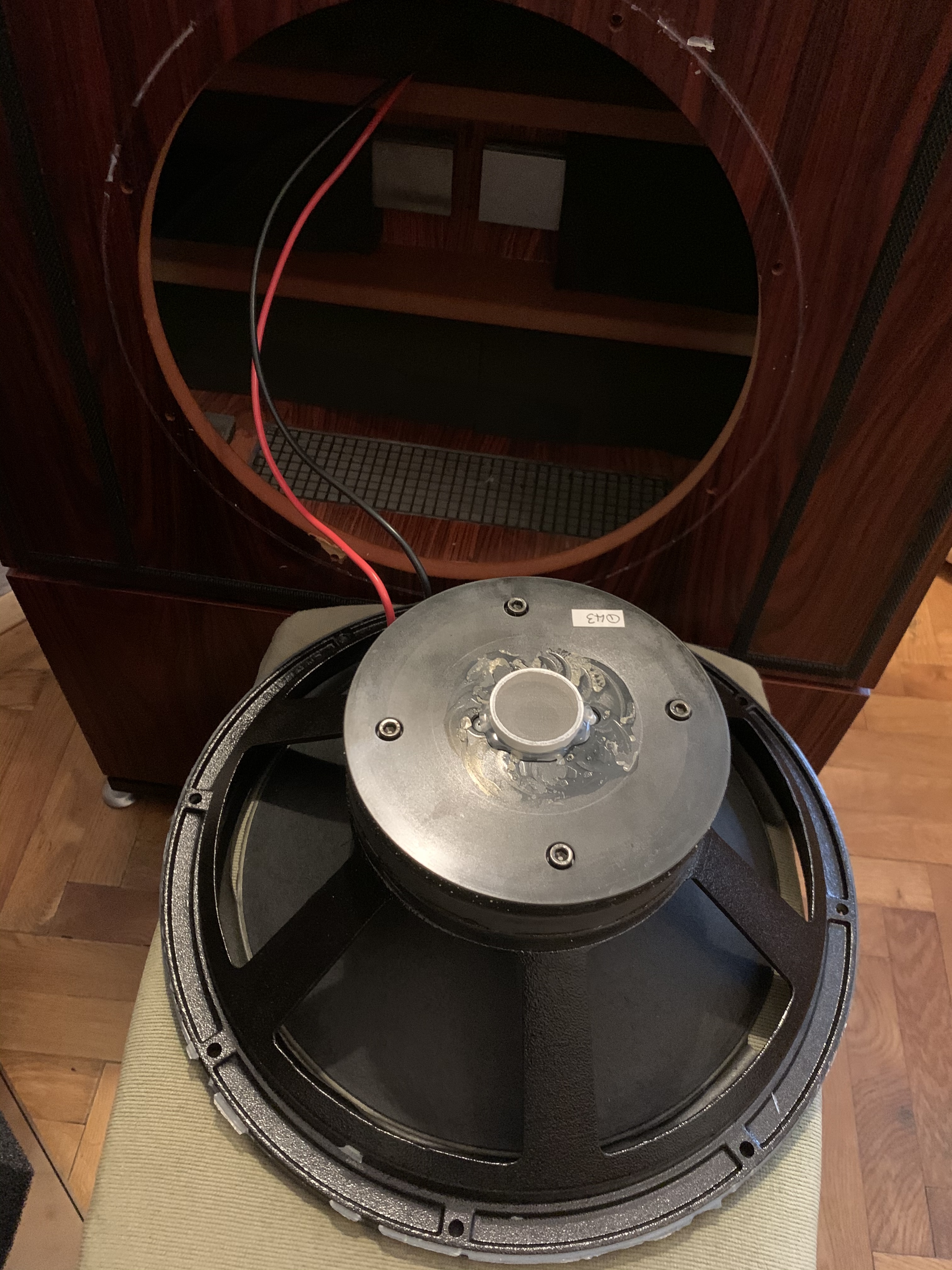

When you take off the bass drivers be careful when you loosen the screws. Leave at least two - one upper and one lower one in while you slice the silicone rim , so they don’t fall out. Best to do it with a second person to give a helping hand. You need to undo the soldering of the cables next.
As sayed before my dbls are from 2004 , so a relatively young pair and they are in high need for refurbishing ..:winking_face_with_tongue:

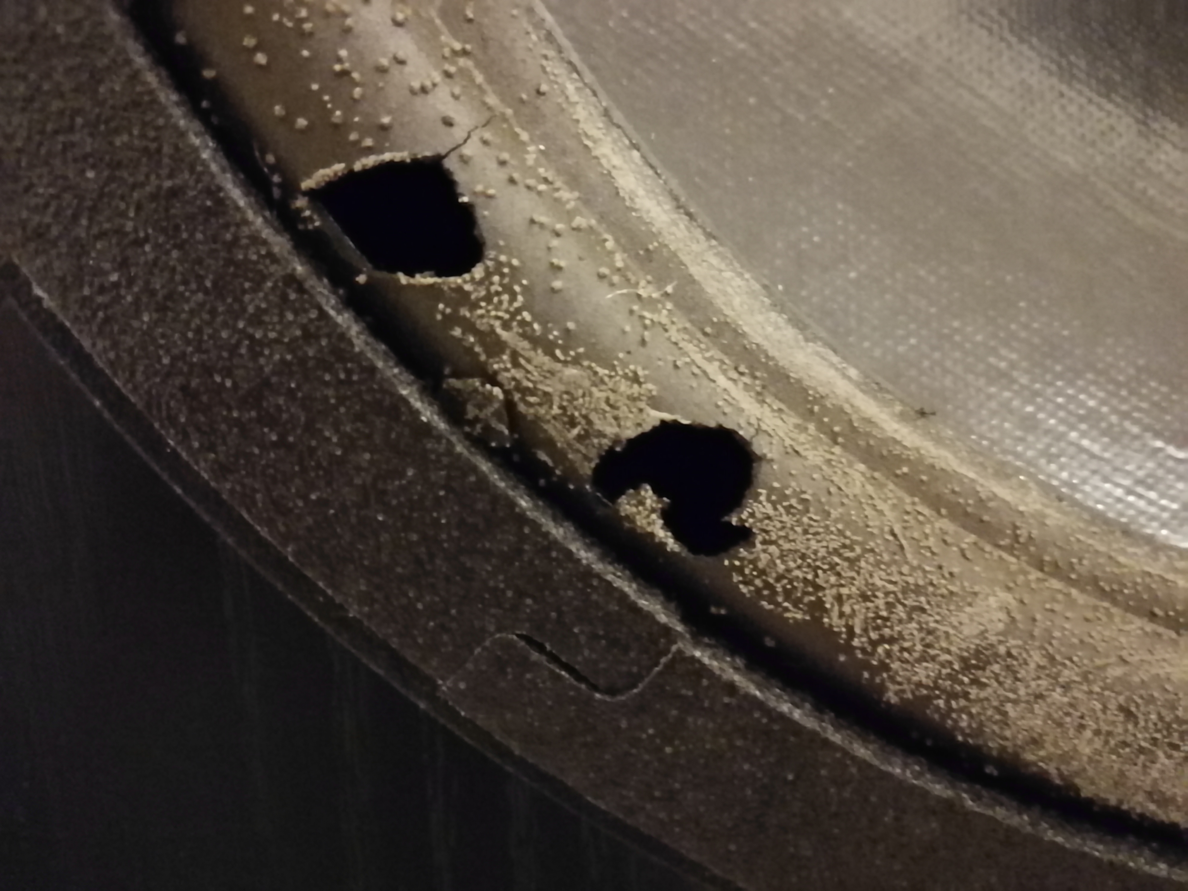

Also you can see here the rim of the drivers just fell apart while removing the drivers from the cabinet ..

Is the foam on all of the sides and is it glued in or just a tight fit. I can see that the Drawings don`t seem to match what is there.

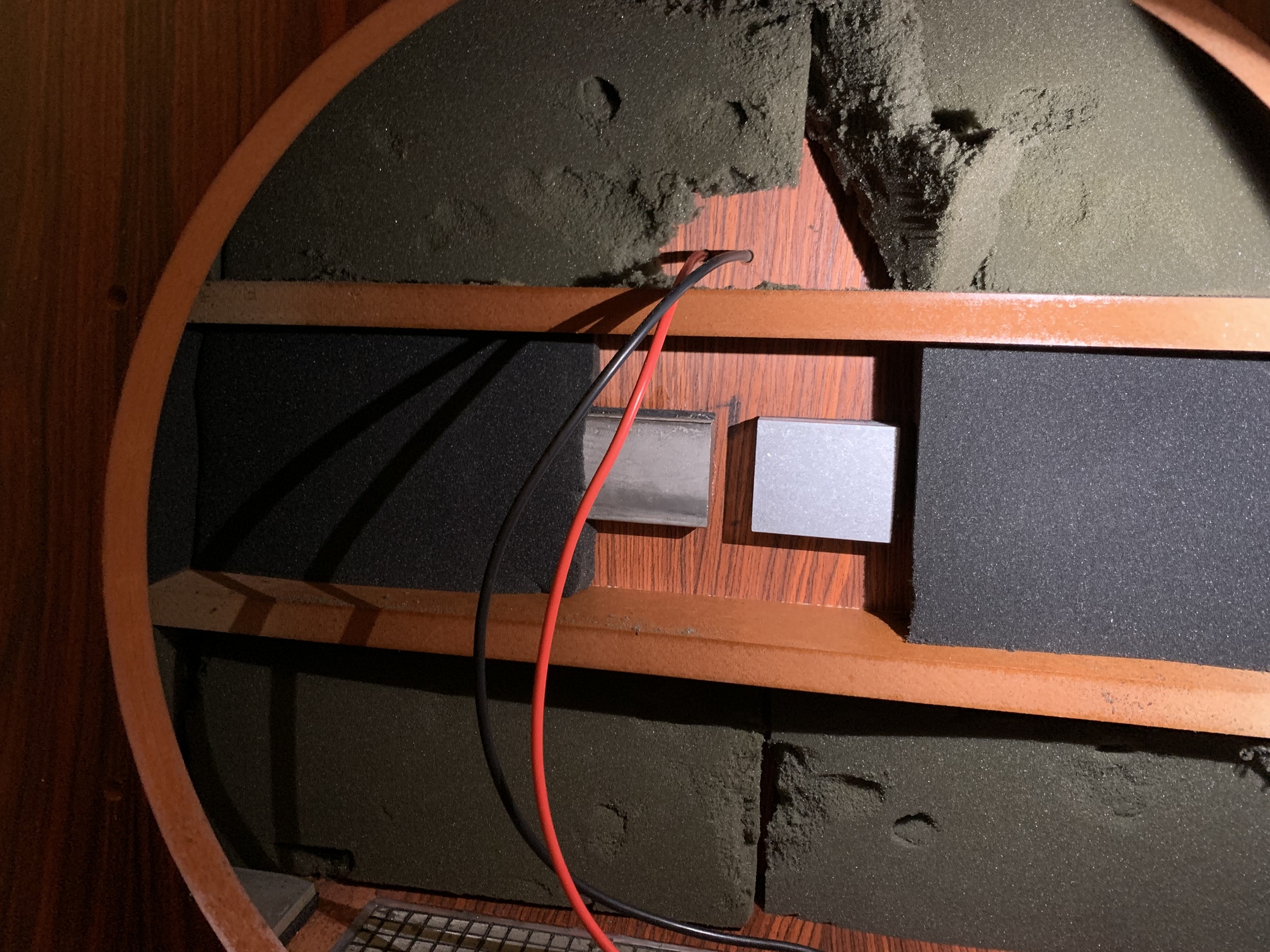

You can see from my pictures the holes in the Driver and the state of the foam in the main box.
Good morning
The foam is not glued just a tight fit. There seem to be two different types of foam the more greenish one bottom and top just brakes to dust while the one in the middle grey is in better shape.
The measurement of these match the specs from the sheet I got from naim sheet 430 and 431. it does not nention however two different specs just 25 thk reticulated Polyurethane foam 80ppi…
