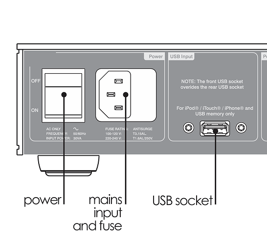

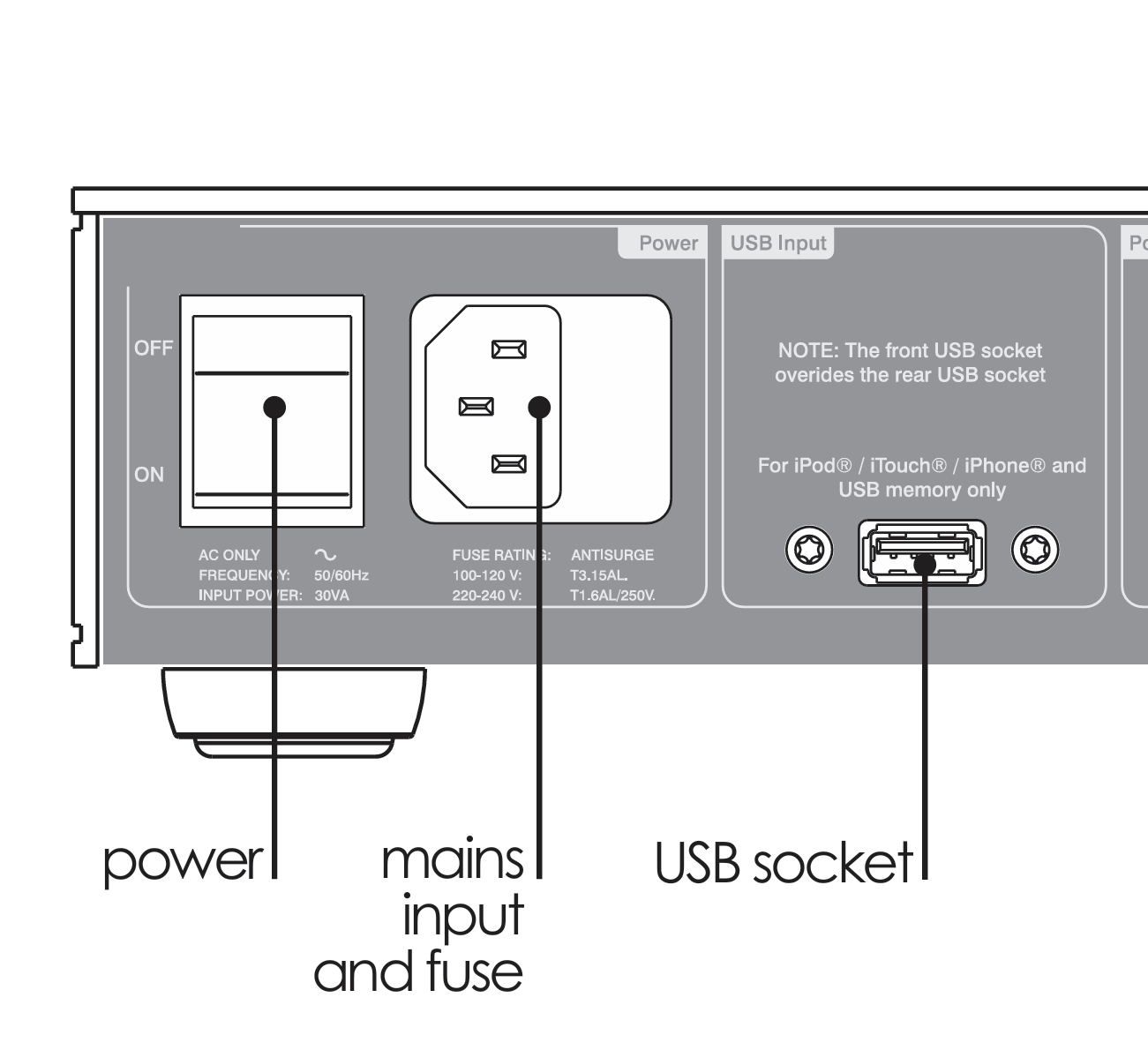

there is a fuse on the AC input socket to the nDAC, probably worth checking that, they are usually glass case so you can see the fuse wire if you don’t have a multi-meter or similar means of checking the fuse
there is often a spare fuse in the fuse carrier that can be swapped in if present
Thanks - but I’m sure that’s ok as the Naim logo on the front panel is illuminated. That goes off after a few seconds if I switch the mains power off at the back.
yep, that does sound as if that fuse is ok then.
