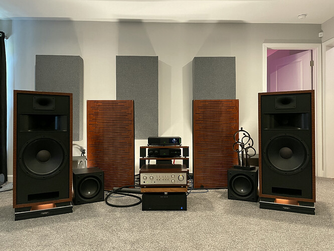

Due to OCD I would be taking off speaker/sub ornaments and realigning the back wall treatment panels so it was perfectly in proportion and not offset like you have it on the back wall - just to rule out that possibility.
Probably worth blocking that doorway too. You will need to let the plaster dry out before painting it of course. Do let us know how you get on.

Thanks - unfortunately since that door goes into my office, I had to align the front wall bass traps (actually the rear wall for my home theater which is on the opposite side of this room) between the door and the curtain on the left of this picture.
If I aligned the system itself with the wall panels the system would be off-center in the room which is an acoustically poor choice.
So unfortunately it’s one of those aesthetic things I have to live with. I do have much more panels arriving in the next month that will better mask the front wall panels (diffusion panels of varying width and height that will go in front of that wall).
Also although there is some sculpture type stuff on the subwoofers none of the subwoofers have been connected for the duration of this experiment. Normally that sculpture would sit on top of the NDX2 where it does no harm.
