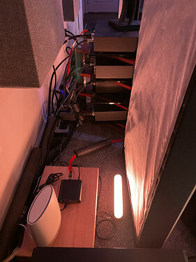

Here is a pic of the final cable management from behind the system… I feel confident that the system is squeaky clean at this point so it is either the amp/speaker or a rapid and catastrophic hearing anomaly, which doesn’t seem likely.
