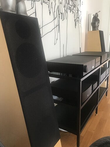

Made my own ”rack” from IKEA VITTSJO but substituted all the shelves for custom ordered toughened smoked glass. Then i put the glass on sourced hard sorbothane (I guess it is) apparatus feet that was accomodated directly on to existing holders on the metallic frame of VITTSJO for decoupling (could actually tried metal balls too since theres a screwhole in the holders)
Cheap as anything. Imho a Huge increase in SQ, much airier, faster and clearer sound then my old piece or any I’ve used with fixed shelving
Looks really good, thanks for the detail on your changes to it.

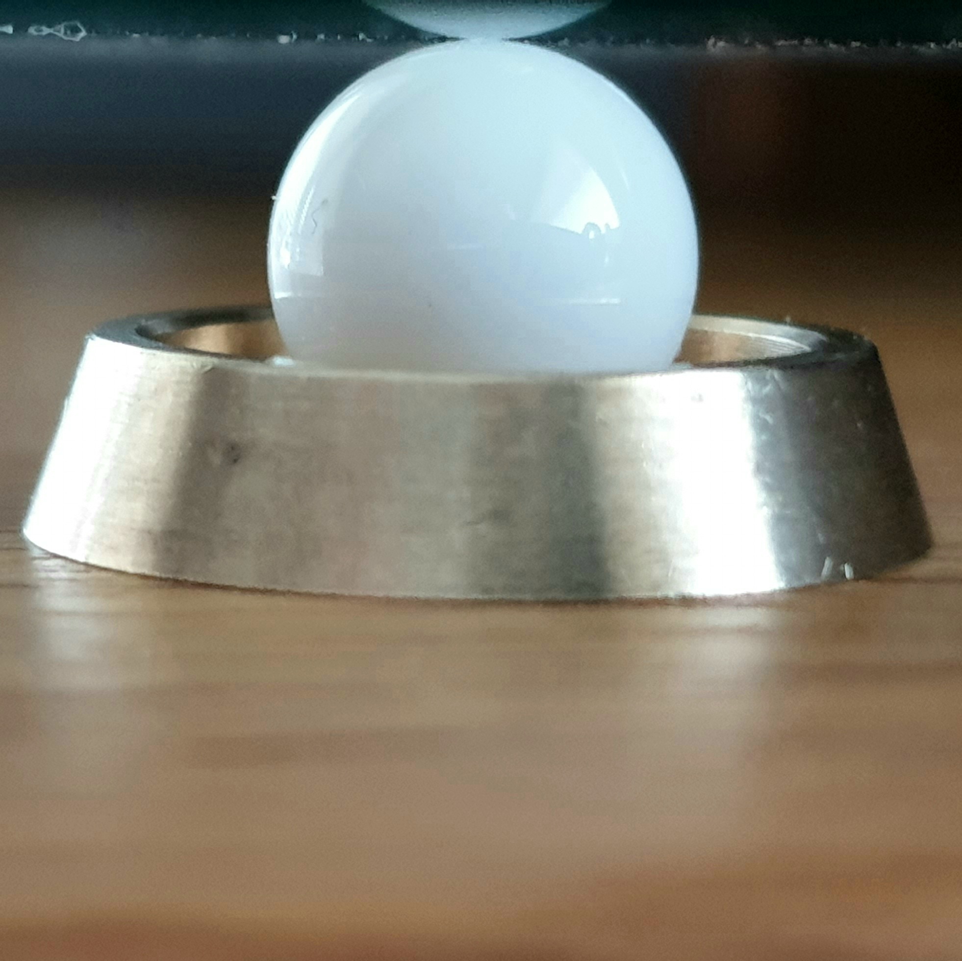

I too use a 10 toughened glass to support my gear on. Trying to isolate it from a wooden structure below.
Currently between the two I have a rubber tap washer and a hardened chromed steel ball of 12mm dia.
The washer was to absorb noise and to support and locate the ball. The ball was thinking of vide minimal contact with the glass.
But, this may not be the best strategy.
The other thread suggests reflecting the noise back down. So, it uses a copper or brass support and a ceramic ball. The difference being the brass is being used to locate and reflect noise. So, going to try that.

Ceramic balls arrived today. Just waiting for the copper) brass bits.

A well known in line auction site. 12mm ceramic balls.

My version of someone else’s design. Brass bottom bits with 12mm ceramic balls.

I’d expect them to sound better - other things being equal - as the sphere is harder than steel and because it only touches the surface below at one point in the work hardened brass.
[12mm, you went big.
Xanthe suggested in that isolation thread that smaller spheres are probably better as they make a much smaller contact area with the glass and brass.]

I centre punched the brass thing. Bit difficult as these are turned and still have the centre “pip”, so the punch was slightly offset. Not that it matters.
I then used a counter sink to create the V to locate the ball.
I used a steel ball in the countersunk hole and hit it with a steel hammer,
A quick cleaner with some brasso and installed.
Soundwise under the TT. I’d say it has lost a little bit of bass? But it has brought with it additional clarity and focus in the other bits. Certainly not going to take them off!
I’ll get a picture of the counter suck bit post whack when I have made up set 2.
The 12mm was because the steel ones were 12mm. Nothing else. Bugger, 6mm are quite a lot cheaper!
