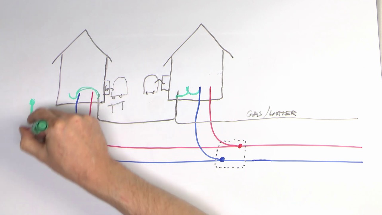

We’re busy with a big extension which is heading into the final stages. I’m taking advantage of this to get a dedicated circuit put in for my 500 series kit.
Having shared this diagram (an old forum favourite!) with my builders, they were questioning the need to have a separate consumer unit when we’ll be installing a brand new one for the house, and those that meet current regs are, well, pretty good at isolating different circuits from each other.
Can anyone explain why (and if indeed I should) still need a second, separate consumer unit?
Yes. A separate CU is required. This circuit is then totally separate from the other house wiring and associated noise.

I would side with your Electrician. I cannot see the point of the additional CU…
But… YMMV… :crazy_face:
The sparks who did mine was very much up to speed on doing these. He just nodded at the diagram and I got a new Henly/ CU on the separate cable running from the meter. Given the bother it was fitting things in place, I am sure he would have mentioned it if he thought leaving out the CU would have no impact.
Otoh, he argued that 10mm cable is ideal - as long as any links to other sockets are also in 10mm and the sockets are designed for it. Without those provisos, he reckoned we were better off with 2 runs of 6mm cable. As I understand it, this is far from being a universal view.
You don’t need a seperate consumer unit for that setup, as you say a modern has isolation for each circuit… which is its point.
If you needed to have a separate supply in an outbuilding etc, you would likely consider a separate CU in that building…. and in that case you would likely separate the earths. The above diagram is loosely relying on any resistive drop between CUs to improve noise separation… which is going to be minimal… not least because the earths are joined.
The weak point in terms of noise isolation in circuits is the common neutral / earth. For low noise applications, you might consider a TT setup, which would separate or localise the earths (rather than using the supply Earth ). Here you might decide to use separate earths for different circuits, in this case you would clearly need seperate CUs. If you have a TNC based earth … you are limited in the improvements you can provide until you switch over to TT (though not all locations can use TT… it depends on ground soil impedance at your property)

As already said, you don’t need a separate consumer unit but from both my own and others trials it does sound better than sharing with the main house consumer unit.
Your electrician must have also questioned separate 10mm circuits to run pieces of hifi kit, not needed really but they sure do make the system sound better.
There are also good reasons around having its own earth that goes back to the main earth block. The cost difference is also less than a small cable upgrade, so if you are having work done, it’s a no brainer in my view.
Having tried various dedicated mains circuit arrangements, my experience is that those that use a separate consumer unit work very well, and those that just use a spare way on the main house CU are a waste of time.
This is in line with the advice I received from Naim, who also said that splitting the meter tails to a separate CU was the best way.

A separate unit won’t add much cost so why not just do it. It’s really important to take the earth from the dedicated CU back to the meter, rather than piggybacking off the house unit.
