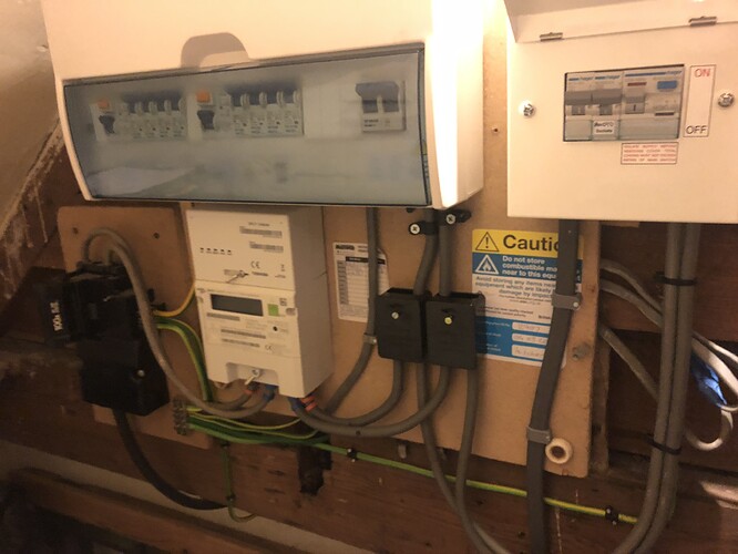

It was £200 about 20 years ago. The cable is 10mm2 steel wall armoured, which was not cheap at the time, running round the house under the flowerbed. The mistake made at the time was to daisy chain the earth for the hifi CU from the main house unit, which was a manly old 80s thing, originally a fuse box. About five years ago we had a new whizzy house consumer unit installed and at the same time I had the hifi earth taken directly to the meter cupboard using super thick cable. This probably made more difference than the original installation, which because of the earth was always, in hindsight, compromised. The better earthing has provided a silent background that can make recordings so much more enjoyable.

Image of the earthing wire below, the smaller consumer unit to the right is the new dedicated one. As an update on price this cost £400 for a pretty long run under the floorboards in the cellar. Thankfully no exterior excavations were needed.

I’m not sure why you have so many earth cables fed back separately to the connector block on the incoming supply, but the main thing is that your hifi earth doesn’t connect via the main consumer unit, so I don’t think you need to worry about it.

Probably for protective bonding on metal pipework coming Into the house.
