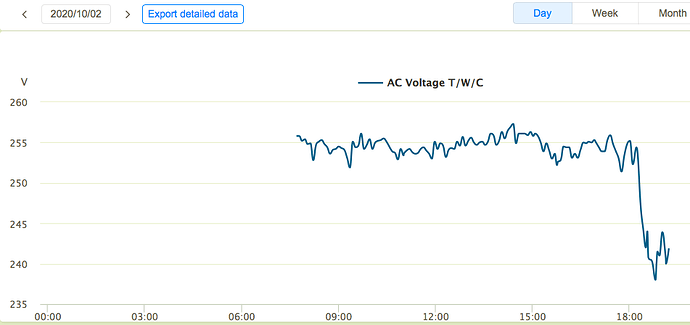

The other easier thing to check for is over voltage. In UK, our supply should not be above 253V (230+10%), and I have found I get an average of 255Volts, so I am currently chasing this with the electricity company. If they refuse to fix it, then a Balanced Power supply can also resolve this, but will be my last resort.

However i would say best to get the source fixed if that’s possible. I called the electricity company a couple of hours ago, and to my surprise, they said they would send someone around within 3 hours. I think the excess above the tolerance can cause damage to equipment, so they are being keen - lets see what happens.

I will create a new thread for this as it somewhat goes away from this thread subject, but just to finish off my mention of calling out the electricity suppliers, I can confirm that sp energy networks came out as promised within 3 hours of my call. A very friendly chap tested the local substation and confirmed that all three phases were dishing out 253 Volts. He then called on another colleague, and over the next 2 hours they moved the tapping on the transformer, and reduced the Voltage to around 245V without any power cuts. Superb service! I would have preferred 230V, but I’m near the beginning of the route from the substation, and they have to ensure 230V at the furthest point.
As for the buzzing, massively reduced to a bearable level ![]()

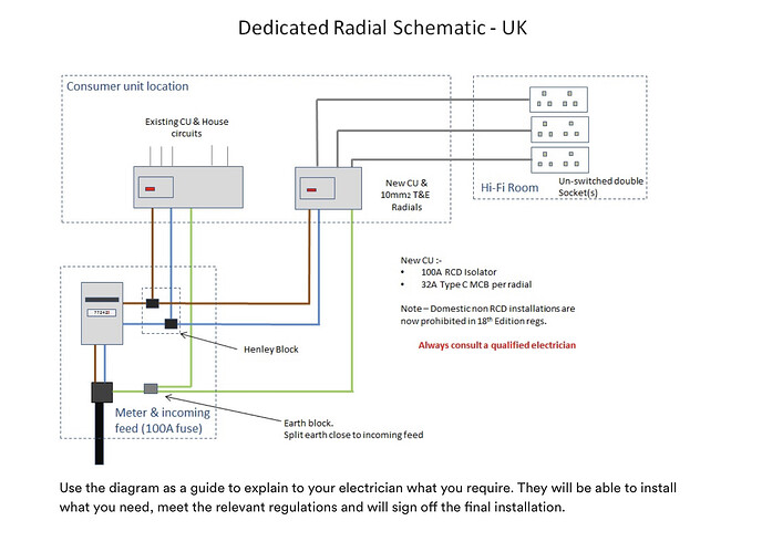

I’m in the UK and waiting for a quote for Radial circuit with new Three way Consumer unit fitted with 32A RCBO type C wired with 6mm2 cable to six in switched double sockets.
Based on the following which has been posted before. I’ll let you know the outcome when done.
Yeah I would like to do this but can only accommodate 1 x 25mm conduit…I think this will only get 1 x 10mm twin and earth or 2 x 6mm twin and earth…
I’m planning to rebuild the electrical system of my home as well and I’m trying to understand what’s best to do.
To quickly recap, as far as I understood being completely ignorant in thie field, this is what it’s needed:
- Isolated 10mm diameter cable for power
- Isolated 10mm diameter cable for dedicated grounding
- Furutech audio grade wall outlet (even thought I wonder how a 10mm diameter cable could work with a wall outlet designed for a 2.8mm or or 5.5 Sq.mm/10AWG max)
But also:
- Avoid switching
- A dedicated grounding rig would be better than a shared ring/spur
- If 10mm diameter cables are an issue, 6mm would be fine all the same
Did I miss anything? Did I get it right? Thanks to anybody who is willing to help.
