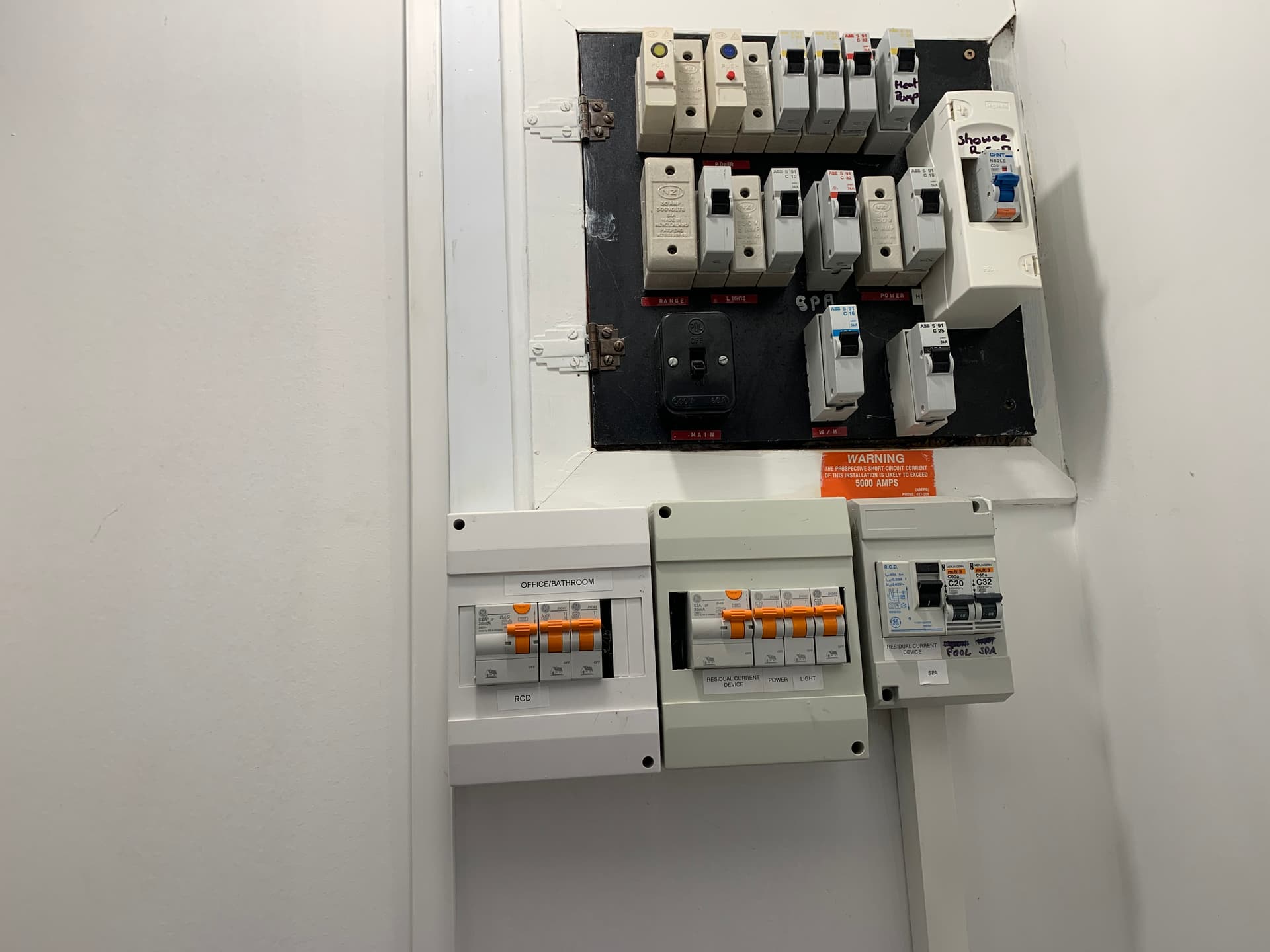

Currently the room has a regular domestic direct feed via a 63A RCD and a C20 circuit breaker (it is the one labeled office / bathroom - the bathroom is a single power point that is not often used and the rest are all the 12 wall sockets in the office on a single spur off the RCD):

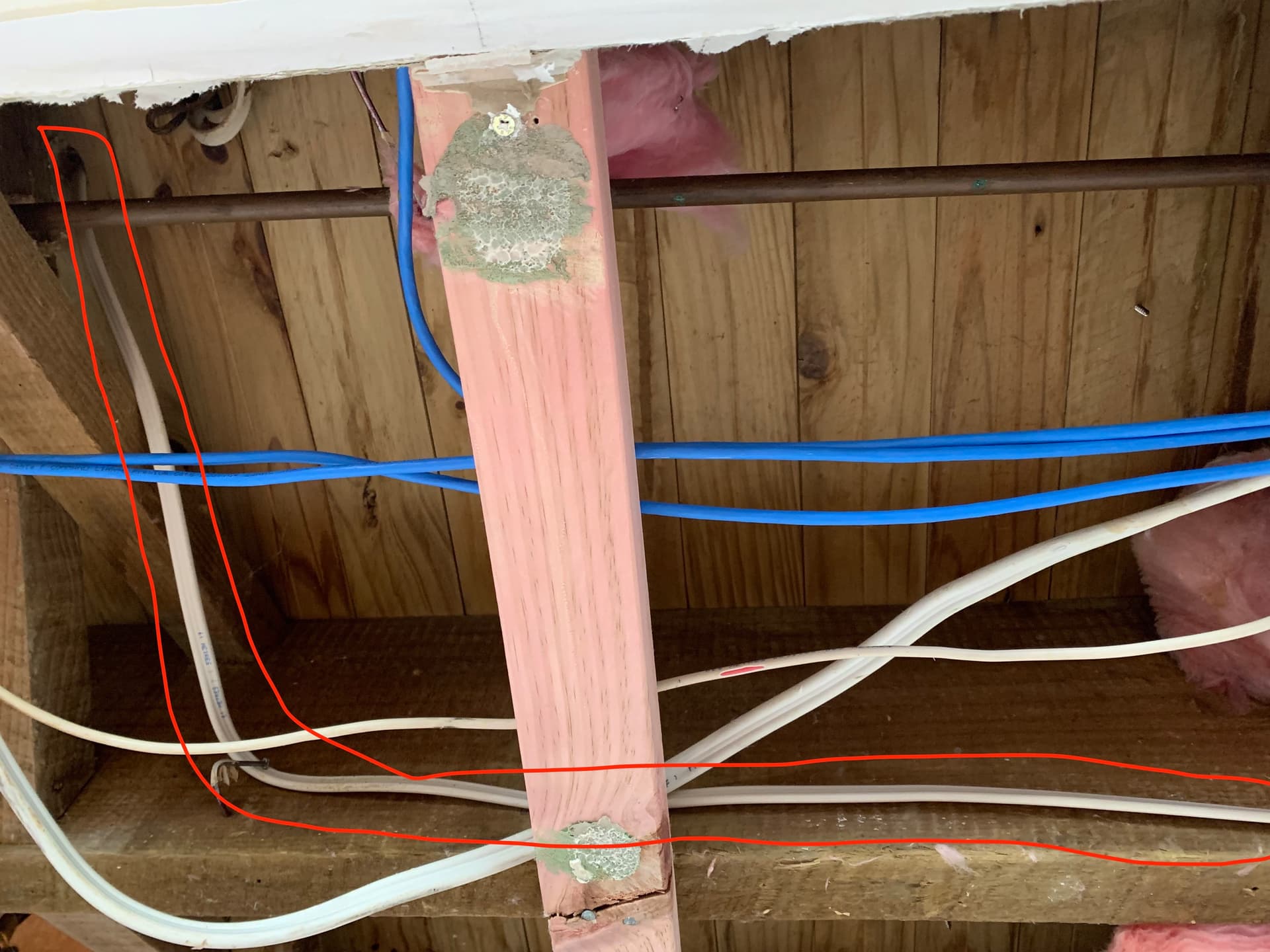

It passes through the floor to the ceiling of the music room (highlighted in red):

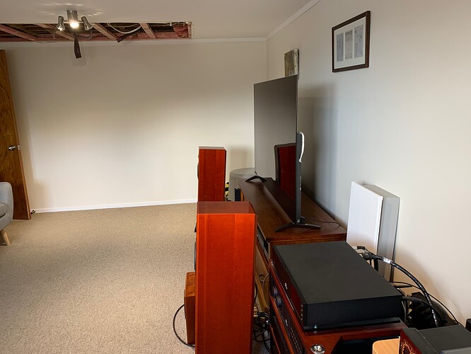

But… it’s at the opposite end of the room to the system!
I might be able to get a direct feed to the corner at the other end of the wall, which could be anywhere between 2 and 4m from my Isotek power-board depending on what route is available. It is a false wall, so there is a gap between the plasterboard and block wall behind.

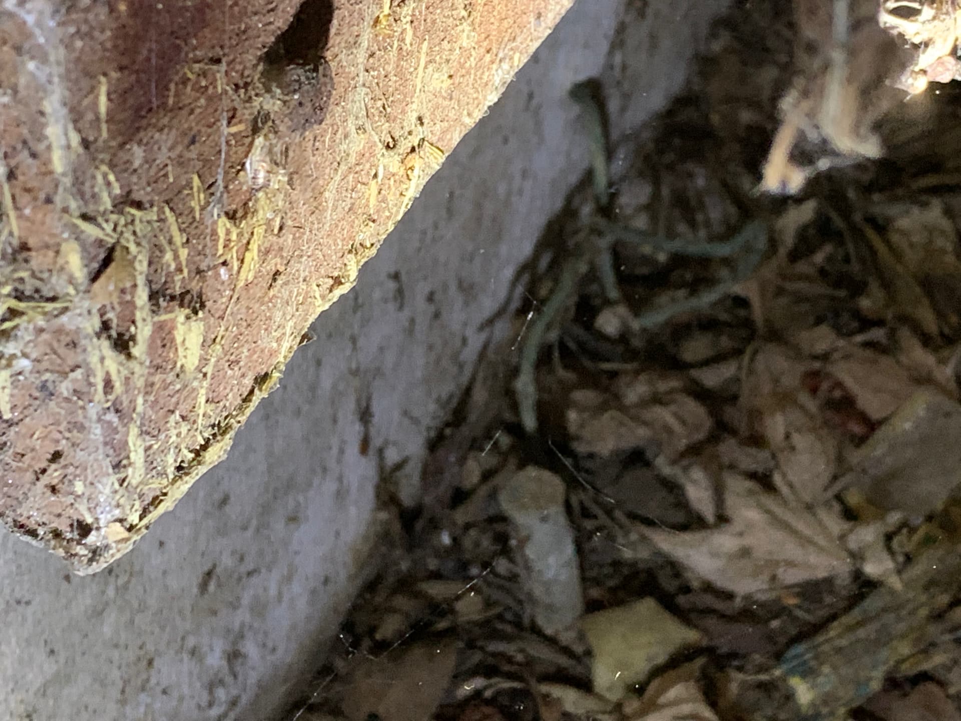

He says to use a 50mm or 20mm earth from the fuse box to the earthing rod if you can replace it. I don’t even know where ours is and I’ve been here over 20 years! It was about everything being incremental improvements and do what you can. For example we have to have RCDs now, which rules out a ceramic fuse even though the later is better. He also said 6mm or even 4mm would be fine for the short run I have, the main point being to have a single run and a single plug using the Tapons back to back to have a direct link into the Naim boxes and have a single earth path.

Well, I found the ground earthing rod under a deck walkway (fortunately I had screwed the deck in for access to the gully trap, so I lifted a few boards). I think I’ll ask the sparky about rewiring this on a different route, as replacing the cable doesn’t look like an option as it passes through the asbestos cladding to behind the wall in the music room. A new route through the ceiling and under the house might be an option.
Thanks Chris. I’ll ask the spark about that. I have a suspicion that it’s not straight forward under the NZ regulations. The specification I have is to have the spur so it’s the first fuse in the buss or connected directly to the Main on off switch - but off course will have to see what that looks like pragmatically we we open top the mains box…
If you can, split the supply from the on/off switch, or any point before it it enters the main board.
Having tried both, I found that taking the dedicated circuit from a spare slot on the main board was more or less a waste of time, and it was only when I moved the connection (and earth) to bypass it completely that the real benefits became apparent.
