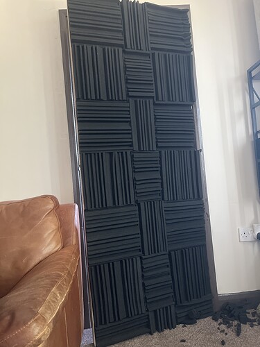

I changed to firing across the room so the sibs could have more room,
I ended up experimenting with underlay on the opposite wall to help subdue the bass a little
Now I have started acoustic dressing
The kitchen door opposite left speaker no longer rattles and sounds better than the righ speaker,
doing other side today

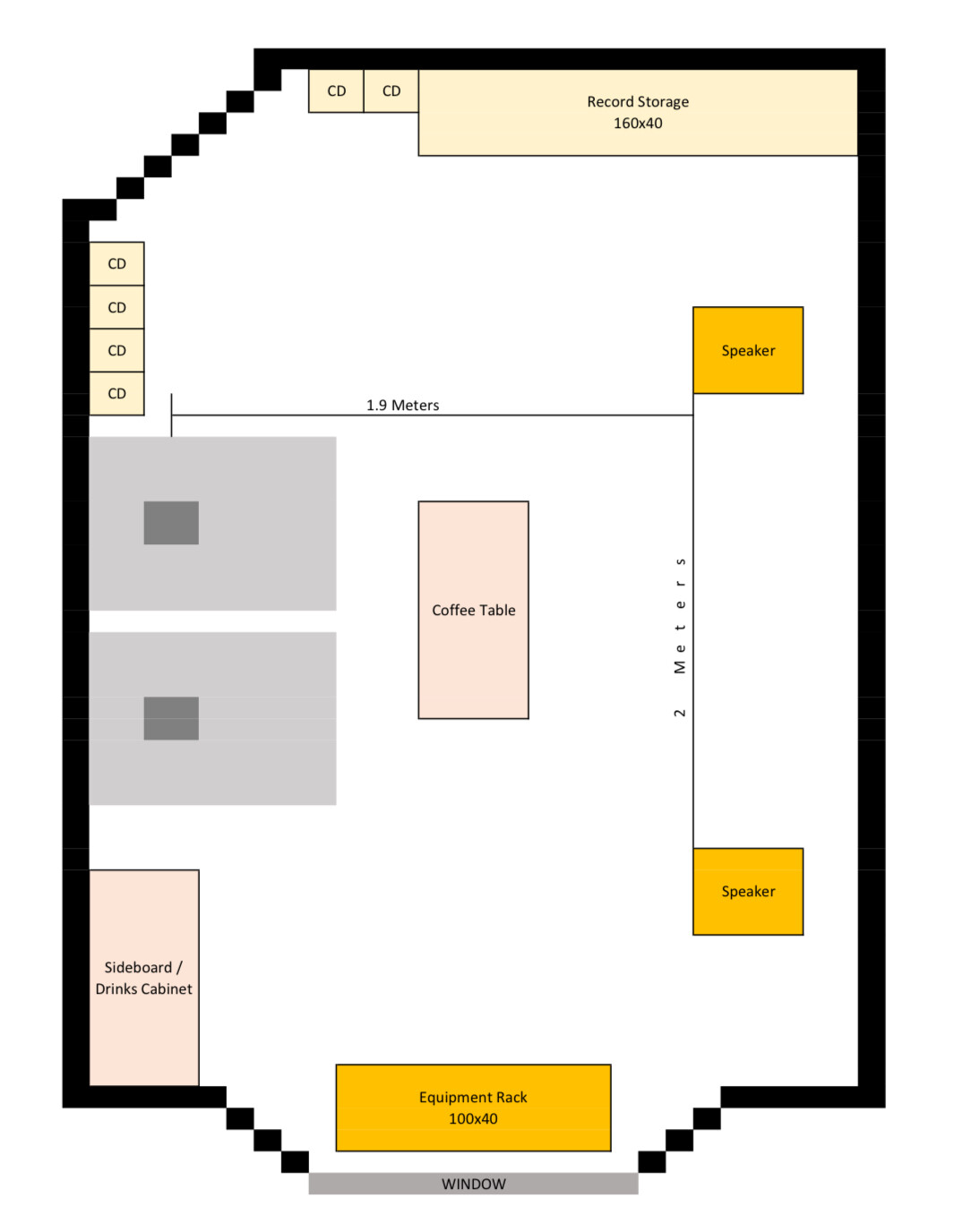

I have done some messing about on Excel to get a better feel for the furniture and equipment and how that fits into the room.
I have done 2 versions, 1 firing each way. The limitations are if I fire down the room I have 1.6 meters between the speakers with only 20cm to each side and behind. I can easily achieve anything from 2 to 2.5 meters from tweeter to ear.
When firing across the room I can get to the recommended 2 meters between the speakers and 70cm to any side boundary. Keeping to 20cm behind the speaker it only gives 1.9meters from tweeter to ear with the chair(s) pushed right to the back wall.
I can get all required furniture in the room so should make a nice cosy room.
Looks good although coffee table could cause some reflections, always a compromise.
Maybe to avoid what if thinking draw up a plan B firing down the room and try both. Some rooms are very fussy and some aren’t, you won’t really know until you try!

Thanks Gary,
Both versions are in my post above. One down and one across.
Coffee table is an optional extra as we don’t currently have one any my wife isn’t keen on them.
Oops missed that detail! Defo try both.
