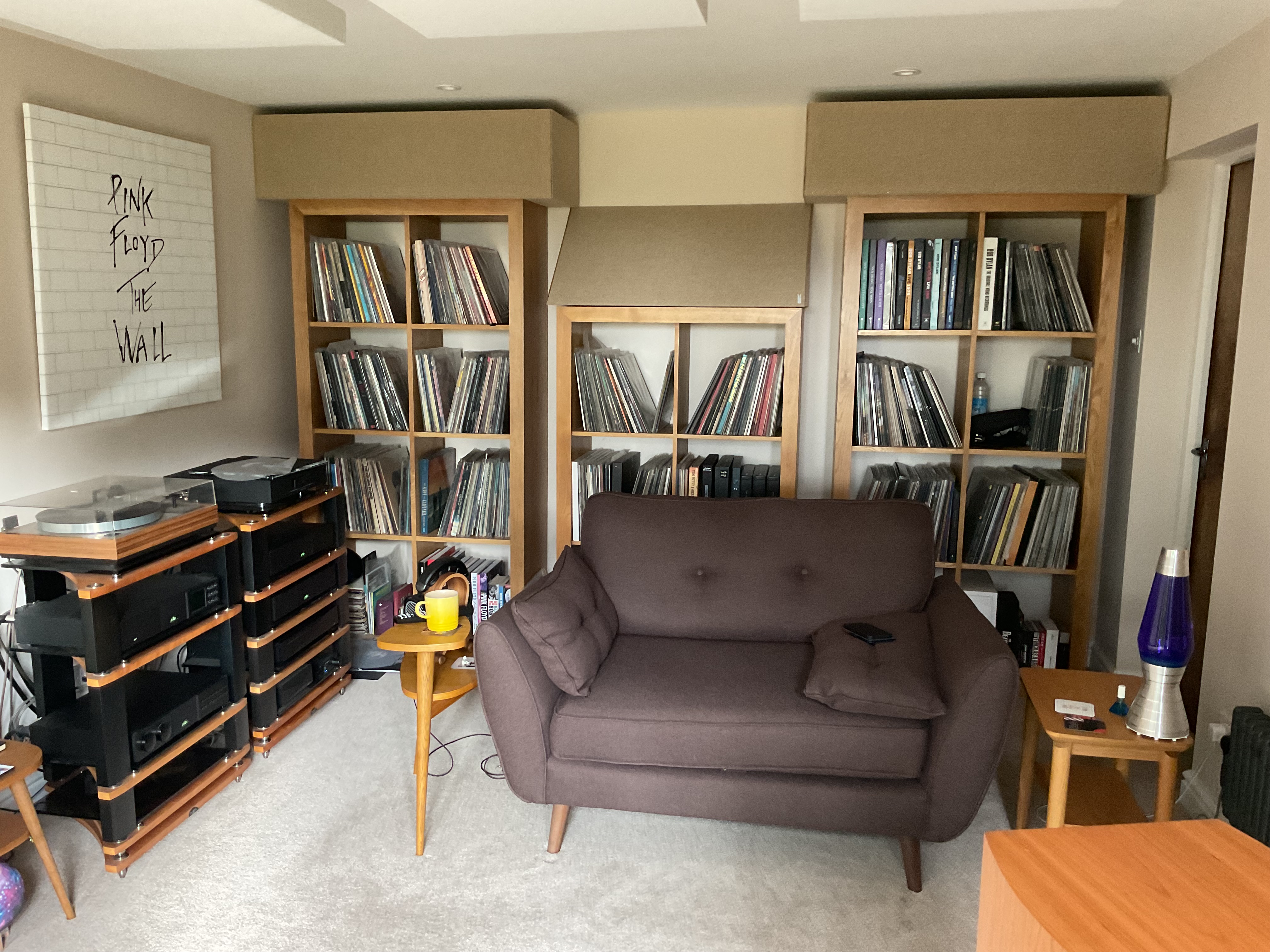

After a house extension and the kids leaving home, what was the ‘play room’ became my dedicated music room of approx. similar dimensions to yours. It’s smaller than I’d have liked but now I don’t get a listening session interrupted by someone wanting to watch the TV. So that’s a good move. Before you move in, and with the house empty why not try to get an electrician to look at fixing up a dedicated mains spur for you? You don’t know what the quality of the wiring will be like in the new place in terms of noise and my spur definitely gave an improvement in sound quality but most importantly stopped the loud clicks and buzzes from the refrigerator and central heating firing up intermittently. I thought that having the speakers fire down the length of the room would be best , but the sound and imaging was awful probably due to the reasons Mike_S cited. The speakers now fire across the shorter width of the room delivering excellent ‘out of the speaker boxes’ imaging. I had the same results in another house, albeit in a much larger room, where firing across the width sounded better than down the (narrower but longer) length. Good luck.

It was a serious consideration to fire across the room as i think the extra width will pay dividends for soundstage and overall emersion in the music. Perhaps i will start there and see how i get on. I think from my planning it will make the room layout easier as firing down a narrow room means that any furniture at the sides gets in the way. My concern was being a little close to the speakers, but i should be able to get just over 2M away without having my head pressed against the back wall. As i need to buy new seating for that room, I can find chairs that aren’t too deep.

Iain, glad that helped. I’ve just measured the distance from the speaker grilles to the seat back of the sofa and assuming that’s roughly where my ears are positioned (!) it’s a distance of about 2.8-2.9 metres. I can confirm the sound stage width and depth is excellent and the closeness makes it a for me a more immersive listening experience. However there’s one minor negative as I perceive it. Occasionally if I play a track noted for its bass and if I happen to leave the music room and go into the adjoining kitchen area, I always think there’s a bit more depth to the bass in the kitchen. I can’t make a measurement of this to justify my perception and I may be deliberately looking for a fault to justify my one worry about the size of the room which is the wavelength of the bass notes requires a bit more width to develop and 3m doesn’t permit this. I trust someone with a better knowledge of physics and the typical length of say, a 100hz bass note will tell me the wavelength is probably less than 1 cm so my ‘theory’ is rubbish. Great news about your father being able to fit the spur. Good luck.
The bass in particular will vary wherever you are in the room, and in some cases it is possible to walk around and have some points where particular notes completely disappear through cancellation, and in other places very excessive. If you are concerned get a copy of REW (free software) and a measuring microphond and measure the response at your chosen or possible listening positions, then you will know if you are hearing as recorded or with some frequencies either reduced or boosted, and then tweak speaker and listening positions to suit - or just play around till you’re happy with what you hear.
