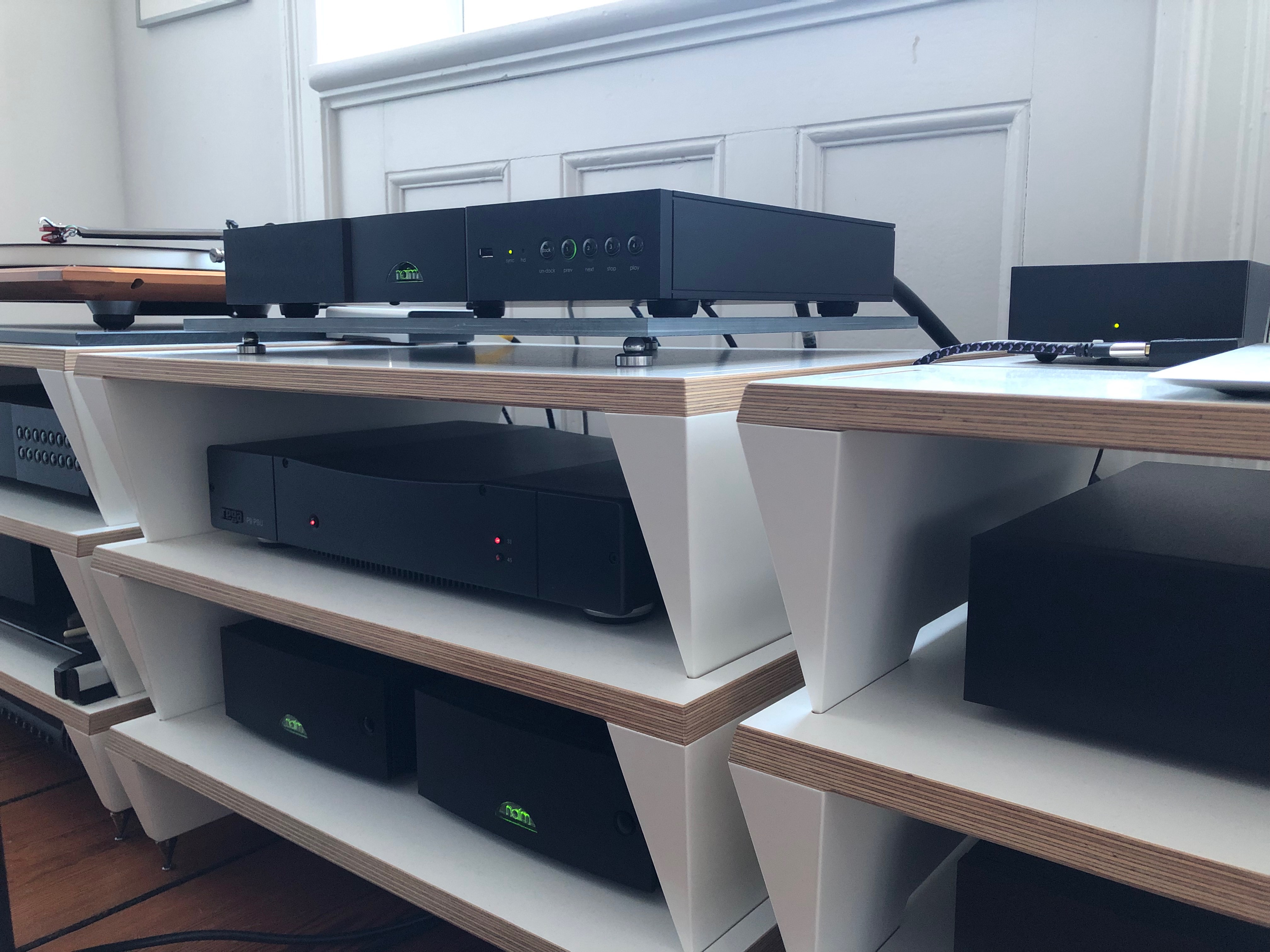

Hey Woody, here’s a couple of pics. I’m ashamed to say there’s no Naim on there yet. I’m planning to change it all to Naim soon, (building the rack was part of that plan).
Yes I took the idea from Hi-fi Racks. This was my first foray into making something from wood and I needed a simple design that I could replicate. Also the workshop was at a friends house, so I was only able to go there 1 morning a week. It took 3 months to finish.
The hardest part was making sure the legs are perfectly straight and the same length, and that the spikes sat in the feet dead centre. My friend who has been making things for years said it was the most technically difficult project he’d done. Don’t be put off though, it was really enjoyable working it out.
