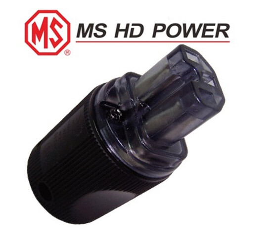

The UK plug and the IEC plug did not look any special, albeit robust, but the cable had a good spec, so looked at other options.
My wall sockets are MS HD Power Silver plated versions, so have decided to get their Silver plated UK plug and IEC plug, some certified cable and to make my own to try out.
Not too expensive in comparison, so worth giving it a punt.
Out of interest, it’s the same UK plug that Chord use on their top end mains cable.
Will report back later.

Yes the MS HD Power 13A plugs are used by The Chord Company, albeit proprietary versions. Their covers are opaque, unlike the commercially available one. Also they use white ones not available commercially. No idea if this impacts in any way on performance. In this case the plating is carried out by the manufacturer so presumably CE certification is obtained on the finished product, ie. post plating.

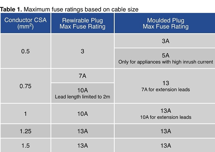

I’ve 2 powerline lites never used in the equipment boxes quite simple because with the moulded IEC end I’ve no way of knowing how really well the termination is made also the conductor size is only 0.75 mm2
Also as Naim strictly address in the equipment manuals that for best sound and less fuse fatigue then a 13A fuse must be used.
This incurs a dilemma of legality and legislation that states that a conductor size of less than 1.25mm2 is unsuitable for such a fuse rating therefore I max out the spec to 1.5mm2 to be in good specification.
All done in the interests of safety and OCD satisfaction of the cable permanently in use.

I use a MS HD mains plug (just the bog standard Copper version) for a 2 way Hydra for my 350s. A decent quality plug, with plenty of room internally and an effective cable clamp to handle large cables, or in my case two cables.
This something I’ve brought up before because I couldn’t understand how Naim could legally supply mains cables with the incorrect fuse rating in the plug. I think the answer was along the lines that it’s legal in mains cable assemblies below a certain length. Complex legislation here. The fact that it’s a ‘cable assembly’ and supplied as such is apparently relevant here. All only as far as I recall.
Regarding the cable CSA of 0.75mm2 I recall it being said many years ago that this was chosen to provide best performance with Naim products and that using a higher guage cable would not be as musical. Of course the Powerline in much heavier guage so I’m not sure what the official line is now. As I said, my recollection is from literally decades ago…so probably way out of date.
