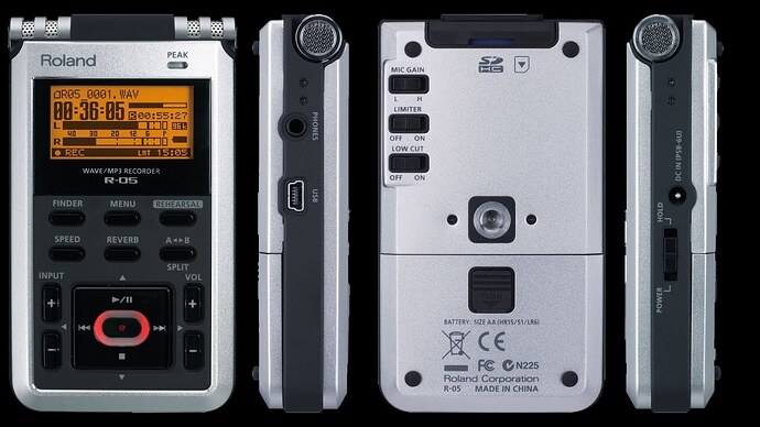

I use a Roland R-05 recorder. (£40 from ebay).
It’s a lot easier than connecting up to a laptop/soundcard. (been there, done that).
As Xanthe suggested the only other thing you’ll need is phono to 3.5mm jack connector.

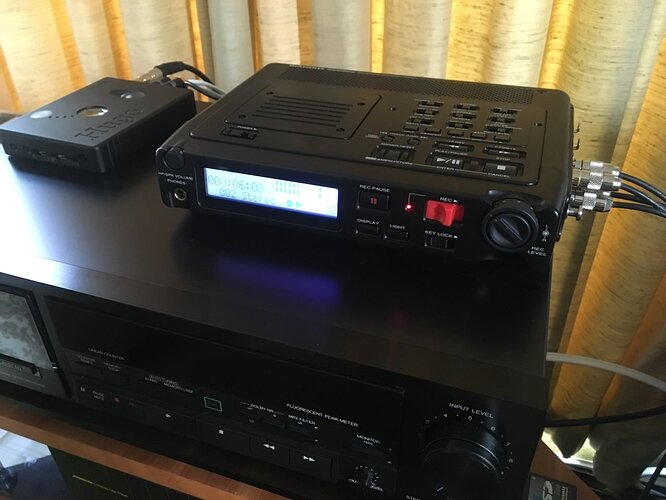

If you want a fantastic bargain digital recorder then you should consider the Marantz PMD671. It’s a proper professional bit of kit that can act just like a digital version of a cassette deck. It has very good sounding circuits a good quality ADC and a pretty good DAC too - although plugging it’s coaxial digital out into a good quality DAC such as the Naim DAC or something like a Chord Hugo does lift its game, making the sound more spacious and dimensional (the internal DAC is still very enjoyable though). It can record at up to 24bit 96kHz and the nice chunky controls, and good meters mean it’s very easy to use. It’s good enough to have an almost permanent place in my big system, acting just like a digital tape deck. I then take the files off the CF card and edit them on the laptop with Audacity and metadata via DBpoweramp. It’s even very friendly when it comes to connections with a pair of RCA phonos for input and a pair of RCA phonos for analogue output so you can use a regular tape interconnect. I love it! Oh, and did I say it was a bargain? My boxed and near mint example with all the bits, I bought online for just under £200. Well used examples that have been used in the field you can pick up for much less.
