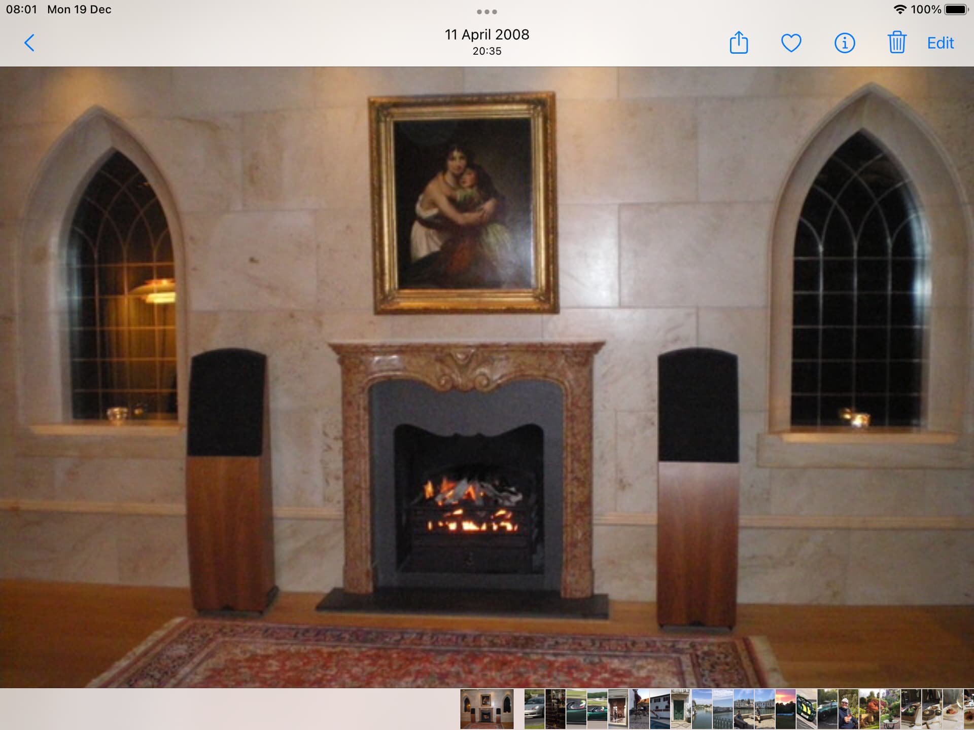

I simply don’t think that SBLs were ever able to reproduce the bottom octave of a church organ with any sense of realism. From memory they started dropping off at 45Hz, so I wouldn’t worry about their condition except for the seal having gone. I had to reseal my pair back in the day 3 times driven active by 52/ 4x135s :partying_face: Enjoy Peter

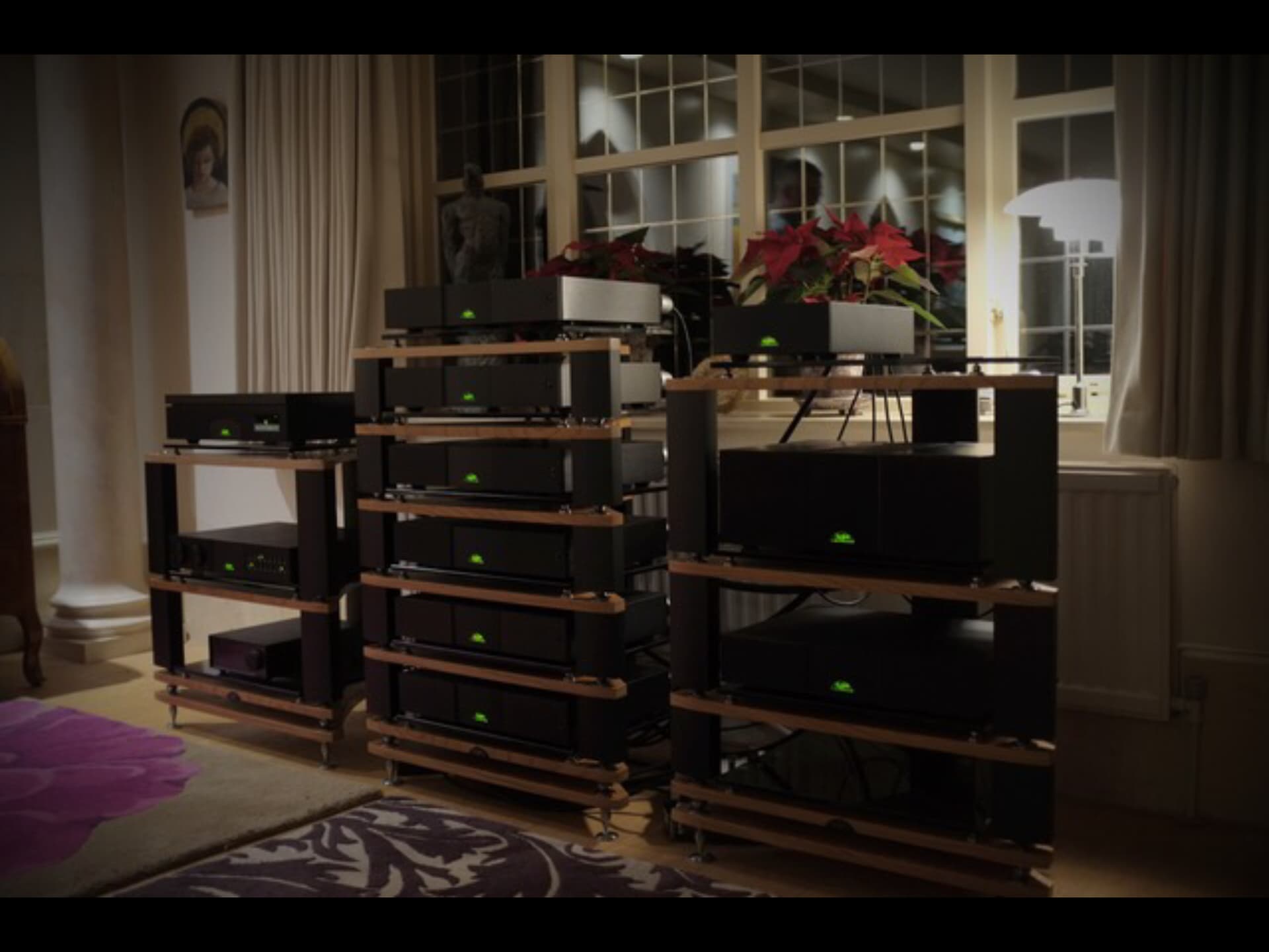

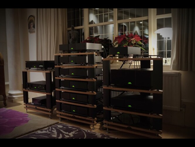

Hi Einstein, will agree with you that the SL2s had more reach and weight for sure:
