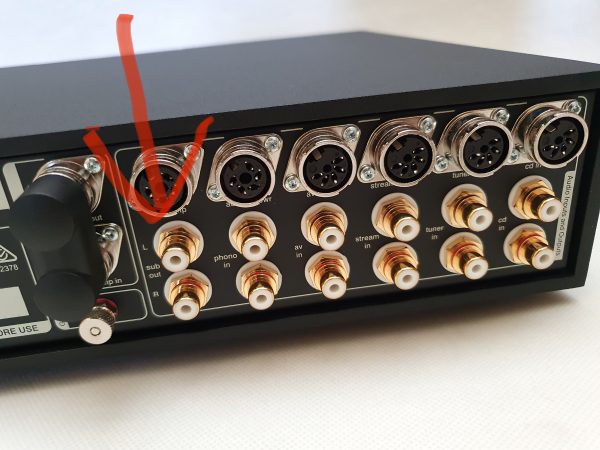

I want to connect a sub through the sub out on my SN3. Does it need two cables / use both L&R channels if I use only one sub? I have an empty pipe in the wall so I can hide the cable to the sub but it only fits one cable.

Will a DIN plug fit through your trunking? If so, get a long DIN to RCA cable made up and connect it to the biamp output. If it’s a long cable you may need to have it ‘slugged’ with a resistor. Naim may still make such a cable, or any competent dealer or cable supplier should be able to make one.

Not with a supernait3. I believe the sub out has been properly terminated so that this is not required
It is if you connect to the sub out, but I was suggesting connection to the biamp out in order to allow the use of a DIN plug which would not be slugged internally so the lead would need the resistor in it if the cable was long.

does no need to ’ slug’ apply to the supernait 2 aswell?
thanks
Sorry. I’m not sure. Maybe @Richard.Dane can answer that.
I think where there’s a dedicated subwoofer output then there’s no need to slug the i/c.
