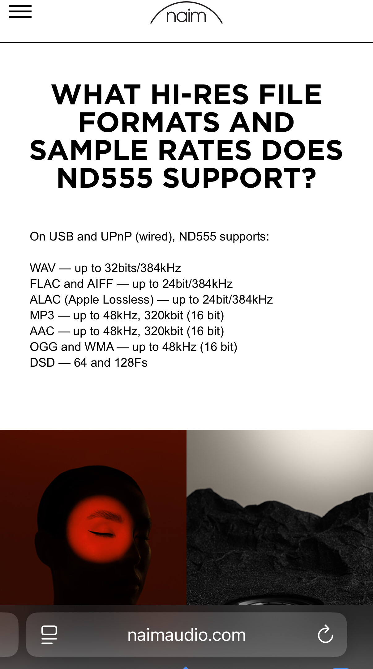

Can I play a DSD 256 file on my ND555 – or do I have to convert it myself to 128 to get it to play?

I believe the streaming board in the nd555 will only do 128 max.
It would need a different streaming board to do higher DSD rates, just the same as the streaming board in mine.
Roon will do it I think. It will downscale from 256 to 128 for Naim endpoint compatibility.
So it doesn’t do 256 then

It will convert it down to 128 DSD max.
It won’t give you anymore than that.
This document is interesting if you want to delve into the ND555 in detail: https://media.focal-naim.com/naim/file_manager_files/pages/legal/white-papers/nd-555-1/nd-555-white-paper-final-0.pdf
In particular this is relevant to this thread “Streaming from a network, ND 555 is compatible
with PCM sampling rates of up to 384kHz and with double-rate DSD (DSD128, sampling rate 5.6448MHz). Because the ND 555’s PCM1704 DAC chips are not DSD compatible, DSD signals are transcoded to PCM within the DSP. First the DSD signal is downsampled to 352.8kHz, 40-bit floating point PCM and low-pass filtered to remove DSD’s noise-shaped ultrasonic quantisation noise. Then it is upsampled to 705.6kHz/24-bit for passing to the
DAC stage.” (from page 4 of the white paper)
