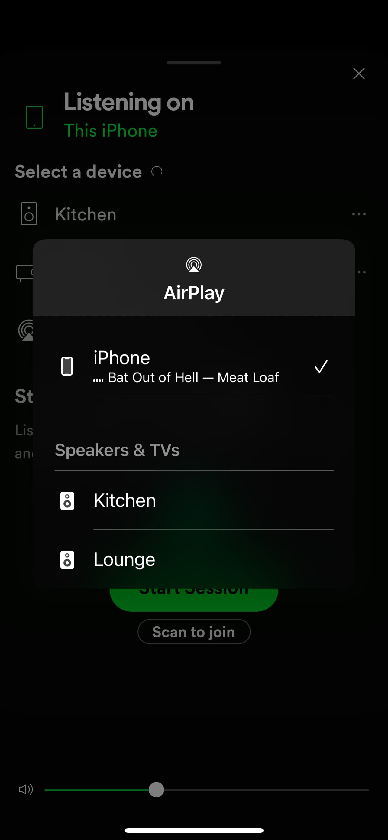

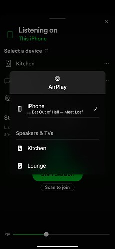

You can do it in reverse. Play on Sonus. Use the AirPlay option. Select relevant Sonus speakers and the Atom.

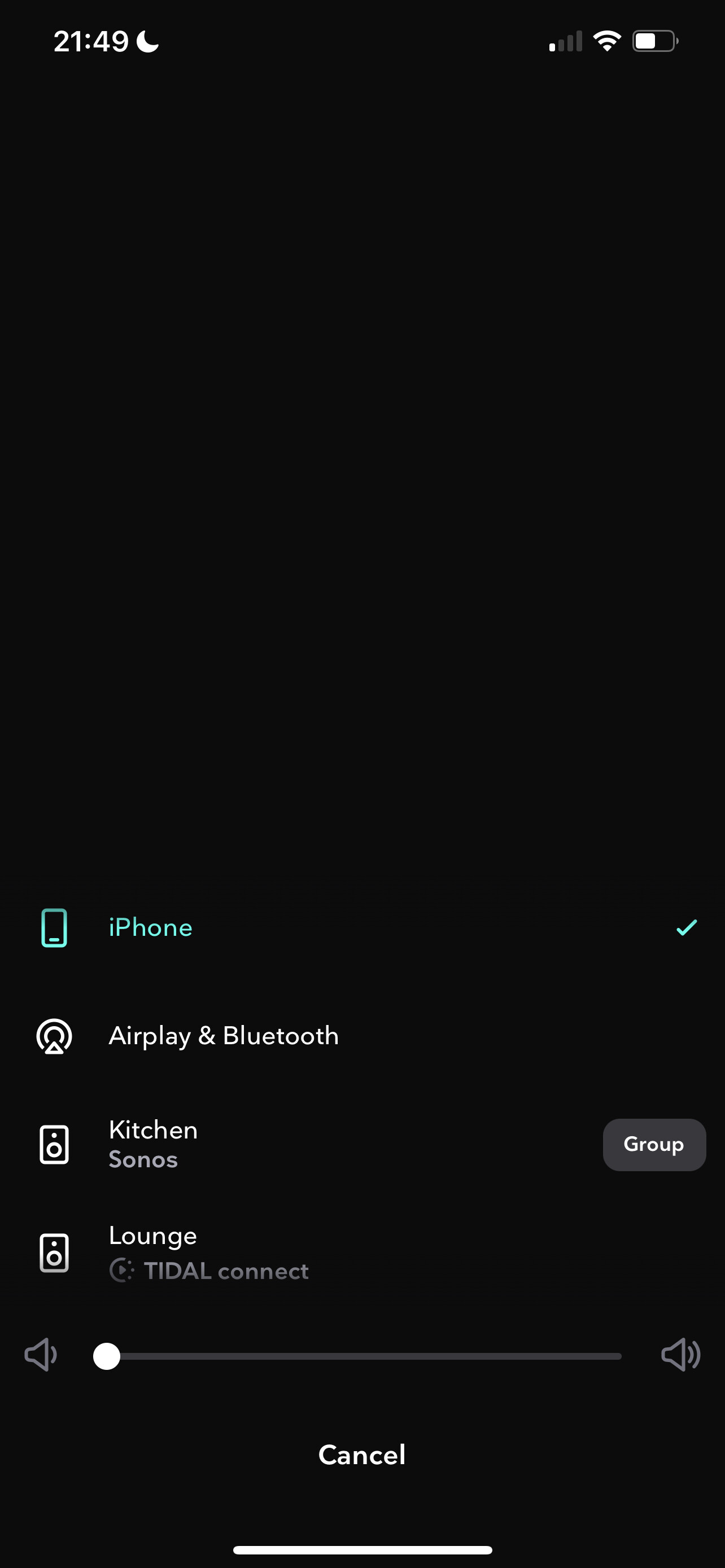

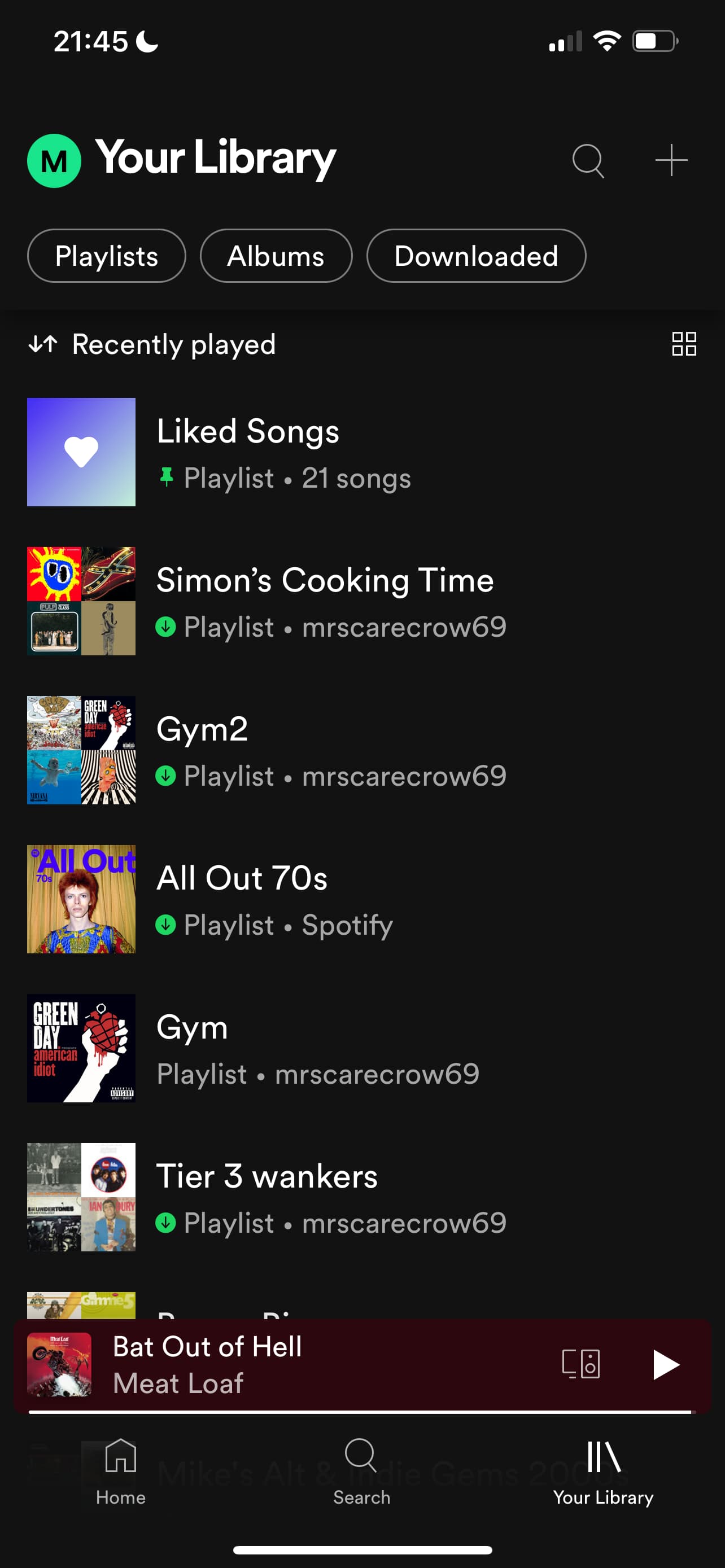

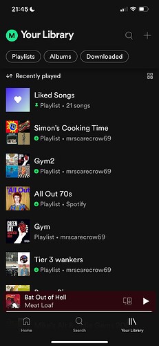

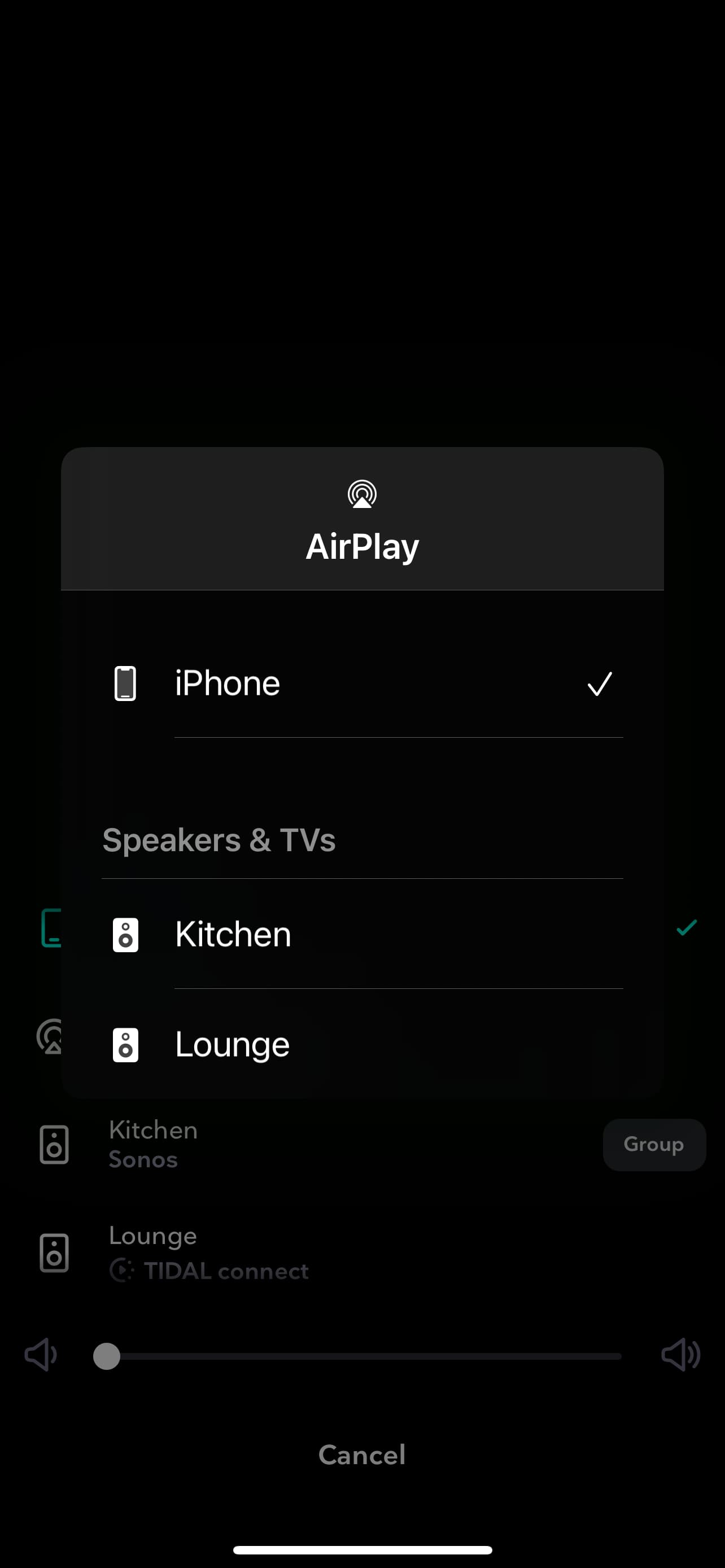

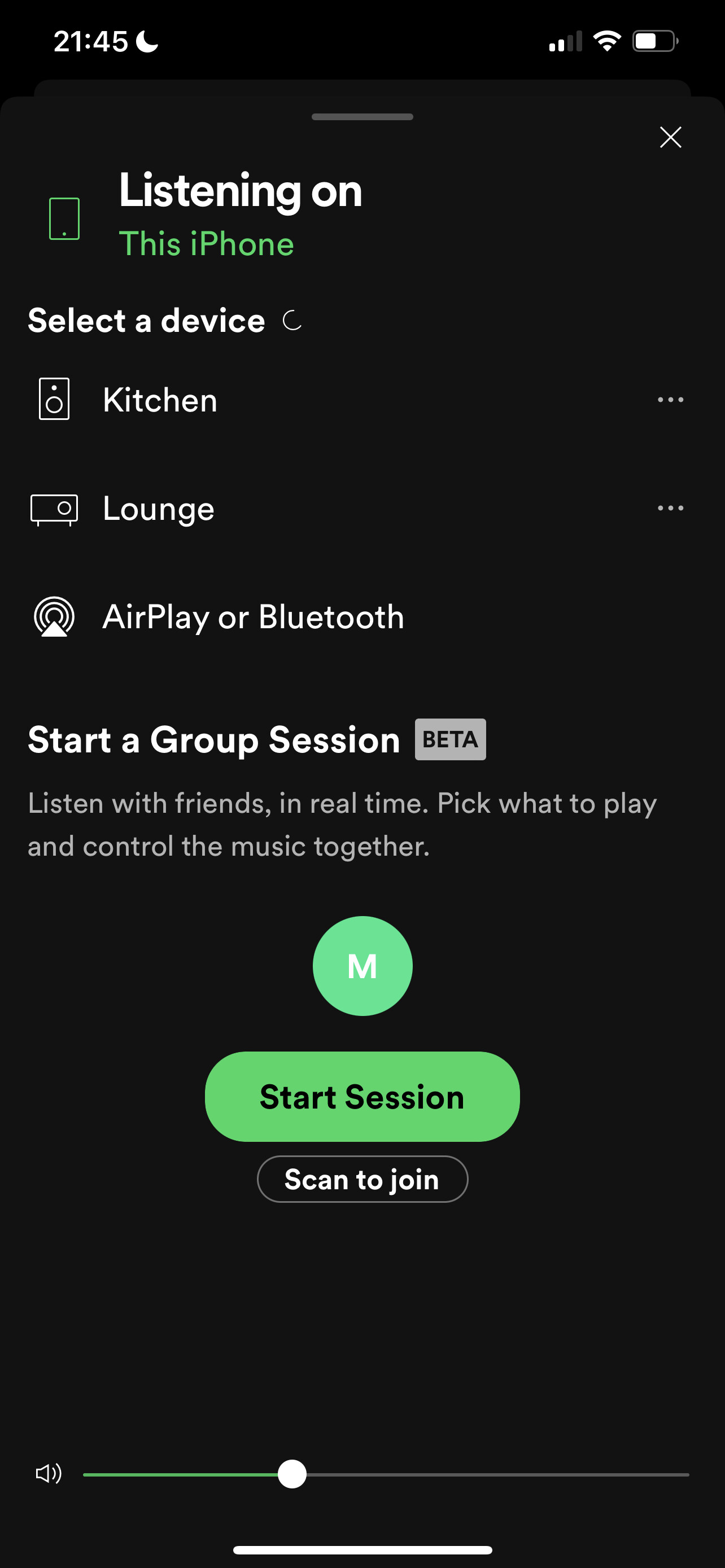

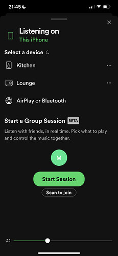

Oops. I got it a bit wrong. Play in Spotify. Hit the speaker icon on bottom right. Then choose airplay. Then choose speakers (in eg below, Sonus is kitchen and Atom is lounge). You can select as many rooms as you like
Roon will not allow you to group Sonos devices with other streamers. Roon multiroom groups must be all Sonos, all Airplay, all Roon RAAT, or all Chromecast. You cannot mix and match. Only Airplay would do that for you.

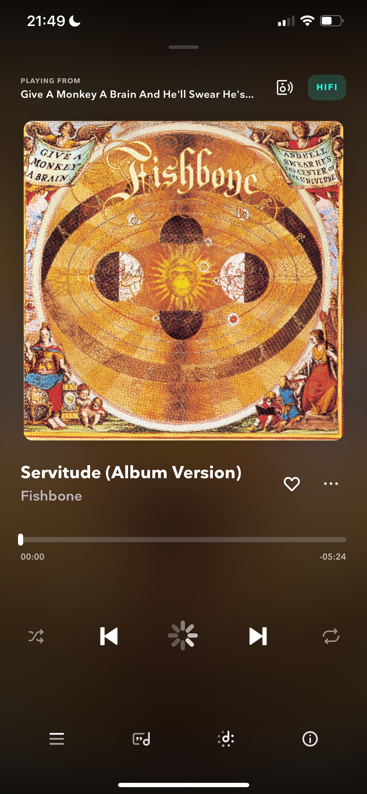

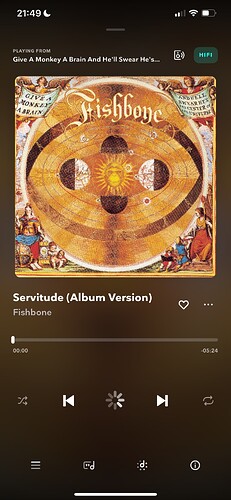

Yep. Airplay. Same steps get you there on Tidal. Except the starting point is the speaker icon at the top right of play screen
