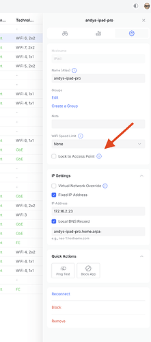

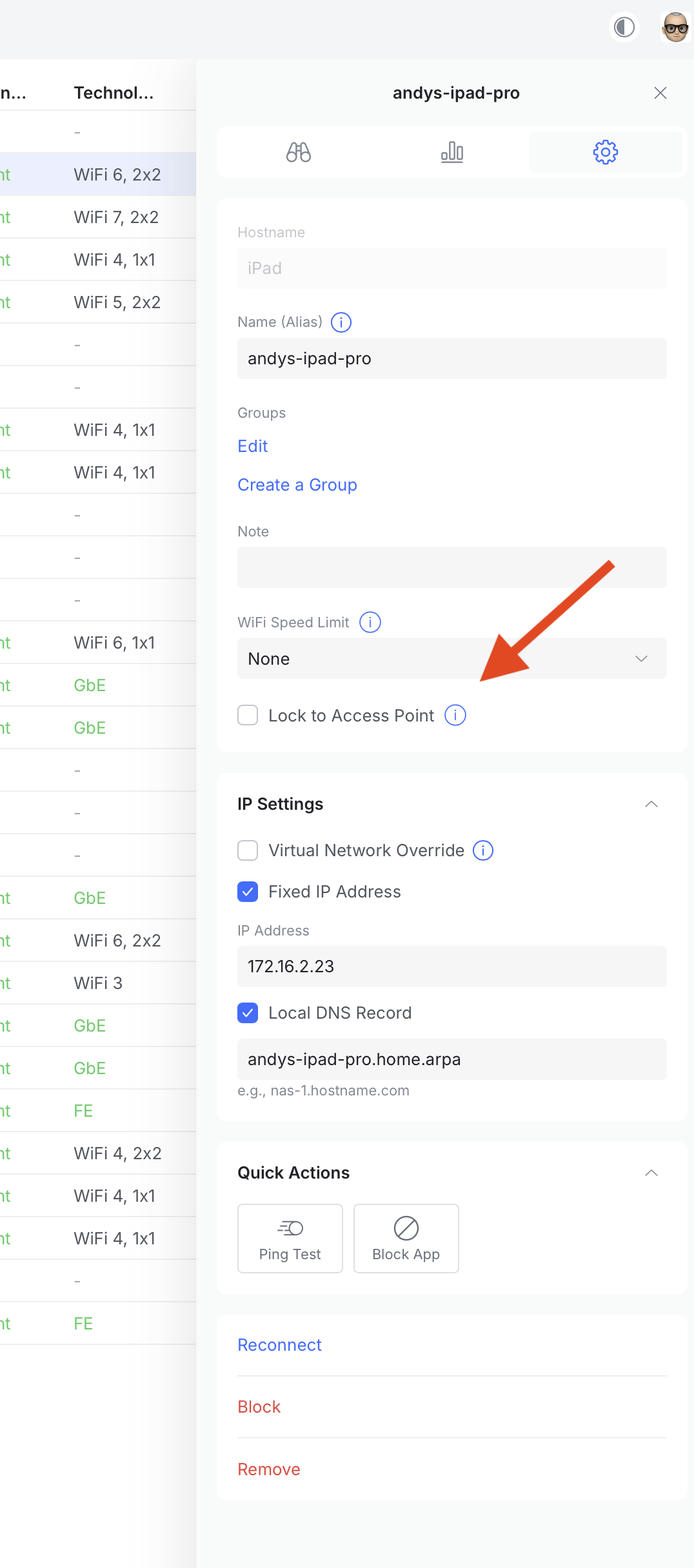

There is an option in the Unifi GUI to lock devices to a specific access-point, but I’ve never had to use it with the single AP I have:-
So, what I have is the BT Smart Hub 2 plus 3 black disc wireless extenders, which create the mesh network. Two extenders are downstairs and one is in the loft. The extenders are all wired back to the hub as I found that wireless connection of the discs wasn’t reliable enough once the signal had to pass through two brick walls. But yes, a mesh system is what I’m after, and I can use the existing cabling to connect Unifi (or another suitable brand) extenders back to base. Locking devices to a specific AP would be a huge bonus, as I have multiple outdoor lights that seem to do a merry-go-round of choosing which disc they connect to. And a better app than the very basic (and updated in a fashion that made it even less functional) MyBT wouldn’t hurt either.

Would that be using a Unifi system, allowing the devices to be locked to a specific AP? Adding POE injectors wouldn’t be a problem.
Yes using a Unifi system.
