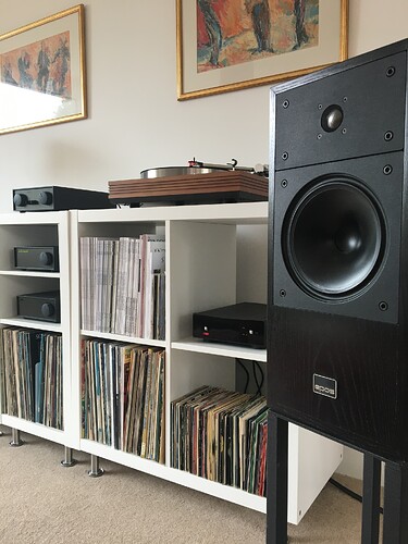

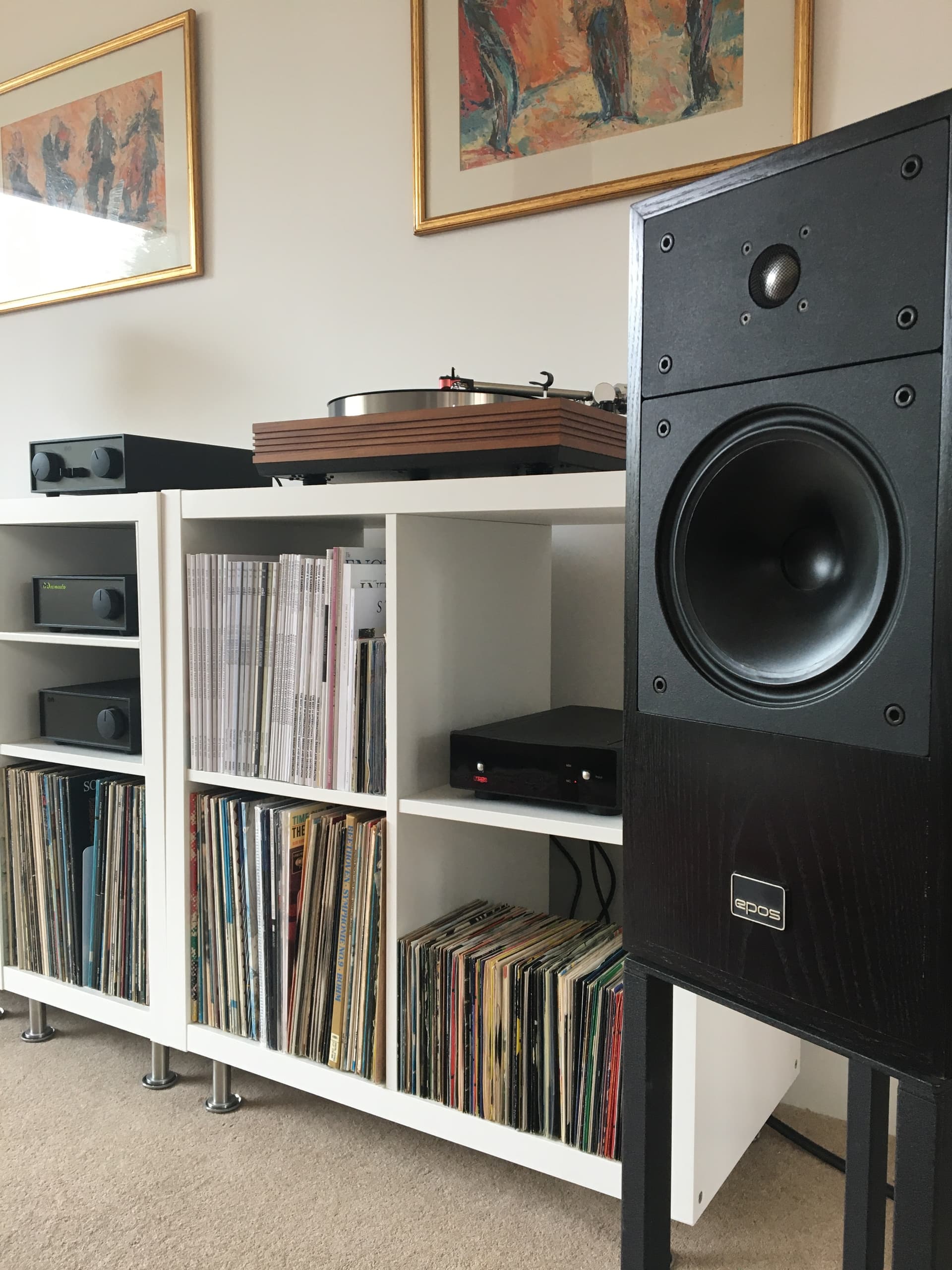

Here is an archive image of our much loved Epos ES14’s, alongside our LP12 and Olive shoe boxes NAC72 - HC - NAP140. All perfect partners.
Feel free to share stories, anecodotes, comments and photos of your experiences with the wonderful Epos ES14 stand mount loudspeaker.
