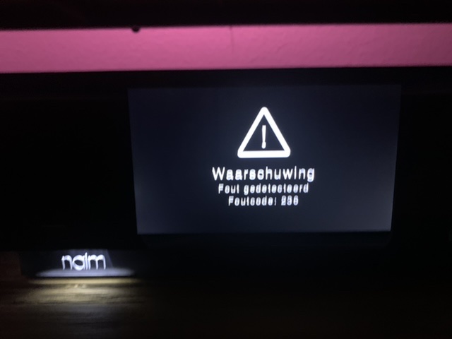

Hi everybody,
This evening I was listening to my Atom when the sound suddenly dropped and the display stated errorcode 236 (in Dutch).
The unit didn’t respond to the remote or to the display. After unplugging the unit all is working fine. Does anyone have a clue what this is?
Thanks, Stijn
Hi @DelStino
A 236 is a low level I2C bus error detected. It is feasible a heavy mains power disturbance could of caused it.
For now don’t worry about it, but if it keeps on repeating, get in contact with your dealer / Naim tech support.
Best regards
Steve Harris

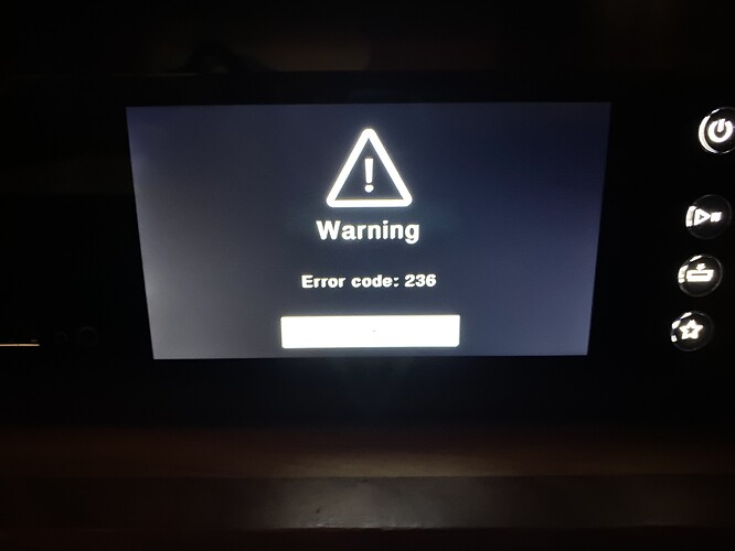

Same error here after the 3.3.4 upgrade. First power button blinking without any response to buttons or remote. After restart error 236 without anything responding.

Yes I did. Unplugged overnight and plugged in this morning. Same error. Went to dealer this morning and Naim says it is a hardware fault and unit needs to be sent back to factory.

I am having the same problem. This is my 2nd Uniti Nova - I’ve had so many problems with the flakey firmware; I’ve started uploading videos to YouTube to document them.
I got the 236 error followed by a loud, disconcerting “pop” when having to unplug the unit (again). I will never buy a Naim again - I am seriously concerned that it is going to damage my speakers.
Bringing back my 2nd Nova and pleading for a refund.

Thank you Richard! I am returning my Nova (second one) today - a reply email from support finally arrived (previous emails to support were being returned because the mailbox was full!). The email said the blinking light indicates an internal fault and the unit must be returned to the dealer for servicing.
