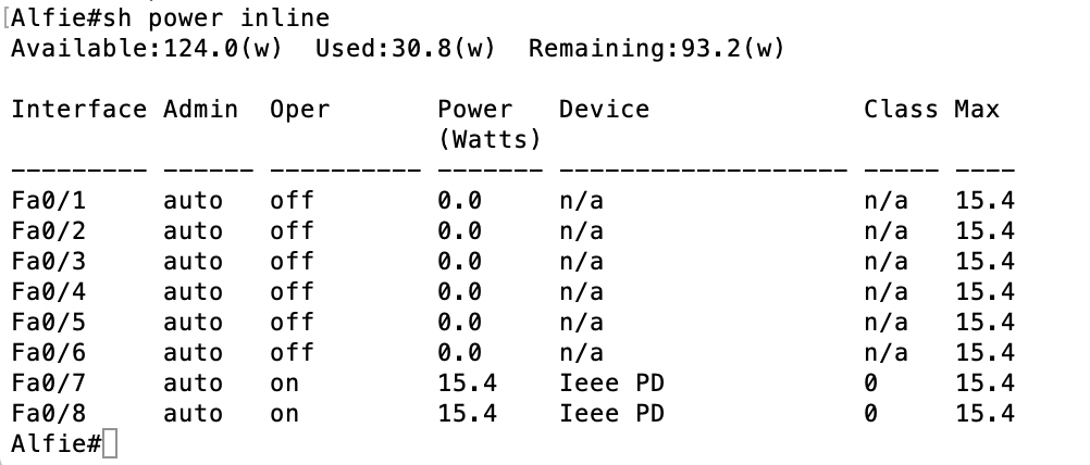

PoE is plug and play by default - so about 5 seconds

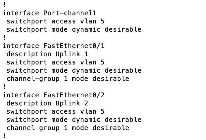

Etherchannel requires the use of the console port - or loop back IP address if you have configured one to log into your switches and configure.
My config on one of my switches to setup the Ether Channel
Virtual interface EtherChannel Port-Channel 1 is mapped to interface Fa0/1 and Fa0/2
I use ‘vlan 5’ for my house family network traffic - you can leave this out
‘switchport mode dynamic desirable’ and ‘channel-group 1 mode desirable’ simply means it will try and build a Cisco EtherChannel if it can with the other switch.
Here is the show power command that shows two standard IEEE PD devices being powered - and their power budget

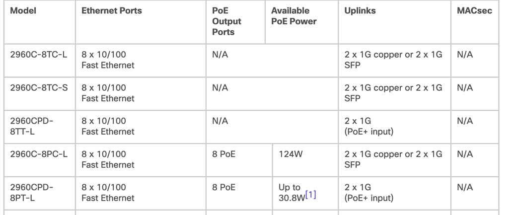

I went with the WS-C2960CPD-8PT-L. $80 USD shipped. I’m told it can send POE to my 2960CPD-8TT-L. I’m hoping there are some benefits to be had from the switch closest to my streamer and NAS not being plugged into the mains and the first switch having an external auxiliary PS instead of internal PS. We shall see.
I hooked up my 2960CPD-8PT-L yesterday, being fed by my main 2960PS-16. You will have to go into it to manage It to accept two or more cables for power I believe. I couldn’t get mine with one poE uplink to power on the office 2960PD. I need the other 1000mb uplink to go to the opticalModule which only accepts 1000mb. All BJC Cat6a except a Melco Opal between the two Ciscos. NUC Roon ROCK server plugged into the CPD switch now.

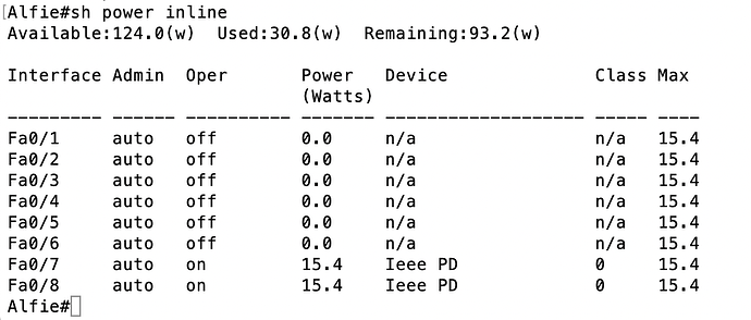

No - by default, PoE is on by default. There is no configuration to set - unless you want to disable PoE. See my above post. All plug and play…

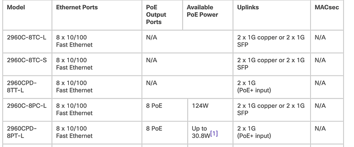

Great, thanks. So I will connect the uplink ports of the 8PT-L and 8TT-L and that is all I need to do, right?
you simply connect one of your power source ports to the PD device power port - which is typically one or two of its uplink ports.
If you have hard disabled (admin down) a port - then there will be no power - or the port has been error - disabled by the switch - a key error was detected and the switch shut the port to protect the switch or the network … but both of these unlikely if default.
The command
show interface status err-disabled will show any critical errors that required the switch to close the port
I think you just connect any of the yellow PoE marked output ports to the solus uplink port on the receiving PD switch.
