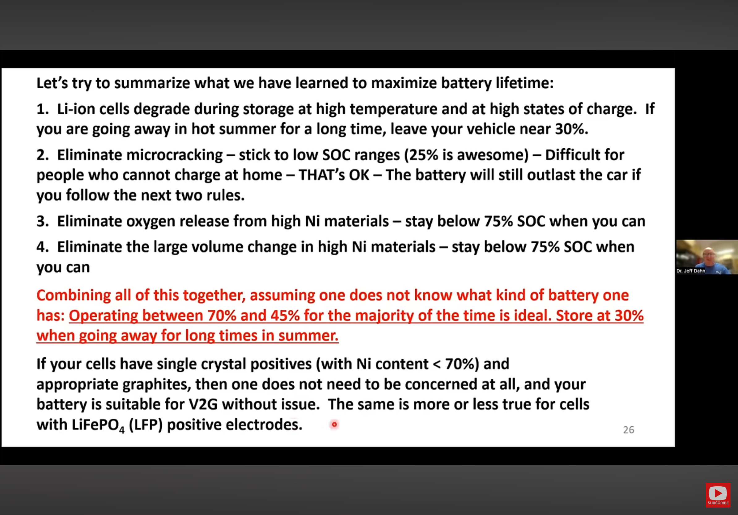

I’ve gone down a bit of a YouTube rabbit hole today about electric batteries and the best ways to charge them – this is probably one of the more authoritative and comprehensive ones I have come across.

I doubt there is consensus on these matters. Numerous variables will determine optimal performance and battery charging levels, not least the battery chemistry in use. The majority of EV batteries are lithium ion of one type or another. Most are NMC (nickel-manganese-cobalt) or LFP (lithium-iron-phosphate). Until recently NMC was predominant globally, although LFP is increasingly used, especially in China. Each variant will have its own advantages/disadvantages, such as capacity, safety, weight, charge/discharge characteristics, etc.
Unless you are a research scientist I wouldn’t think these matters are of particular significance to the average EV driver. While it may not be advisable to always charge to 100% and store it at that level, I think you should charge as you need to and rest assured that your your EV battery is guaranteed to perform beyond certain specified levels for at least 8 years. If you plan to keep your EV for longer than this then, of course, careful consideration of how you charge and how you drive might be worthwhile, although not for me.
Having some chemistry and physics in my background I found the presentation by the university lecturer Dr. Dahn very interesting and indormative. It gave me an understanding of why NMC batteries might generally be best charged to 75% rather than 100% but also not to worry too much about it as even with less than optimal charging practices that most batteries are good for 400,000km. He maintained that when most cars are falling apart the batteries will still be good and will all have a second life in power storage.
By and large the presentation would make you not worry at all about battery longevity but I think that it won’t be any great hassle for me to go from 45-70% SOC most of the time and so when my Kia falls apart the battery will have more useful life left than if I didn’t optimise it - and so be generally better for the environment.
If I’m understanding correctly single crystal positive electrodes which are already being made commercially will have no charging constraints and will happily go between 0-100 in (relative) perpetuity.

Okay I think that’s the point - the battery will last a long time, so I don’t worry too much about charging levels. In the U.K. the public charging network is generally inadequate (except in south-east England) and greatly overpriced, so a home charger is highly recommended.
Not sure about single crystal anode materials and their current commercial viability. Anodes are currently composed mainly of graphite but most research is focused on the cathode active materials. There seems to be potential for sodium-ion batteries to replace Li ion at some time in the future for some applications. However, it will be several years before current NMC Li ion chemistries are superseded in industry.

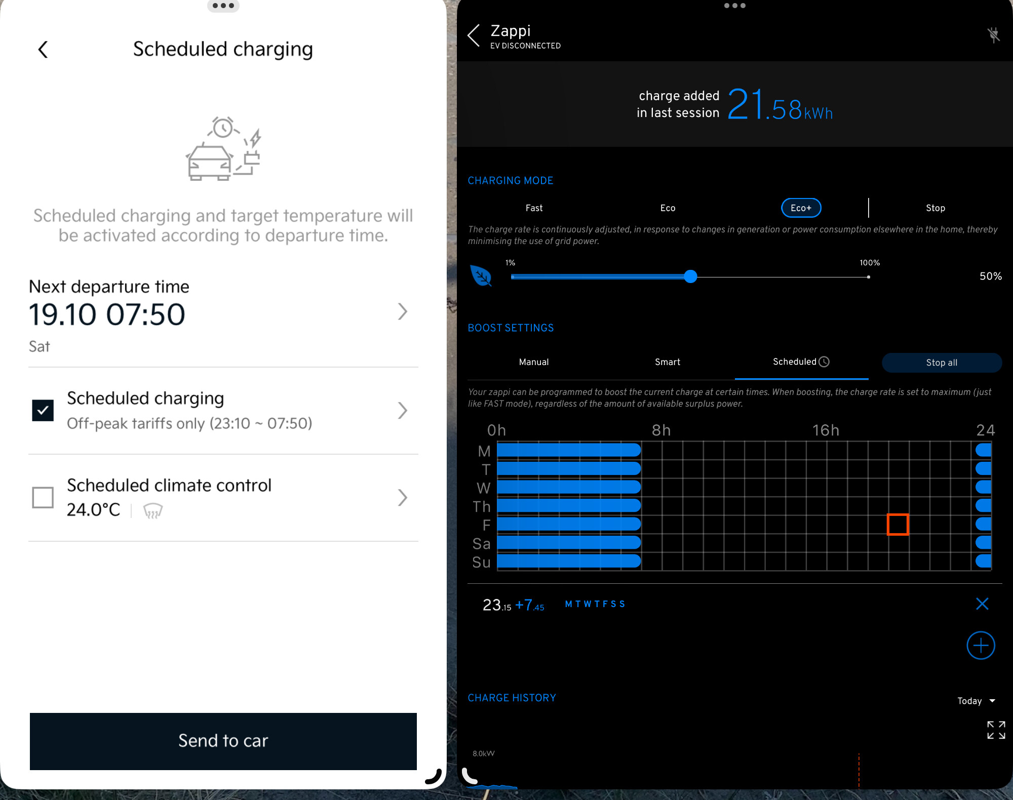

Zappi charger installed today :smile:

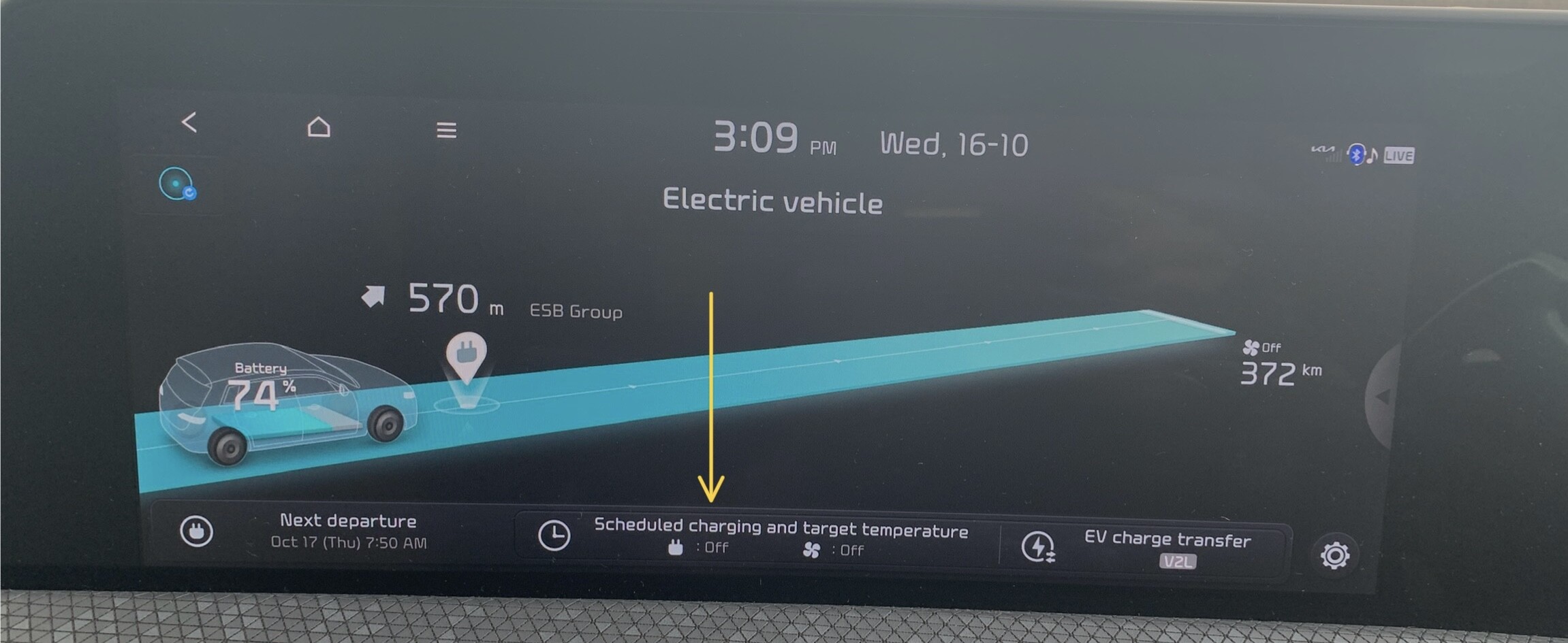

From doing a quick look at the Zappi online help and the Kia charging information On the Kia I’ve set up a daily departure time, added when my cheap(er) EV rate is and told the app only to charge on this rate. I’ve set the Zappi to fast as I don’t (yet) have solar.
I’m presuming that I will just select the scheduled charging when we need to charge at night and then connect the charge point and wake up with a recharged car.
I’m presuming that having a departure time set does nothing unless I have selected charging or climate control to come on?

I think the departure time is only for setting a scheduled climate control switch-on so it is toasty when you get in. You don’t have to set one; I don’t as I leave home at variable times each day. I just activate climate from the app 5mins before I leave. Note you can set the temp level and also options for heated steering wheel/seat (if you have them), heated mirrors/screen defrost in the app. It still works when not plugged in too, although obviously draining a bit from the battery to do so.
The ā€˜only charge in window’ and ā€˜prioritise charging in the window’ are options in the app, or use the settings button bottom corner of the screenshot. ā€˜Only’ will charge in the low rate window and then stop at your target level, or when the rate ends whichever happens first. ā€˜Prioritise’ means it will charge to your target amount (say 80%) in the window if possible, but start outside that if there is insufficient time to achieve that level. The settings for max level of charge for AC and DC are there too.
I only use the car app to set charging times etc. Our charger has no timer function, not sure if the Zappi one does. What I’m unsure of is how the charger will act if the car is set for one thing and the charger for another. The easy way is just to do as you have said; control from the car or the Kia app.

If your Kia app works in a similar way to our Tesla or previous Skoda app, then you may need to do 2 things:
Tell Zappi to push charge and tell the car to receive charge in the same scheduled time window.
The Zappi app does have a timer for a scheduled ā€œBoostā€ charge and you should set a ā€œscheduled Boost chargeā€ window in terms of start time, duration and which days of the week that you would routinely like the Zappi to try to push charge into your car.
Then program the car to accept charge in the same nightly window.
This works for us when the Zappi is in Eco or Evo+ mode.
If memory serves, leaving the Zappi in Fast mode may mean that the Zappi is trying to push charge all the time, so all you do is control the time window via the Kia app. This is the simplest way if you leave the Zappi in Fast mode.

This is my current plan, to let the Kia control when to allow charging in my night rate window to get a feel for the home charging experience.
However I think I might also like to lock the Zappi with a lock code as it goes against my instinct to have the full menu options open to anyone passing by. I think it’s unlikely that they would park their car and charge but it is feasible that a prankster could set a lock code and lock me out or do something else nefarious in the settings. Probably overthinking things but you may only need one prankster uploading to TikToc for every kid in the neighbourhood to be trying it. The knocking on doors and running away of the 2020’s.
Now that I’ve just articulated all that I’ve got myself more anxious!
Apparently there is a setting that hides the menus etc without a code and allows charging so I may set that up today which will still allow the Kia to control the charge but stymie the TikToc hordes coming to get me!

I’ll take @Bluesfan advice and have the charging set up in both car and Zappi tonight and see how that works.
I won’t need to charge every night but I’m presuming once it’s not connected there is no harm and it means any night one of us comes home and the car needs charging they don’t have to worry about any settings other than just plugging it in.

That’s right, it won’t do any harm. It needs both the charger and the car to want the charge before it will flow. If the car is already full or is disconnected, then the Zappi will simply wait.
