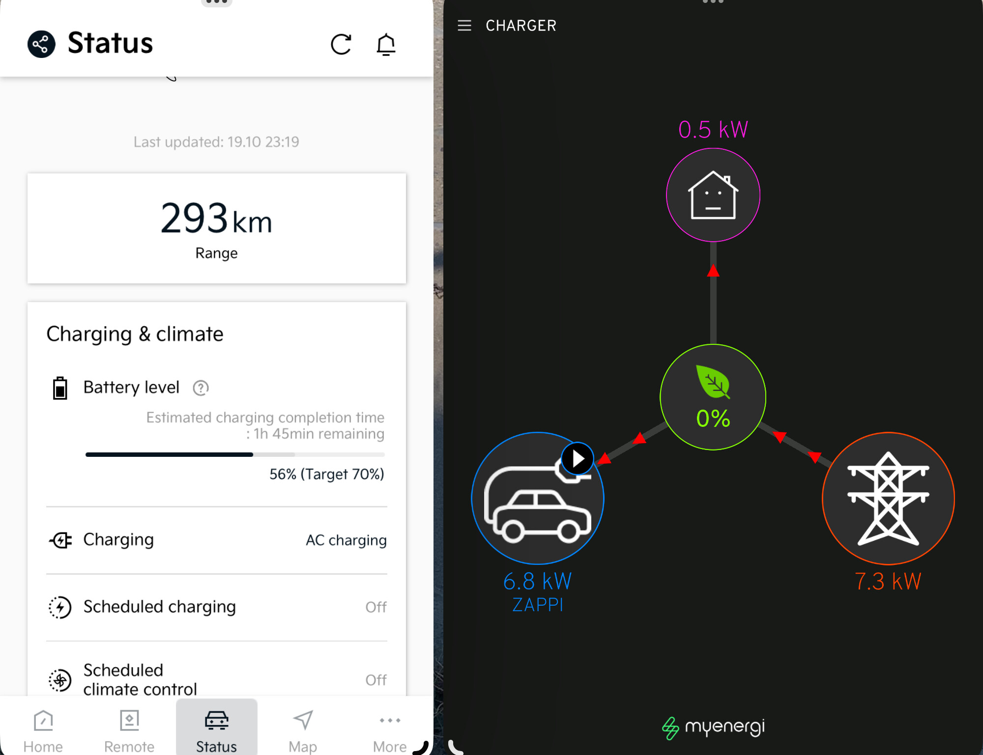

So it didn’t charge last night but I think this may have been due to a setting I had on the lock menu. I really didn’t like the whole menu open to view (and to tamper with) but think I locked it down too securely that it needed a passcode entered to even charge to a schedule. So this is the permanent view now.
So after changing the offending setting I decided to turn off the Kia’s schedule and just have the Zappi on schedule so that if that didn’t work I’d know where the issue lay.
Happily it started charging tonight at 11:15PM as scheduled in the Zappi.
So all good :smile:

As Bruce said they are ultimately plug and play. Upon install it was plugged into the car and it started charging immediately.
Setting up a schedule to use a cheaper electric tariff is actually quite simple either in the car (or app) or at the charger (or app).
I complicated things for myself by wanting to lock down the charger with a password and misinterpreting one of the settings that allows scheduled charging without this password being entered.

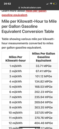

I think I may be missing something here. The Kia connect app tells me I’ve done an average 5.6 miles per KWh. This conversion online suggests this is around 180 mpg
This sounds a bit mad to me so I’m presuming I’m comparing apples and oranges or have a decimal point error?

I don’t really understand how you can make the conversion. Cannot be based on price (too variable). Is it on energy, ie 1 gallon of fuel burnt per hour generates a certain number of joules vs 1kW (which is 1000 joules/sec)? Anyway it seems a pointless comparison to me, or maybe I am missing something!
More importantly a journey at 5.6mi/kWh is pretty efficient, it must have largely been downhill surely? I’d expect around 3.5 at this time of year, a bit less if cold/dark/wet/heavy foot etc. I have never seen over 5 on the dash display on any normal journey. 5.6mi/kWh with the EV6 battery of about 77Kw capacity would equate to a range of well over 400 miles so unless your car has a hidden secret that is not likely.

Why do you think it is mad?
5.6/kwh may be a bit over the top for an avg journey but the conversion is correct.
One can make the conversion a KW is just a unit of measurement of energy and KWH an expression of consumption of energy over time an ICE car will go a certain distance on a litre of petrol (say) and a litre of petrol is equivalent to a certain number of KWH i.e. about 8.9KWH.
So to make things easy if a car on avg travels about say 8 miles on a litre of petrol it is the equivalent of 0.9 miles per kWH approx.
It is kind of pointless other than highlighting for those used to seeing efficiency of cars in MPG how efficient running a BEV is compared to an ICE.

Mainly because I’ve never seen it advertised or mentioned that an EV (in energy terms) generally does the equivalent of well over 100mpg. If I got 35 mpg in my Lexus I was thrilled! I’m surprised it’s not advertised more. I’ll certainly be telling everyone who asks me about its excellent mpg.

The comparison is correct in terms of the energy contained in a litre of petrol is known and the energy out into a EV is known and that can be converted to MPG. It does indeed help highlight how efficient an EV is. It is not all about emissions or lack of but how efficiently the energy we put into EVs is used.
