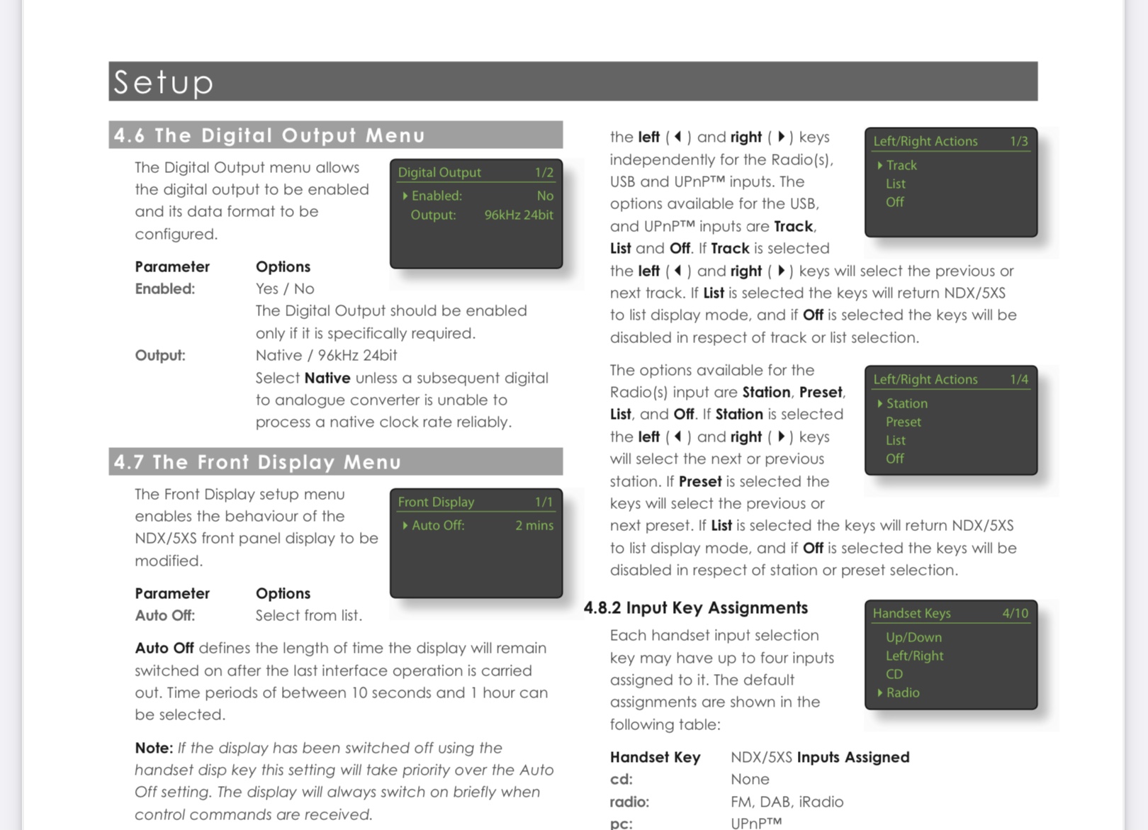

Hello, I need your help. My system consists of an NDX, a NAC 282, a NAP 250 and a Hicap. I want to connect an external Chord Qutest DAC to it. Can you tell me which sockets I should connect this DAC to and if there are any settings to modify on the NDX. Thank you.
You’ll need a coaxial BNC to BNC cable (75 Ohm) to connect NDX to Qutest. Naim do one, but there are plenty around at various price points. Mark Grant cables are very good, for little money.
Use the digital out connection on the NDX
Enable the digital output in the NDX menu (native setting should be fine)
