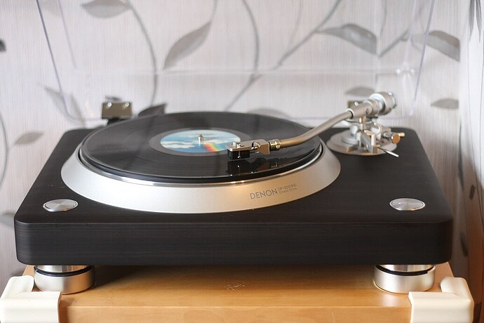

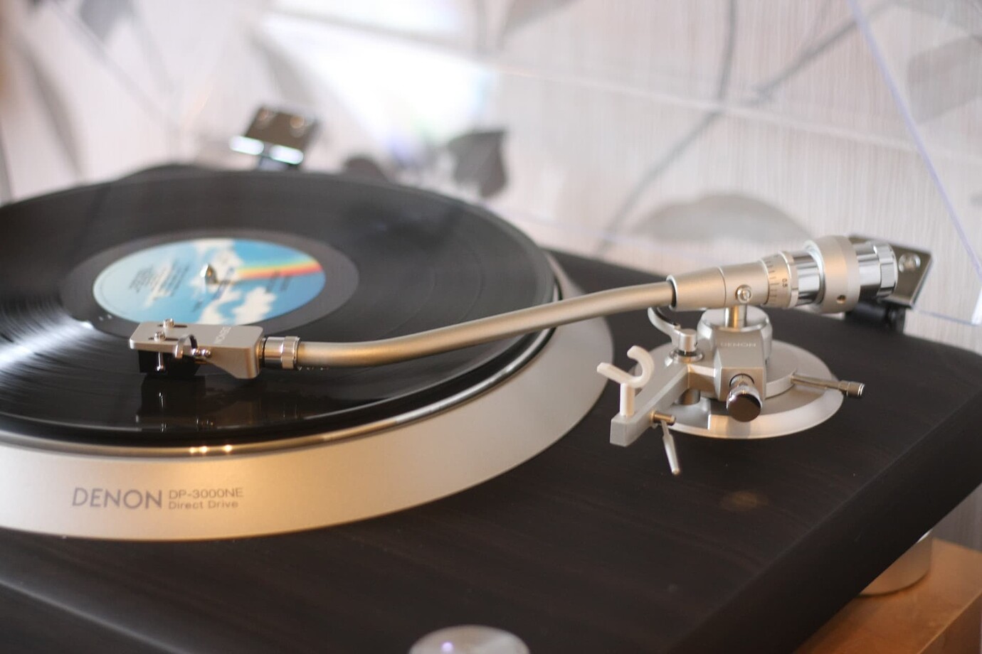

Looks won’t be an issue if you buy a Denon DP3000NE. And it has a dust cover.
Probably the same performance as the P8. Absolute pleasure to use, no springs to worry about, no belt to worry about and no bearing oil to worry about.
£1800 including arm, but you’ll need a cartridge. It’s a quality item, don’t know how they do it for that price.
