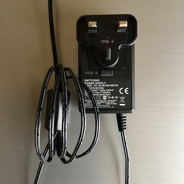

My main concern is with SMPS’s associated with my audio, this is NAS, broadband & phone.
SMPS’s operate at low frequency, typically 50KHz to 3MHz & there are only two ferrite mixes that are effective at these frequencies. I use Fair-rite ‘75’ with its impendence peak around 1.8MHz.
Wherever possible I fit clip-on cores with multiple cable passes thru the ferrite core, this multiplies up the impedance & slightly lowers the effective peak frequency.
This is my broadband hub SMPS

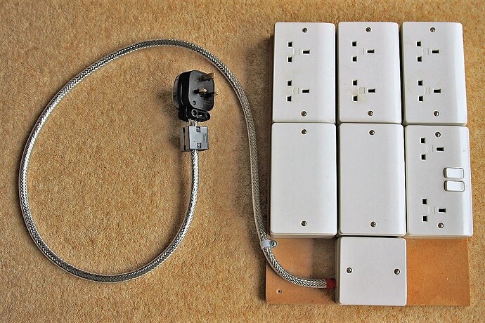

This is my power dist board, ferrite giganticus on the cable.
