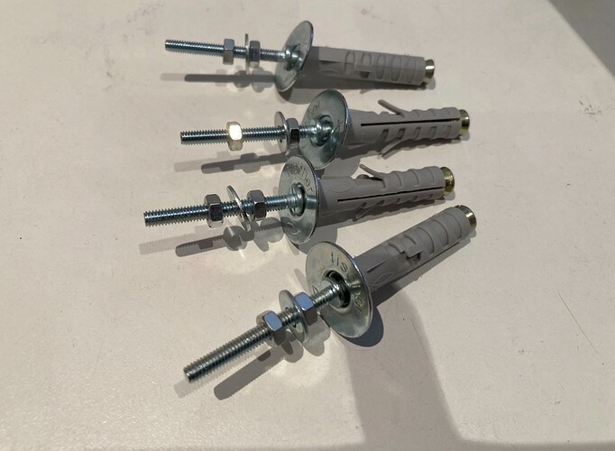

I’ve searched and just can’t find information on how to fit my newly acquired Audiotech wall mount, which I hope to use with my Linn LP12. It comes with new Fischer fittings, but I can’t fathom how to use these. I’m generally quite DIY savvy, but these are quite unusual.
Once the plastic plug is in the wall, I guess the large washer will fit flush up against the wall, then gets tightened by the nut in front of it. That would then have the nut flush up against the wall bracket; bolt through the wall bracket then tightened against the washer and nut on the outside?

I imagine you attach it exactly as you suggest: fix the fitting to the wall - I’ve never used an Fischer bolt so that’s a mystery to me - and then use the nut and smaller washer to attach the bracket.

Not mine but found a pic.
Looks like solid wall drill fit wall bolt add big washer tighten up then add shelf then another washer and nut.
I’ve seen them just sitting on the wall fittings then fitted with big wing nuts.

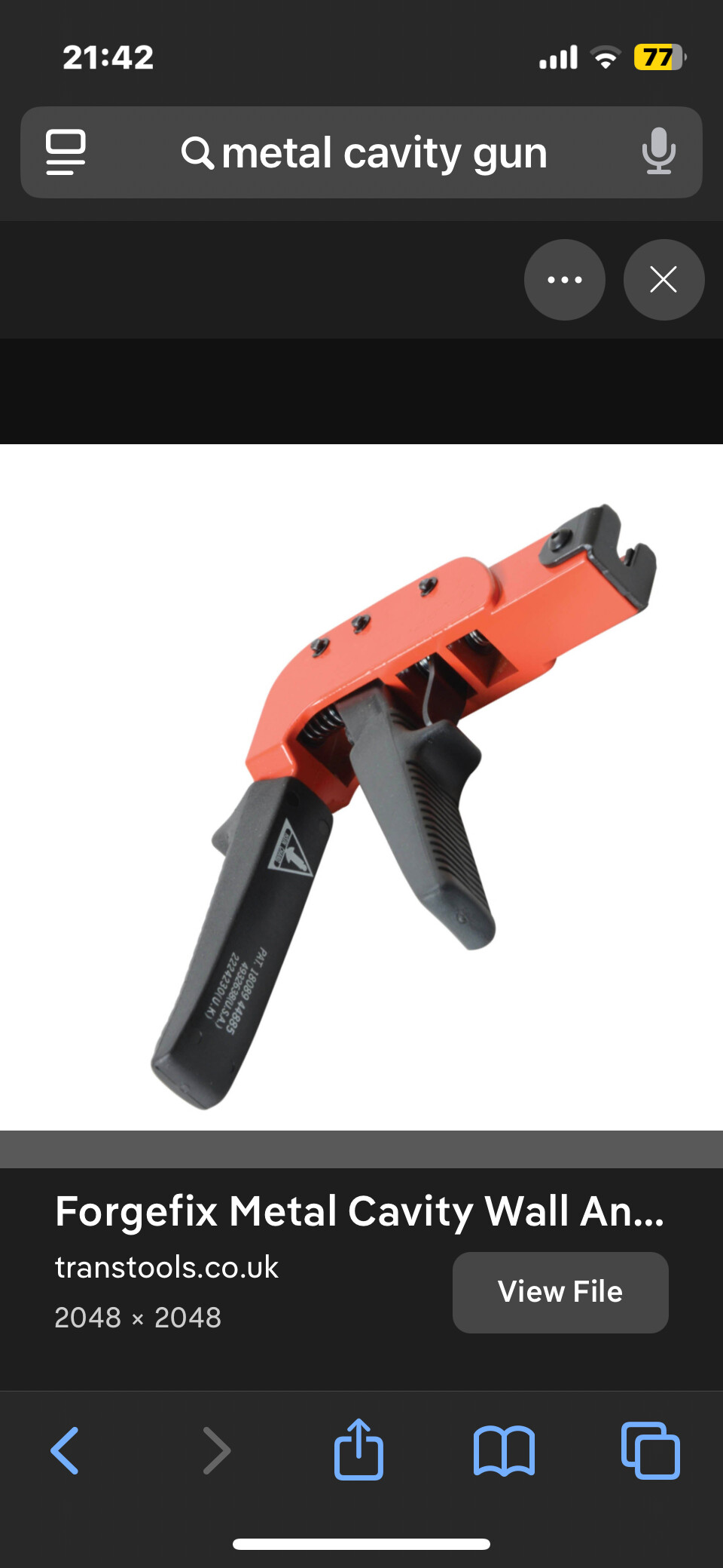

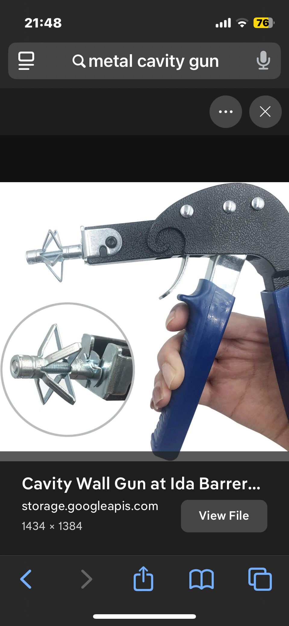

To use the Fischer bolt You need a special tool too use them, I’m looking for it now, works similar to a rivet gun,
Also they are for plaster board walls, If you going into brick use standard wall plugs
You are correct re how they are installed. They are not, as people are suggesting, cavity fixings, they are plugs for solid masonry walls. I believe they were supplied with rubber washers intended to provide some sort of anti vibration.
You need reasonably good masonry to install them so that you can drill holes in exactly the right position. If the walls make this difficult I would replace them with resin fixings.

Thank you! This picture is really helpful
I’m 99% sure that these fixings are for solid walls. I think I have brick outside and breeze block on the inside.
The fixings you have will be fine for breeze blocks unless they are dry lined in which case there will be a small cavity behind the plasterboard which isn’t ideal. Don’t be tempted to use cavity fixings on plasterboard, it’s not strong enough to hold such a shelf reliably.

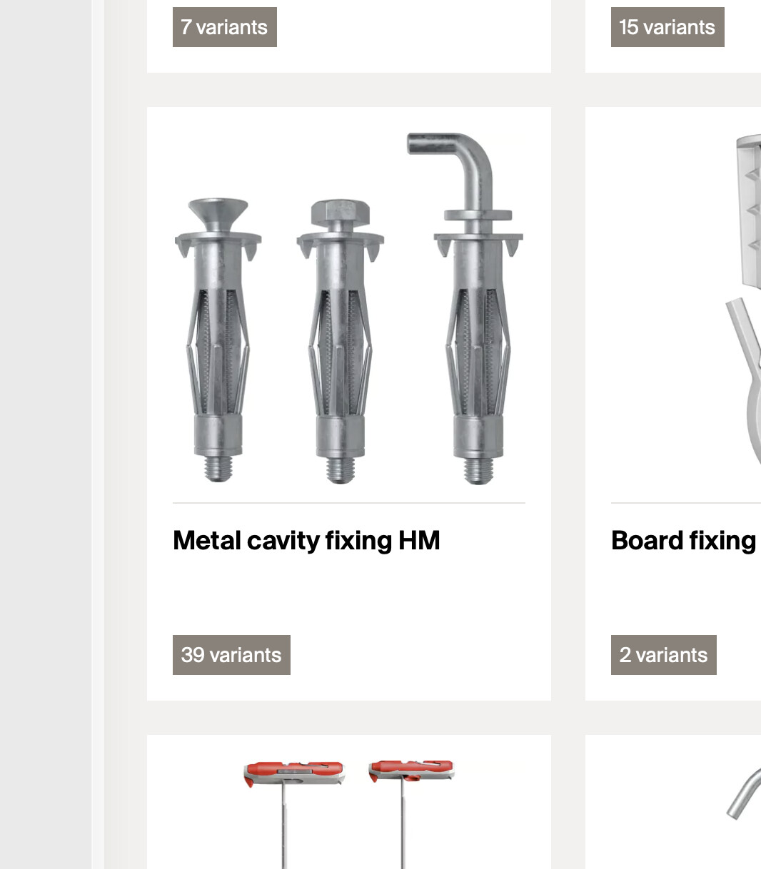

Yes there are strong enough,
I have hung many a heavy mirror using these on stud walling, go watch a video on how they work,
That’s not really relevant, as the OP has solid wall fixings and a solid wall. Remember also that a mirror hangs flat against the wall, so the fixings won’t pull out if used on a cavity wall. But when you fix a turntable bracket, the weight is much further out from the wall, which massively increases the force on the fixing. The fact it may be supporting a £10,000 turntable rather increases the jeopardy.
@HungryHalibut totally agree with you, I already stated in earlier post to use standard raw plugs if it’s a solid wall
Was just trying to explain that these are for plaster board walls,
Then I got into a debate
Thanks. And without getting into another debate, I’m no builder but I do know that the bolts shown in the OP’s first post are for solid walls. Anyway, the OP seems to know what they are doing.

@HungryHalibut just gone back through post, it was the second picture I was commenting on,
Not the OPs picture,
I’ve gone back and edited my first post explaining that I was talking about the Fischer bolts,
Not OPs
