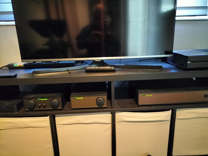

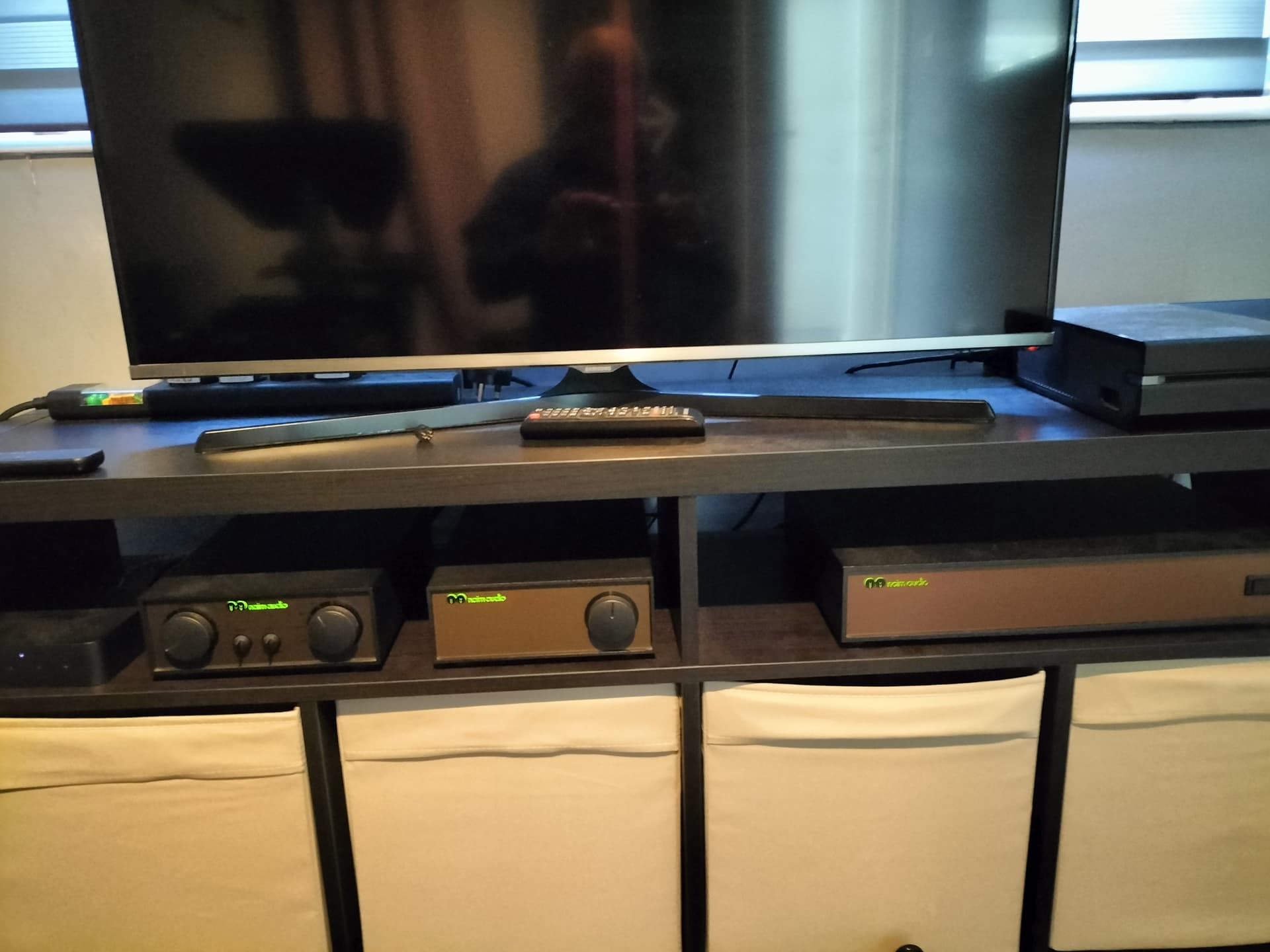

Update, I got another HiCap. It makes a big difference. Thank you for all your help guys. I have these with Ruark Icon and a WiiM steamer.
