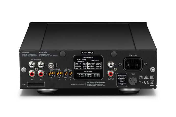

So presumably my NDX2 should be floating as well if I have a Rega Aria also connected? Both to Nait 50.
I don’t think so. The Aria seem to have the earth pin removed from the inlet so it should be “floating” meaning you should have your NDX2 on Chassis.

To be honest, I can also get a bit confused with ground or floating. I also have an Aria connected with a ground wire to my NAC252 and the Aria itself connected to the 252 in phono analogue. My NDX2 is connected with DIN to the 252. Should it then theoretically be set to floating or “default” as it is called on the NDX2…?

Provided you don’t have another source with the signal earth connected (such as a Naim CD player) then set it to ground. The Aria floats the mains earth.
