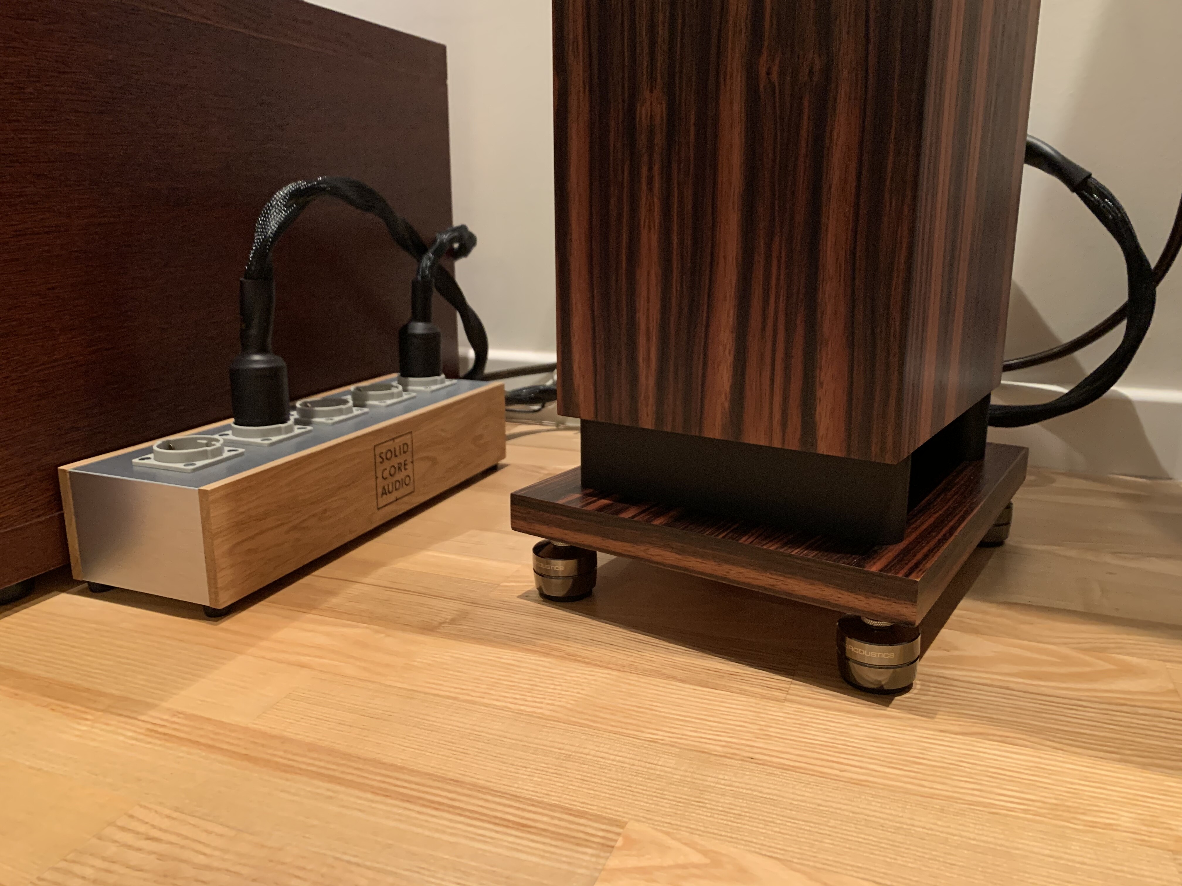

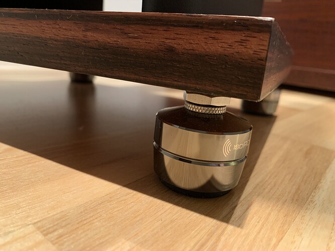

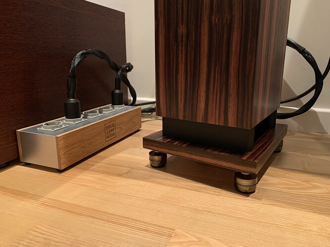

Hi, maybe I would be able to help while introducing myself to the forum (this is my 1st post).
I have mounted gaia III on my ProAc’s D30rs. As per manual, I have left some space between the locknuts, in order to fit them so the logo is in front of the listening position. In my case this distance is ~1mm. I have followed the online tutorials provided by the manufacturer as well. Take a look:
And, btw, they helped in my case in tightening the bass, made the scene wider and improved „ungluing” the sound from the speakers (hope this is clear, as English is not my mother tongue).

Hey, Shinobi, great pics and a warm welcome. Those Gaia mounts for isolation keep ticking away at the back of my mind…its on the list😁
Can you post at your leisure what your system is…
looks very nice.

Can you post a pic ? You have made a nice purchase :+1:
The nuts can have distance and may need it to level against the floor.
You just have to screw the bottom nut hand-tight against the foot, screw the screw into the speaker for 6 turns minimum, level the feet (with logo on foot facing forward or backward), and tighten the top nuts against the speaker.
You have room to play with how far you screw into the speaker (minimum 6 turns) and hence the distance between the nuts. What’s important is that the weight is distributed evenly over the four feet. When you wiggle the speaker, it must move evenly over all four feet, not push into just one or two.
Give it time to settle after leveling. If the floor is hard and it is leveled correctly, all four feet will suck to the floor and each one will come loose with an audible pop when you tilt the speaker sufficiently.
