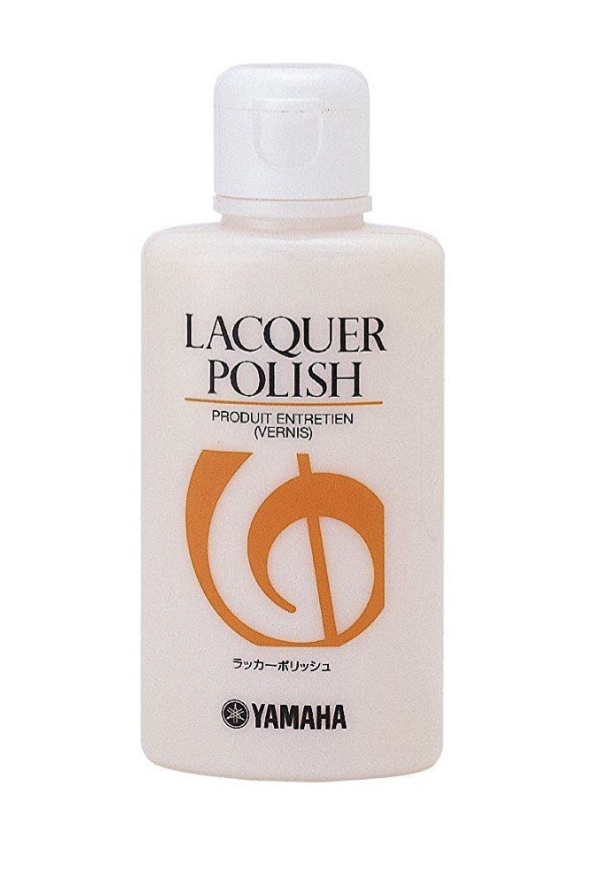

For those with a gloss black piano lacquer finish to their speakers, or a high gloss lacquer, I can recommend the Yamaha Lacquer Polish.
Treated my B&W 805 Signatures which have a Grey Tigers Eye lacquer finish with this, and the shine is deepened and easier to keep the dust off.
Also treated the Acrylic casework of my Michell Orbe too!

Thanks for that, and yes following treatment the depth of shine is just great.
Now, they were nice before (had them over 3 years, bought 2nd hand and date from the '00s), but the application of the Lacquer polish has really replenished the shine and finish - hence my recommendation here to owners of speakers with Gloss lacquer finish.
I think we can safely assume Yamaha’s polish is designed for it’s piano’s. Not sure they publish what it is, or whether your speaker manufacturer does.
great , thanks for the suggestion on this polish
They mention it’s generally polyester on their gloss black pianos. I am sure that polish is safe on pretty much any other gloss finish you may encounter on a speaker (or musical instrument), all I was saying is that there isn’t only one way of achieving a gloss black finish.
