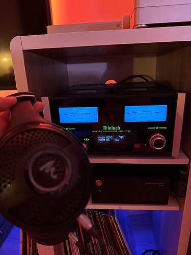

Though I would consider my Utopias and Macintosh to be more than adequate they get very little use compared to the rest of my system. Eventually you get used to the acoustic panels in your living room :rofl:
