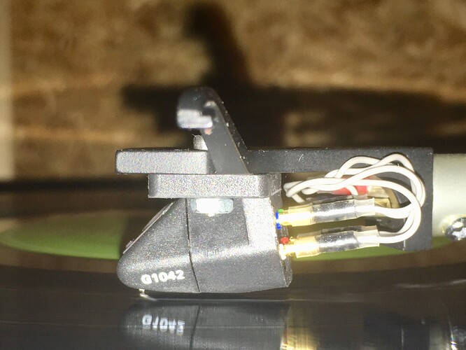

I had a G1042 on my Rega-3 when I sold it.
I can best answer your height question with a photo I have in my archives. For sure it didn’t have a height problem.
I went thorough all the cart-fav-raves in the 80’s & 90’s, Linn, Rega & AT’s & for me the Goldring was the best MM for SQ in a Rega.
Thanks for the speedy reply (and picture) Mike-B.

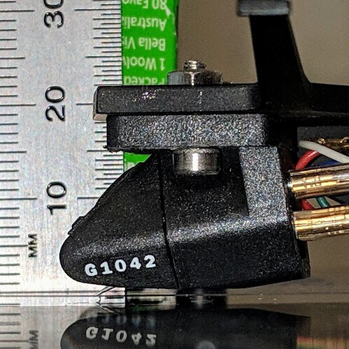

Hi @TallGuy,
I run a 1042 on a Linn Basik. Its a great cartridge. I have found, as many others have, running slightly heaver than the 1.75 grams is much better. This pic is running at about 1.9 and sits a bit lower as a result. if you need another pic running as standard 1.75, then give me a shout.
Hope this helps.

Thanks, I think from both pictures on this thread the top of the cartridge looks pretty much parallel to the disc surface - my worry was that with the Rega arm having a fixed height that there would be an downward slope towards the bearings, thus bringing the cartridge body into contact with the disc - the Rega arm height is (obviously) set for Rega cartridges, which don’t look to me to be as tall as many other brands.
