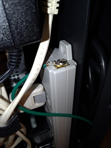

Sweden is very similar to Japan in this respect. Most Japanese hifi has no use for a mains earth so it isn’t an issue. However, for my Naim office system and equipment for work that must be earthed I resolve the issue like this:
Run an single earth lead from a 50m drum off the nearest earth screw post. That is probably near the plug socket for your washing machine or fridge. If those use regular 3 prong earthed sockets, you can buy plugs at the hardware store that simply provide an earth screw. tack this to the skirting and at the point where earth is required use a mains block with an earth in screw. In this way, the mains block gets regular L&R fron the wall and earth via the long earth run. Ideally space connectors should be crimped to the ends of the cable to avoid bare wire connections.
I reccomend mains blocks that are designed for this so that it is an intended use case and not some dodgy DIY electrical hack.
Here’s an example of such a mains block connected to external earth.
That is totally not legal in Sweden. Either you use non earthed sockets in your room or earthed. Never mix nor run earth wire from other places to a non earthed room.
