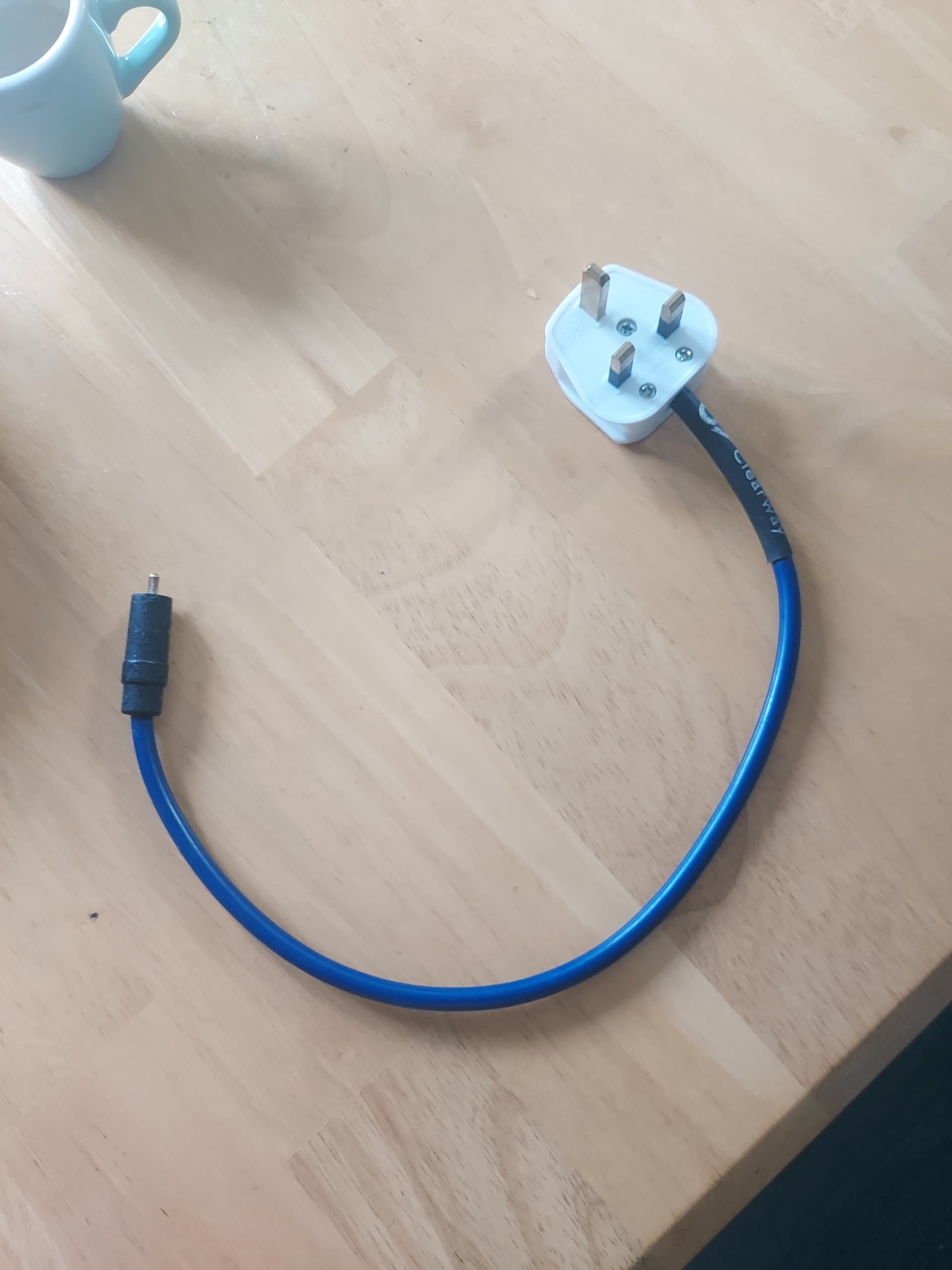

Buy a cheap phono to phono lead off Amazon. Pull it apart to give you a single cable. Lop off one plug..strip back insulation to reveal shielding mesh. Get a spare mains plug and connect the shielding mesh to the earth pin. Cut the signal wire short and do not connect to anything.
Plug into free mains socket and the phono into a spare RCA plug on your Marantz.

Unfortunately the answer with grounding isn’t a definitive answer. You will need to experiment. I would first ensure that among the CD5i and DACv1, that only one has the ground switch set to Chassis. Naim configure it so that a single Naim source should provide the signal ground reference for the whole system.
Then you might try a ground wire via the Marantz to the signal ground screw terminal on the SN2.
Rememebr to only make one change at a time and then test before making the next change. @Neilb1906 suggestion has certainly worked for a lot of users. But I would try other things first. dongling the return direct to mains is actually a good way of causing the problem you have if you don’t have it already in many cases. You might even find an RCA screw terminal (literally an RCA plug that goes nowhere and has a ground screw terminal on it) between Marantz and ground terminal on the SN2 works.
The goal is to make sure the signal ground has one and only one path to earth. As the Marantz doesn’t have it, connecting it to the SN2 somehow upset the balance somehow.

I did connect the Ground screw of the Marantz with Ground of the SN2 with no change at all. Same hum as before.
I will now butcher a main plug and reanimate my soldering skills.
