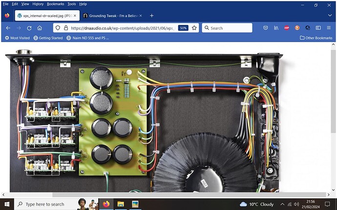

Interestingly, when the Ndac is upgraded with an external power supply, there is a direct connection through a dedicated cable for that purpose in the power supply.
You’re right in that the signal ground to mains earth connection is via the chassis. Main earth comes in and is connected to the chassis and to the transformer’s electrostatic screen.
Hard to see on the nDAC, but on the streamers you can see the connection to chassis for the ground switch via a bolt through the PCB near to the ground switch itself. The XPS you show, can provide a mains earth connection to the accompanying head unit via the burndy as upgrading a streamer with the XPS would remove the mains lead (and mains earth connection) from the head unit itself.
The nDAC doesn’t need this earth connection from the XPS as when it’s connected to an external PS, the nDAC still has its own mains lead connected and mains earth is provided through this, as it would be if no external PS was connected.
