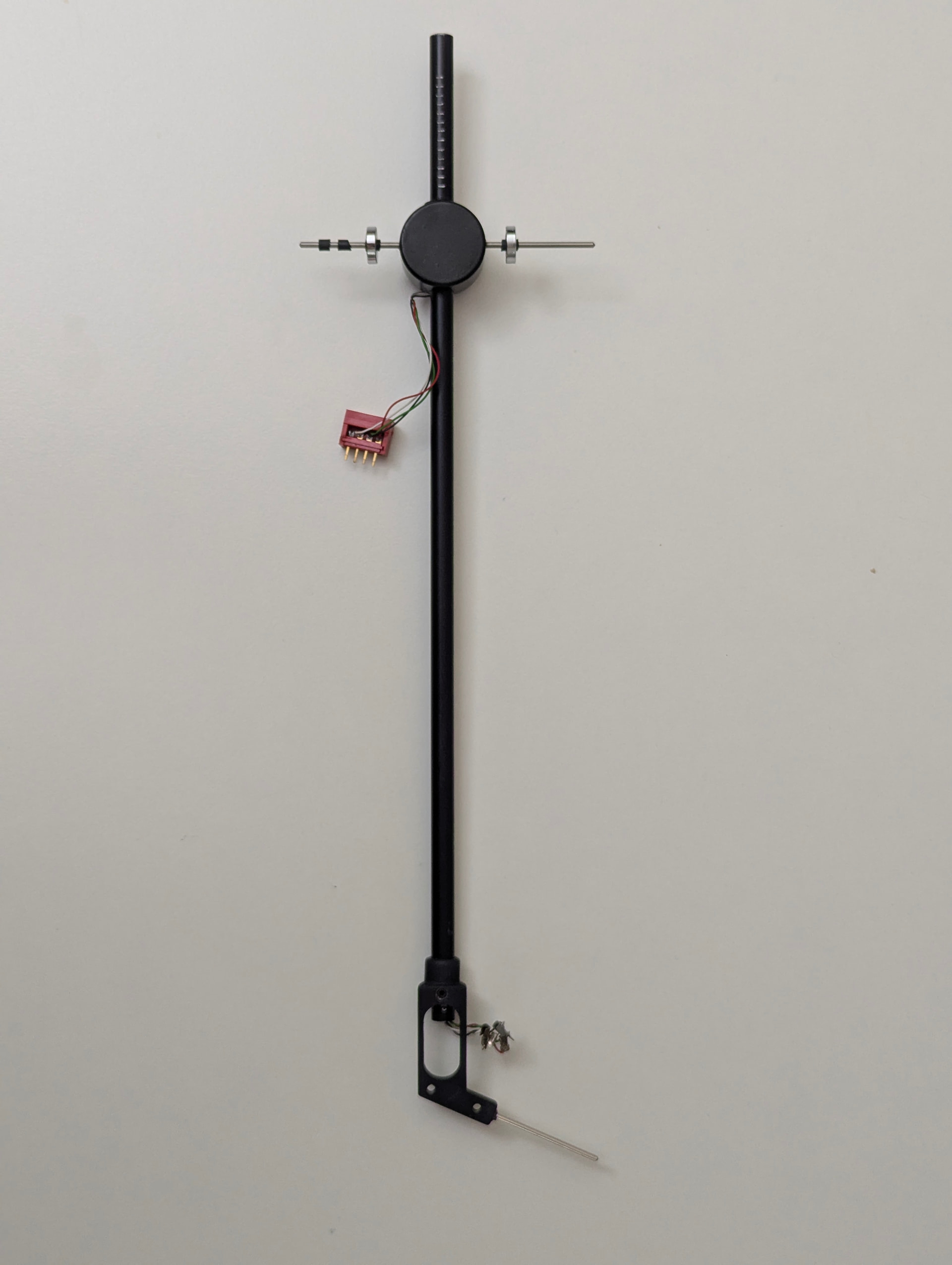

Dug my new tonearm out of storage and ready to mount into Thorens TD 160 MKII. Parts all seem to be in box, however no manual or setup guide so looking for help or copy of the manual. I suspect the outriggers are for setting the VTA, but how far out?

Including a pic of the stripped down tonearm :wink:
Many of the photos and docs I’ve found only show one outrigger

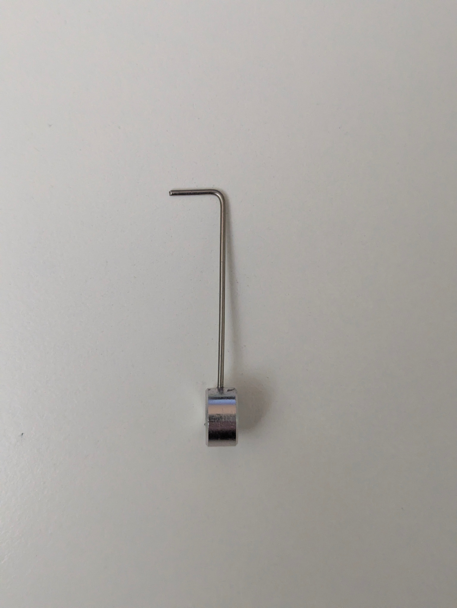

Thanks, I have a Shure V15 HE ready to attach, plus a couple of Ortofons. Do you have any instructions/advice regarding the positioning of the outrigger weights? Also the arm/hook for the bias wight is the version without the loop and has does not have a pully so I’m wondering if I’m missing that

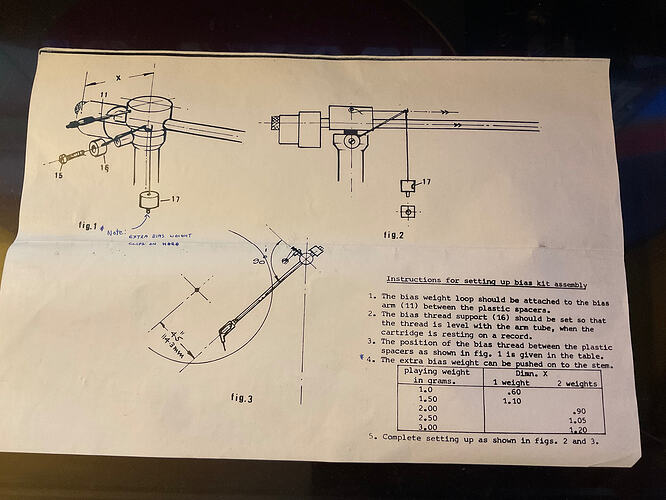

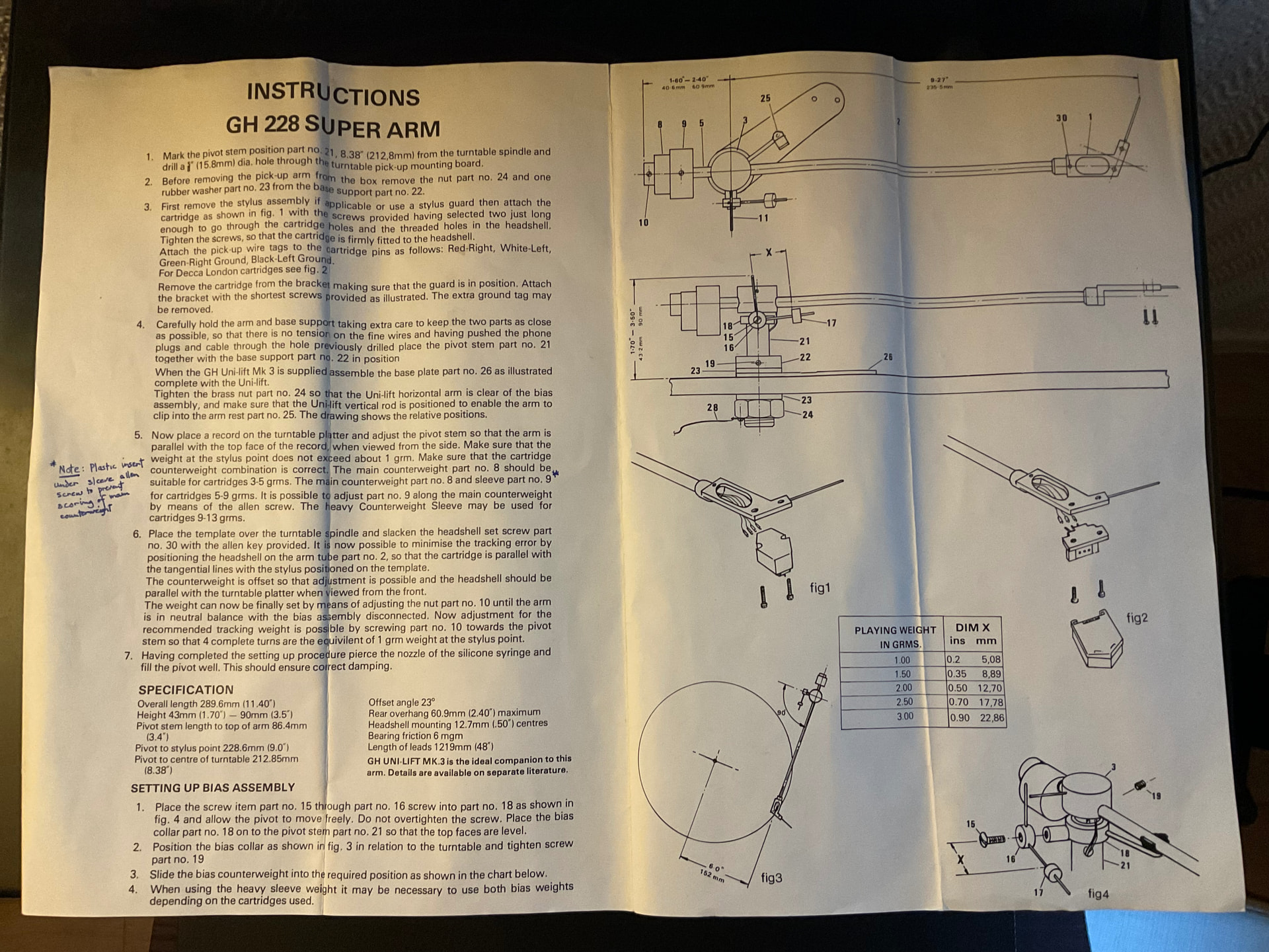

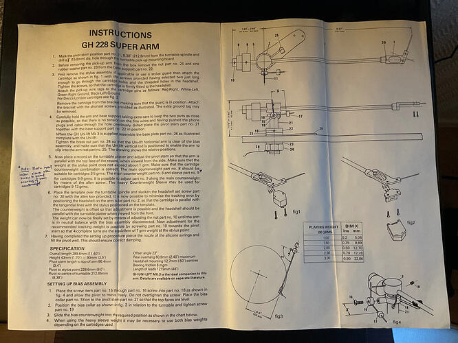

Here is what I have. Now mine is a 228 Super Uni-Lift Mk III from 1978, so I am not sure about the compatibility with yours, but hopefully it is of some use for you. :slightly_smiling_face:
I take it that you have the different bias weights, spacers etc.
Martin.
Thanks for digging this out Martin
The bias system is more like the second photo with the hanging by a thread weight, albeit there is no loop at the end of item 16. I purchased my unit circa 1981. I suspect the weights on the outriggers are for tweaking the VTA so the headshell can remain aligned with the housing item 3. Seems Hadcock couldn’t stop tweaking

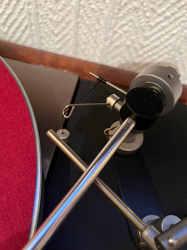

Ahh, OK I see what you mean. Here is what mine looks like in that area. Unfortunately I am not technically gifted to advise any further. I am actually scared to touch it and any work has all been done by Ross the techy guy at my dealer! Though I cant help but think there has to be a boffin out there somewhere who can help!
