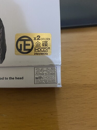

Like you I’ve only recently heard of HDCD’s but the few I have are definitely 24/96.
Here’s an example of one of them.
As you say if the Uniti Core can’t read them as 24bit then there’s no point in buying them. But this is what I’d like to know/understand.

As Chris mentions earlier, the HDCD is still 16bit, but encoded so when played back on a HDCD compatible player would be the equivalent of 20bit.
Your disc looks like A Rush of Blood to the Head by Coldplay - i’d be very surprised if the labelling has any meaning to what is on the disc (was it bought on Ebay ?) - it won’t be 24/96.
Hi James - you assume correctly on both the correct album and also the place I purchased it. I was told it was a Japanese Import.

Hi Pete - I’m pretty sure the Naim rippers won’t ‘expand’ out genuine HDCD discs when they rip. Something like DBPoweramp will do this though. I’d avoid the Ebay discs - if you want high resolution, then the download sites (HD tracks, Hi-Res audio) would be better.
The Ebay discs are likely to be pirate copies or are of dubious provenance and even if the mastering was done at 24/96, it would still need to be downsampled to 16/44.1 for the CD copy.
