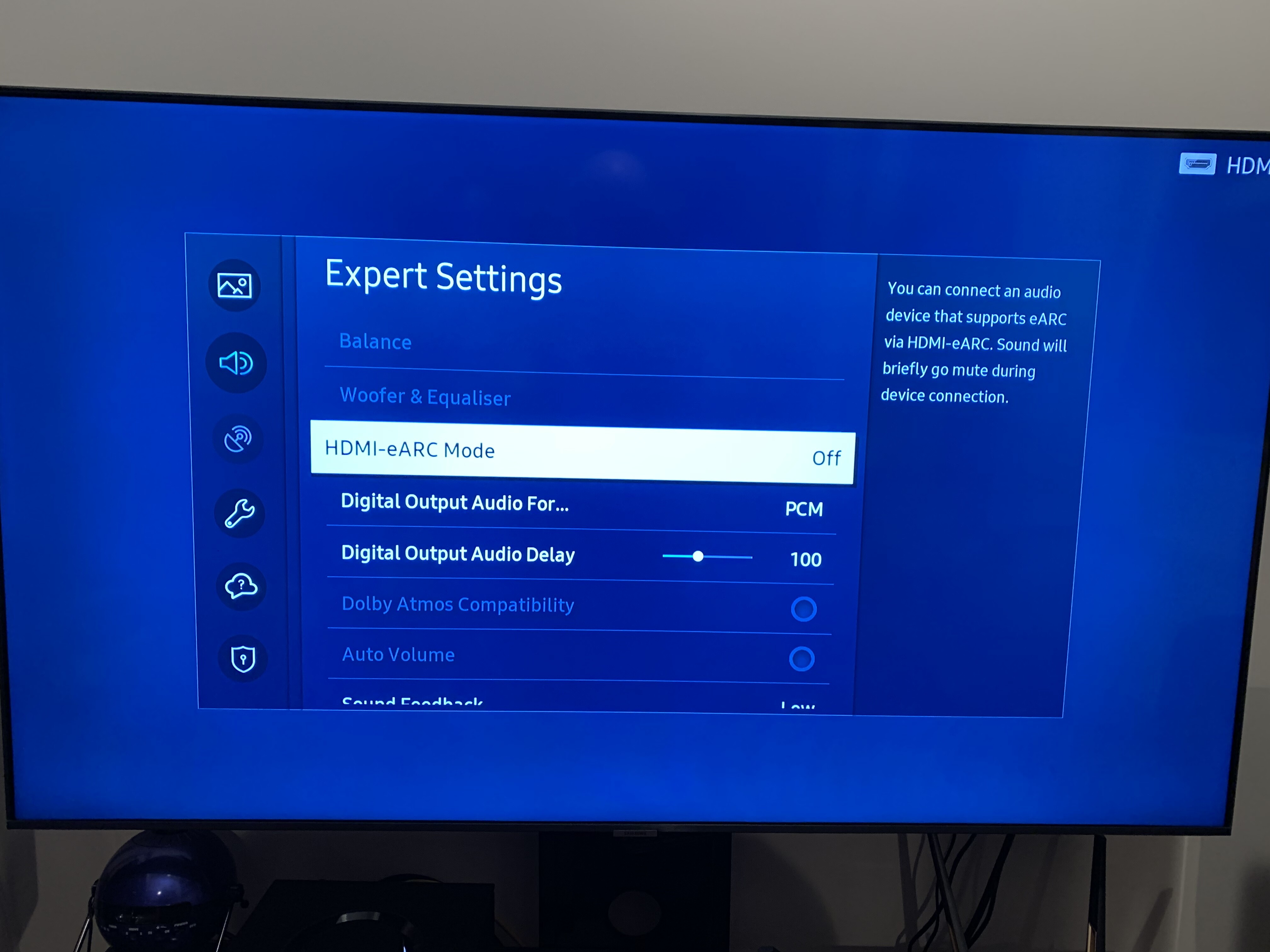

Had similar experience on the atom. To resolve I have set the arc setting on the Samsung TV from auto to off. Now works perfectly, Uniti switches on and off when TV is turned on/off etc
Thanks for you quick reply @Zhenya. Do you mind sharing how you did that?

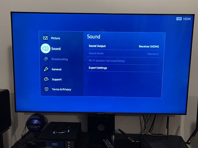

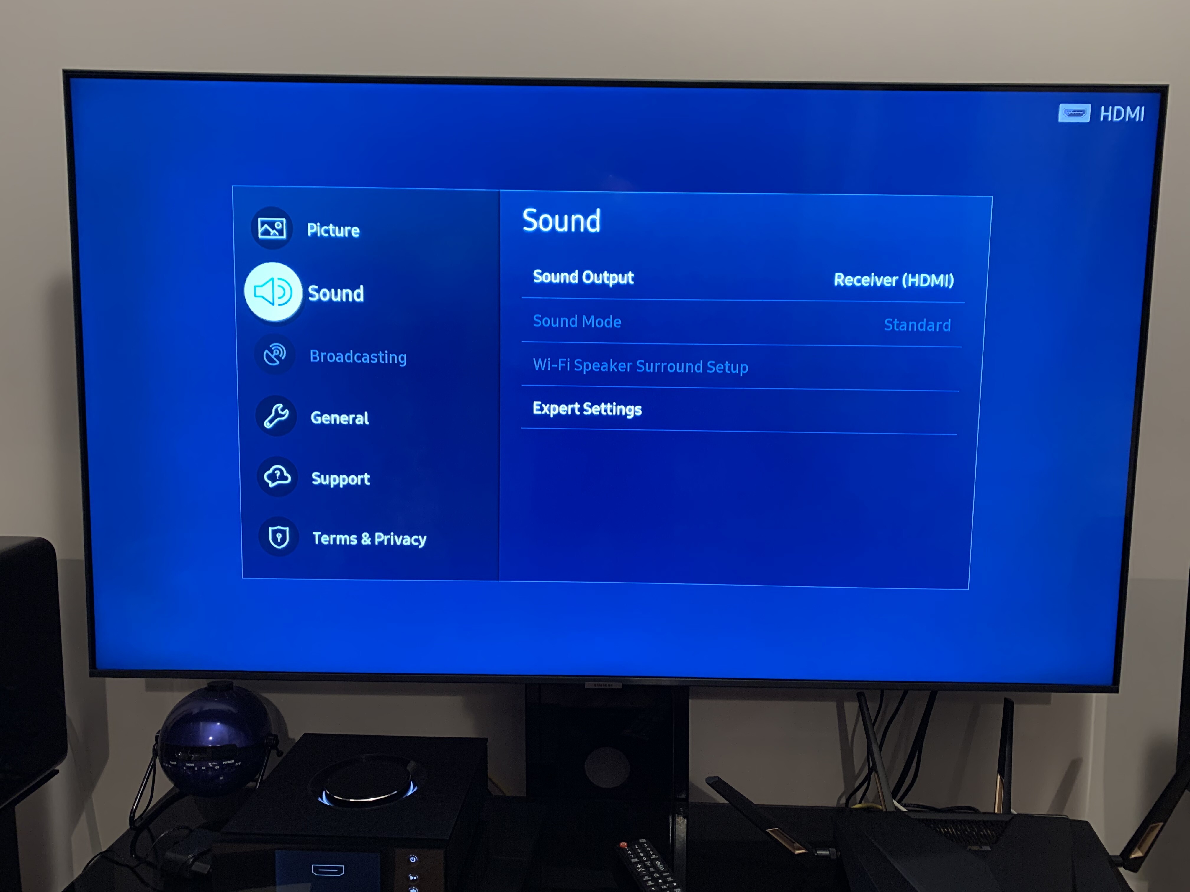

This is how my settings looks like right now:
When I googled it, I found this one, but system menu doesn’t look like my own TV’s settings (different firmware/model I assume): What eARC is and how to set on Samsung Smart TV | Samsung Jordan

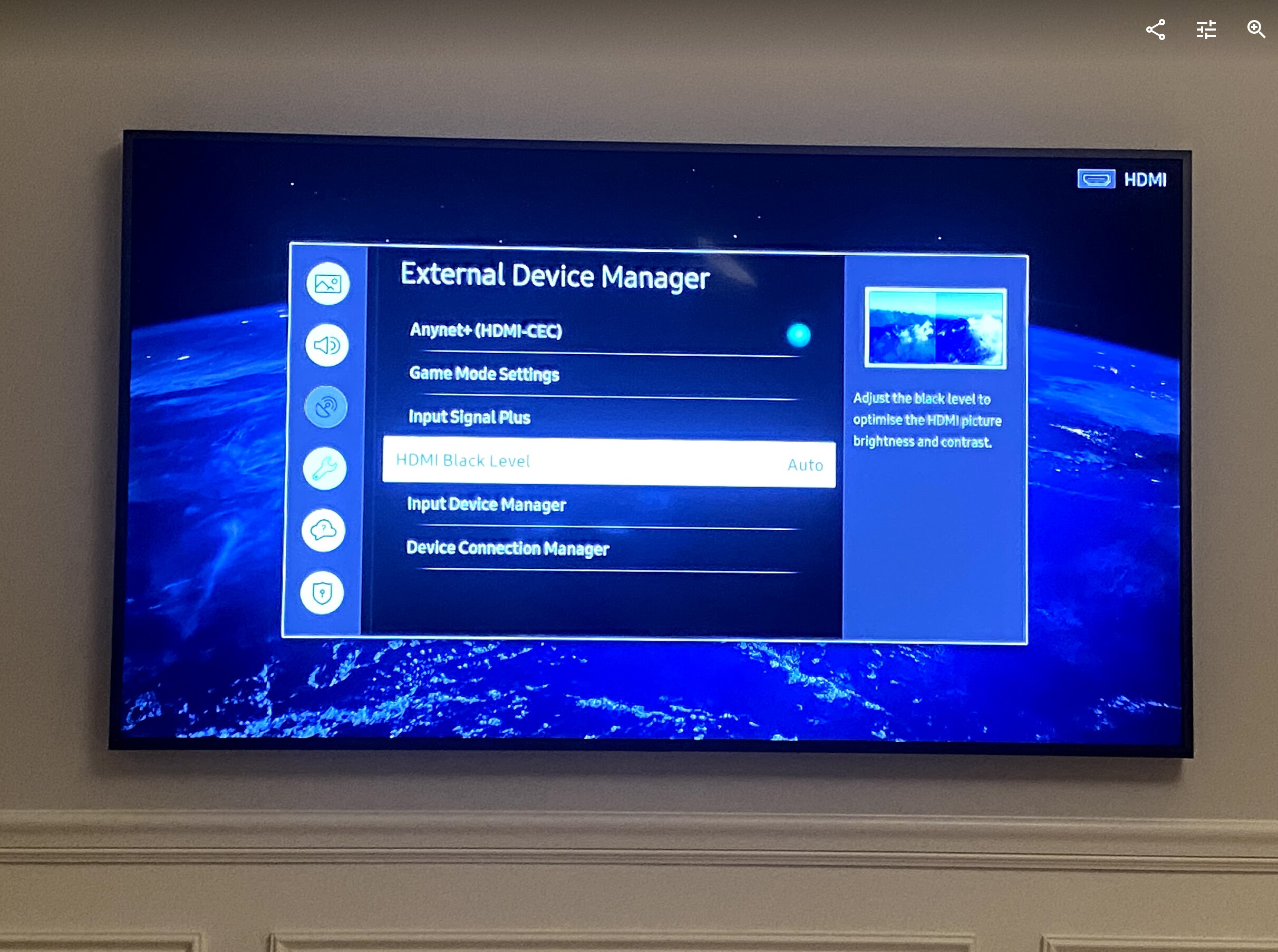

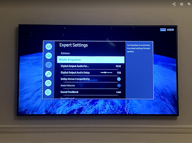

On my TV (FW 1420) the settings look like this

Thanks for showing screenshots @Zhenya. Seems like we have different TV’s and firmwares running.

Might it be the case that your Uniti is not connected to the Arc HDMI port on TV and this is the reason the settings do not allow you to change the Arc connection type? The rest of the menu points seem similar to me
It is connected to the third HDMI port on the TV that says “(ARC)” and it was working before upgrading the firmware with the same port, so I just assume it is the right one :smiley:
