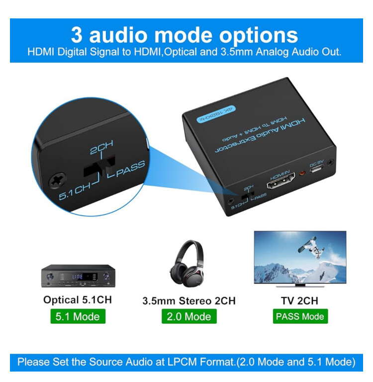

In that case I think you’ll need another box; this one will convert hdmi to optical and you can set it to 2.0.
So tv via hdmi to the splitter box, and splitter box optical output to the aids.
Assuming your tv has a second hdmi socket.
Nice one. I thought id need some intermediate box. The one for the aids is not cheap, neither are the aids. Which surprises me they can not cope with the latest toslink in data.
