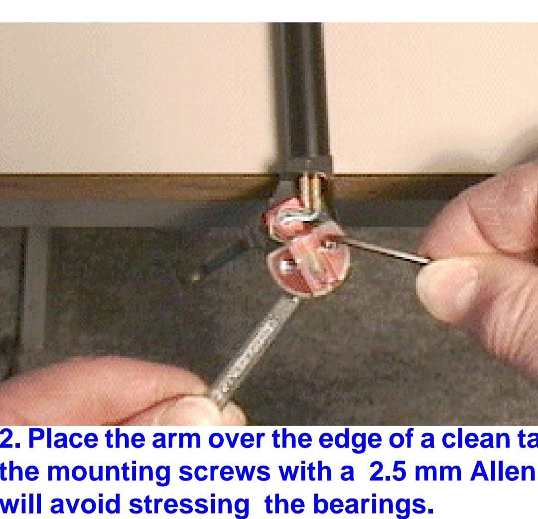

There is a very clear step by step set of instructions here. I’ve seen it done a few times and am happy it’s ok.

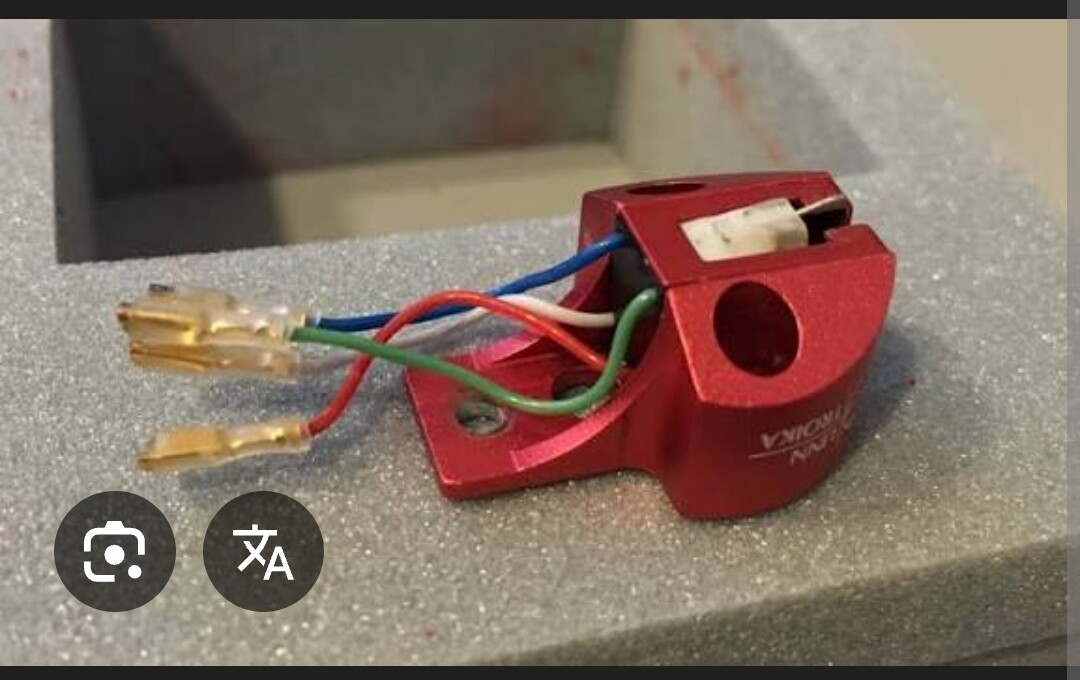

Those instructions are for replacing a LINN cartridge in a linn arm.

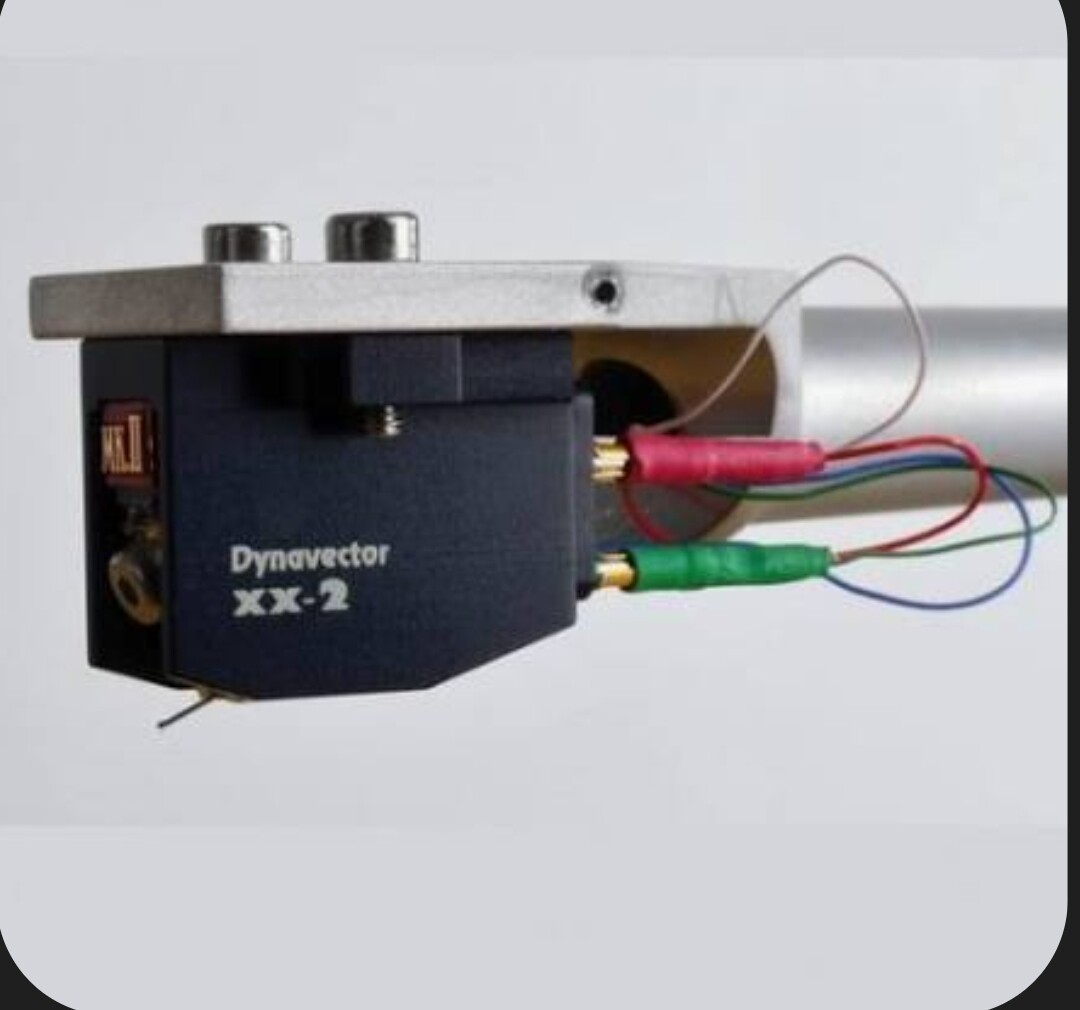

Philip has a Dynavector cartridge, it’s quite easy to remove and replace without removing the arm. The tags are connected to the the cartridge not the arm.

But, if a force is applied to the Allen key, the torque produced will be cancelled out by the torque produced by the force applied to the spanner. With no or little force applied to the bearing.
If I was undoing a tight cartridge screw/nut, I’d position the spanner and allen key along the axis of the armtube in such a way that squeezing them together would undo the screw/nut.
I was suggesting that placing the tags onto the dynavector cartridge pins wouldn’t be a problem with the arm still on the deck, whereas placing the tags on the pins on arm might be difficult (which is what you would need to do if the linn cartridge shown was being fitted).

The thread concerns removing linn cartridge from linn arm. In the instuctions provided in the link, removal involves using a spanner and an Allen key. My suggestion is relevant when removing a very tightly secured linn cartridge.
If you do as I have described, I believe no stress will be put on the bearing.
It would be good practice to use this method even if screws are not tight.

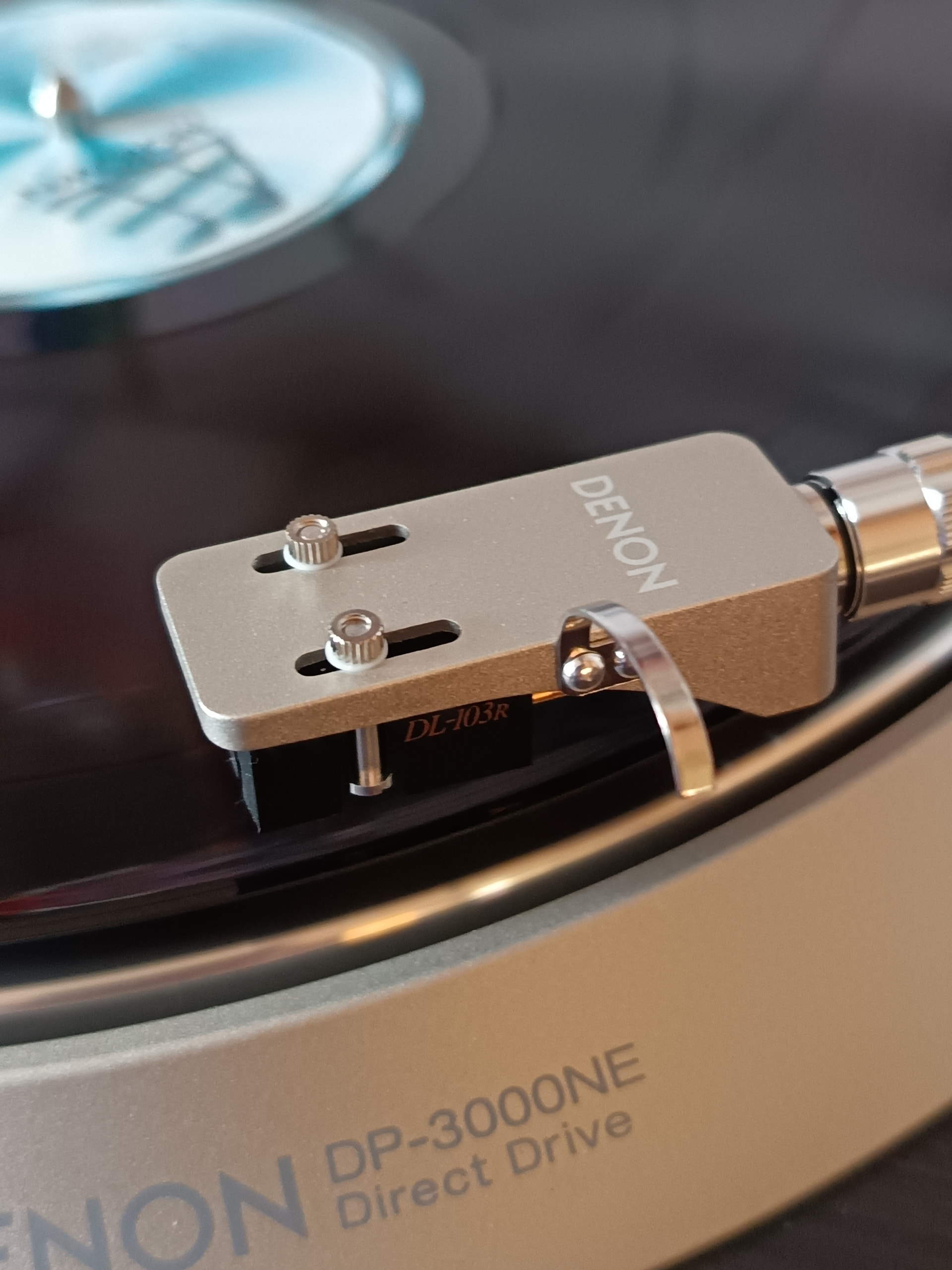

I don’t have that problem, the cartridge I used requires the nut to be finger tight. It is supplied with round knurled nuts.
