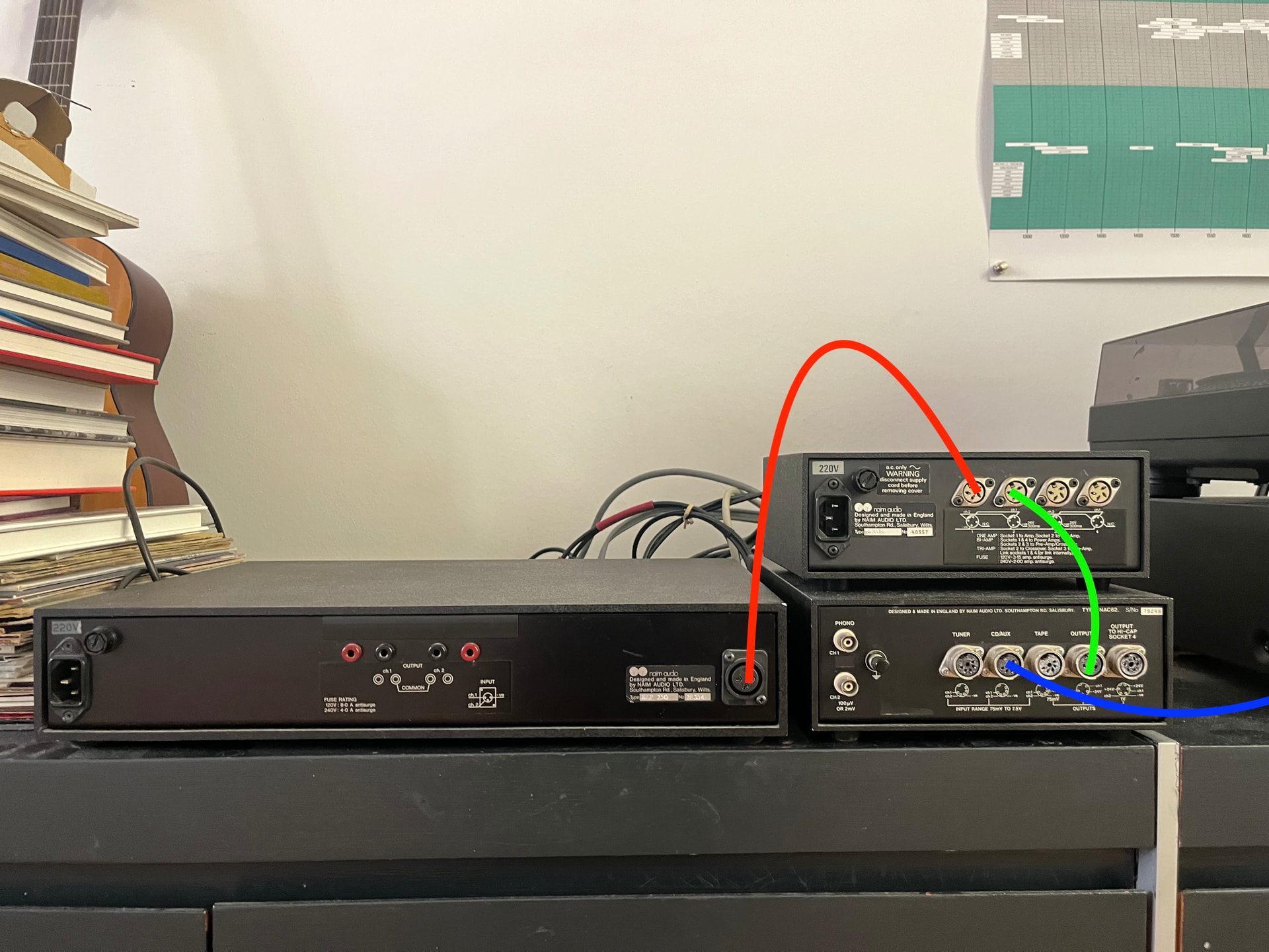

Dear All, I inherited a rather ancient Naim set-up from my father. It consists of a NAP250, a NAC62 and a SNAPS. I assume these have been bought in the late eighties and I recently had them serviced for what I hoped would be minor repairs. However, when connecting them, I never got anything but a rumble coming from the speakers. Here is a photo of how I connected them: is this the correct way?
As your SNAPS is still in its original single-rail form, you will need a 5 pin DIN link plug fitted to the NAC62 (far right socket in your picture), otherwise you will have no sound.
Thanks, Richard. Just to fully understand: I will need to use the “Output to Hi-cap Socket 4” instead of the “Output” socket on the NAC62 to connect to the SNAPS at socket 2? And use a cable connecting / converting a 5pin to a 4pin?
No, your connections all look fine - SNAIC 4 between NAC62 and SNAPS, and then DIN4-XLR (white banded) between SNAPS and NAP250. Just you will need to fit the 5pin DIN link plug to the far right socket on the NAC62.

p.s. on the SNAIC 4, make sure the banded end is closest to the NAC62.
Yes! Now it’s working! This gave me a headache for weeks, but I would have never guessed that little plug was the missing piece in the puzzle. Thanks so much, Richard!!!
