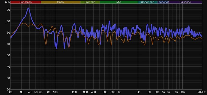

FWIW I have ProAc D20Rs and really like them but had a troublesome bass boom/overhang due to a room mode, on some tracks, but was able to sort out with UMIK1, REW, a clever convolution filter (DSP) and Roon (graph shows before and after DSP below).
I tried passive bass traps first which did enhance bass response but didn’t do a lot in sub bass area.
Your measurements do look similar to mine and as I say apart from my sub bass issue I think the Naim/ProAc combo sounds very good.

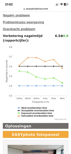

I would like to improve the reverberation time and improve the bass response. With music the bass is not too bad though but I’m sure it can be tighter. With movies it can be boomy at times.
At times my room can become a bit over lively also.
Reverberation time around mids and upper mids is affected by hard surfaces… soft furnishings and curtains are key to controlling this.

The frequency response does not look over lively/bright and as I say looks good - enjoy .
With regards to reverberation time, this is what I got from a measurement with a starter shot. It probably is a bit better at the listening position as this is an average of the whole room where they also took measurements in the dining area and kitchen.
Orange is the line for my room.
