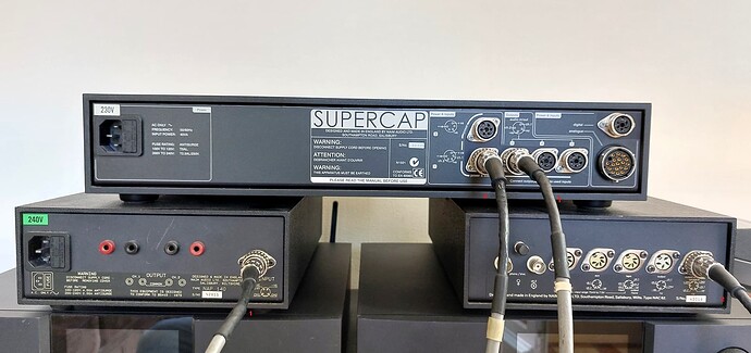

I have a spare supercap which I want to connect to a nac 62/140. Does this look correct?
Thanks
In case its too small, the right hand connection is numbered 1 and goes to the number 1 on the 140.
Left hand connection is numbered 2 and goes to connection on the 62.
Yep. That looks fine. SC Socket 1 to the 62, 3 to the 140.
Thanks. All working fine.
Do you happen to have spare SBL’s and a spare CDS as well ? :slight_smile:
I wish.
The only thing to add is that the Snaic 5 appears to be the wrong way round, unless the band is an add-on and the original is at the other end, ie the band should be at the preamp end.
Good spot, thanks.
I’m just pleased I spotted something that connection supremo James missed!!
