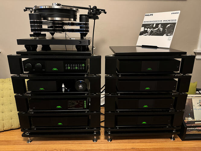

The opening post of the System Pics shows the Fraim stacks on my main system. There you’ll see a pair of intermediate levels in the centre with standard levels on either side.
You’ll see that a base + 2 x intermediate levels is the same height as a base + 3 x standard levels. Intermediate levels should be high enough to clear a NAP500 head unit. If you need more, there are the extended levels, where 1 x extended level = 2 x standard level in height.

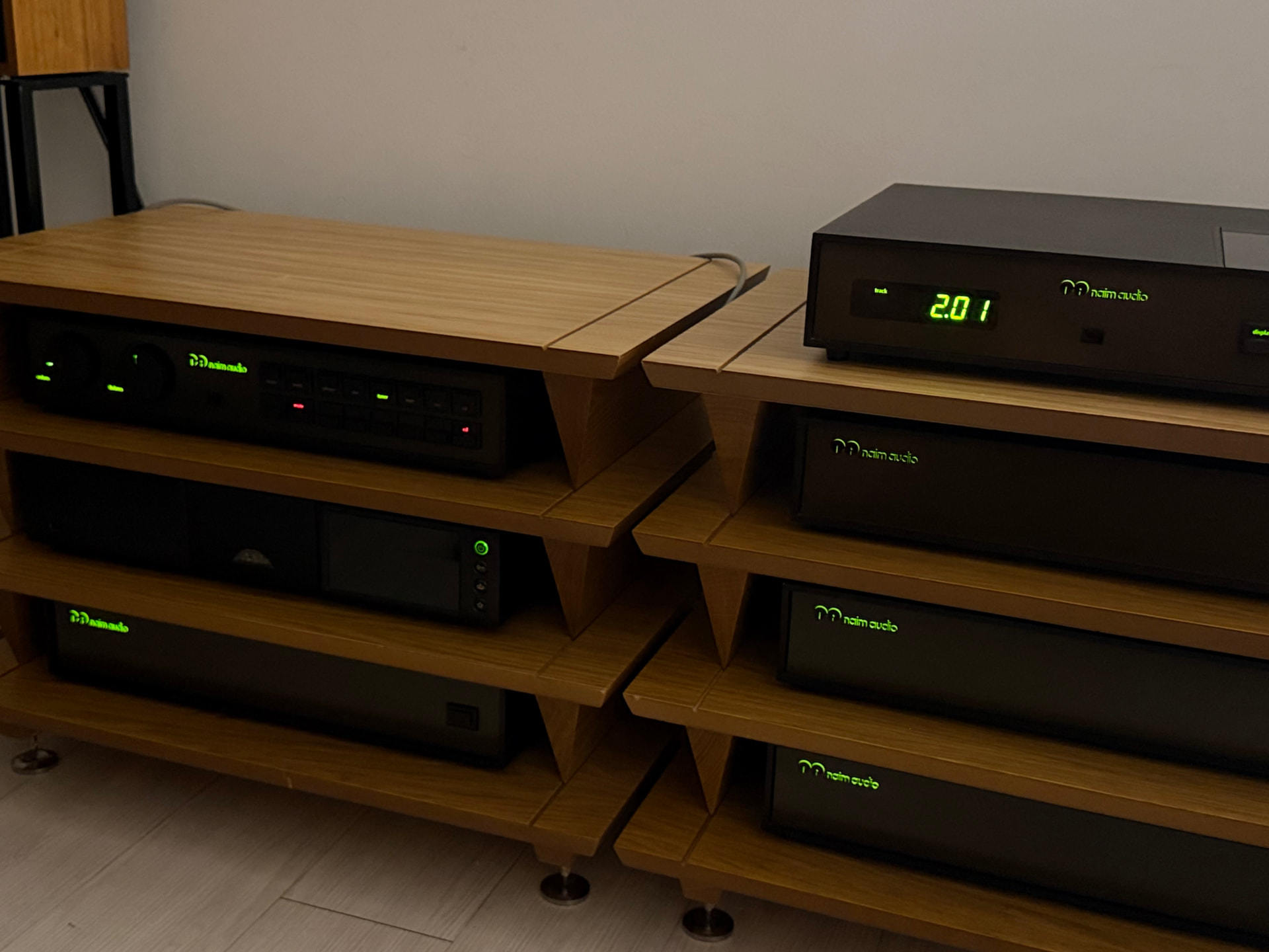

And obviously not the best arrangement due to space limitation, but the default spacing is good enough for my 135 and look best, max 4 levels aesthetically imo.
I saying this being in East Asia – it actually warm up a bit faster, and when weather is hot (not warm) we just turn on the AC anyway.
We seldom listen to streaming so the NDX 2 in sleep mode most of the time, act as spacing level when we listen to CD. Blanked level is for the upcoming LP12
We also did experiment putting the cd player on top of 52, performance compromised big time, just like what Richard said before.
These things usually involve compromise. The ideal thing is to get the source and preamp on the brain stack, and their power supplies more or less directly beside them on the brawn rack. The Burndies should be just the right length for this.
