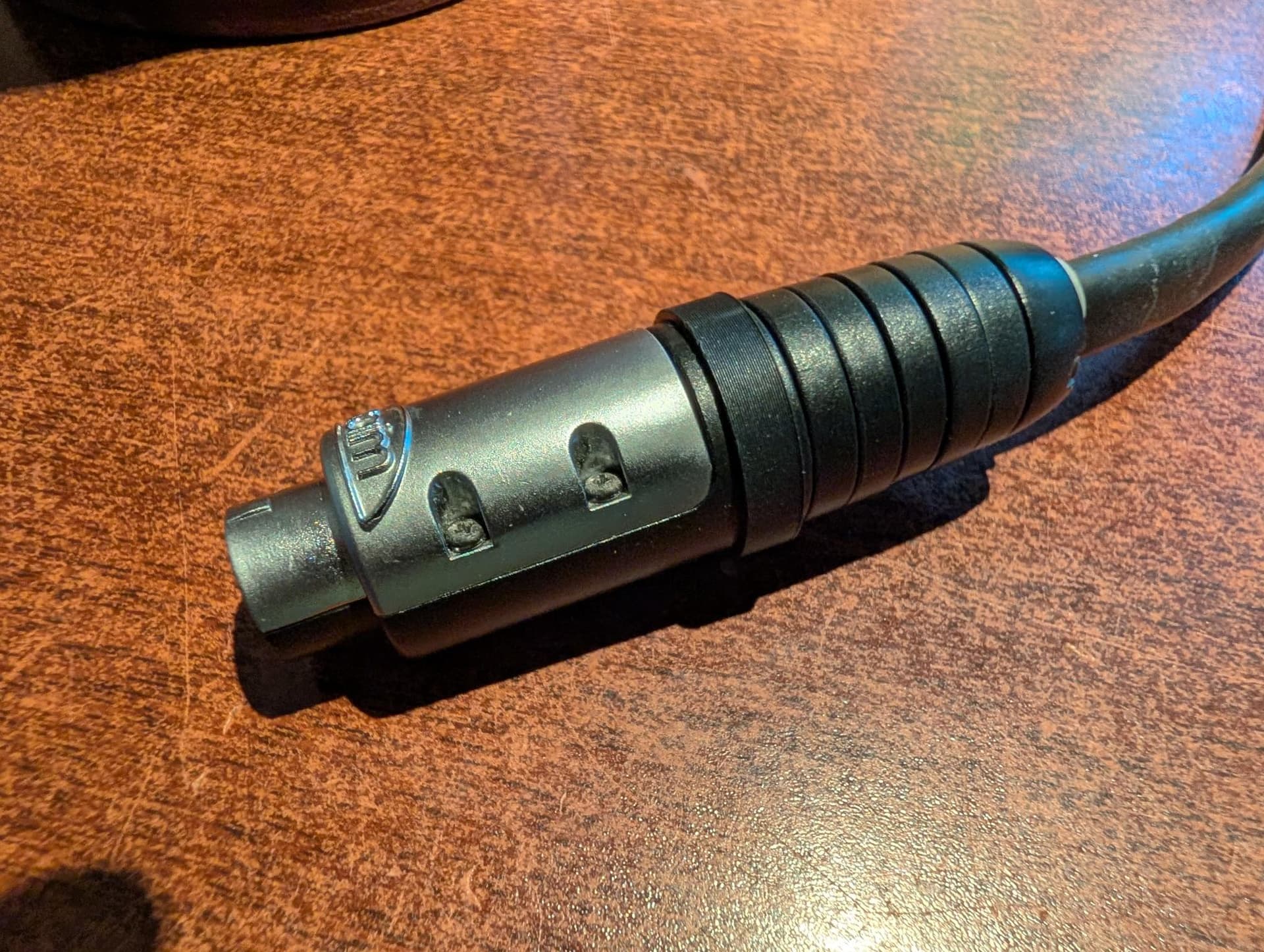

Greetings from Australia! I just bought my first Hi-Line cable for my new NDX2. The source end fell apart when I was plugging it in so I designed a couple of fixes that I hope will retain the decoupling benefits of the delicate connectors.

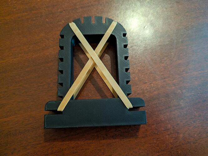

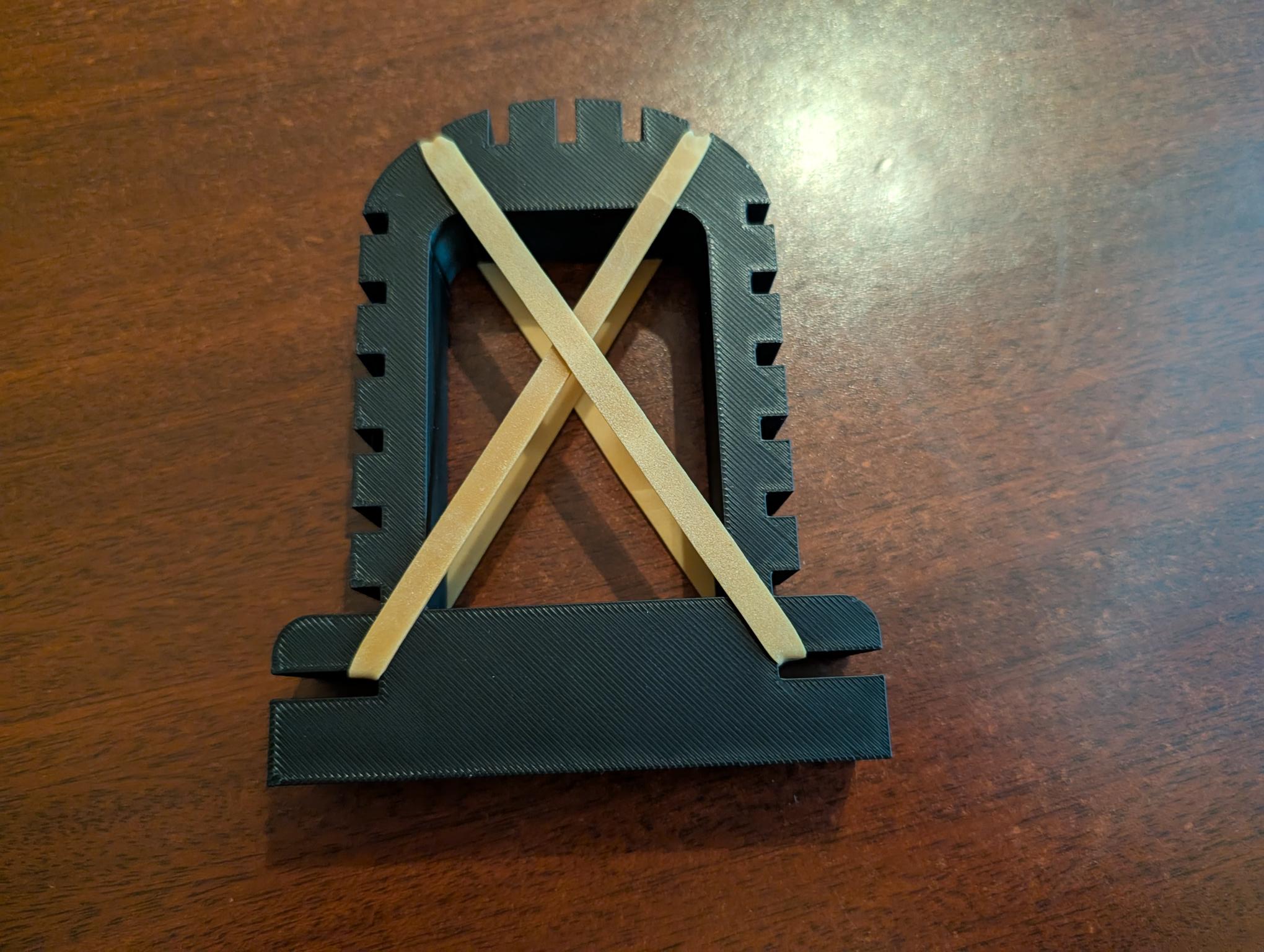

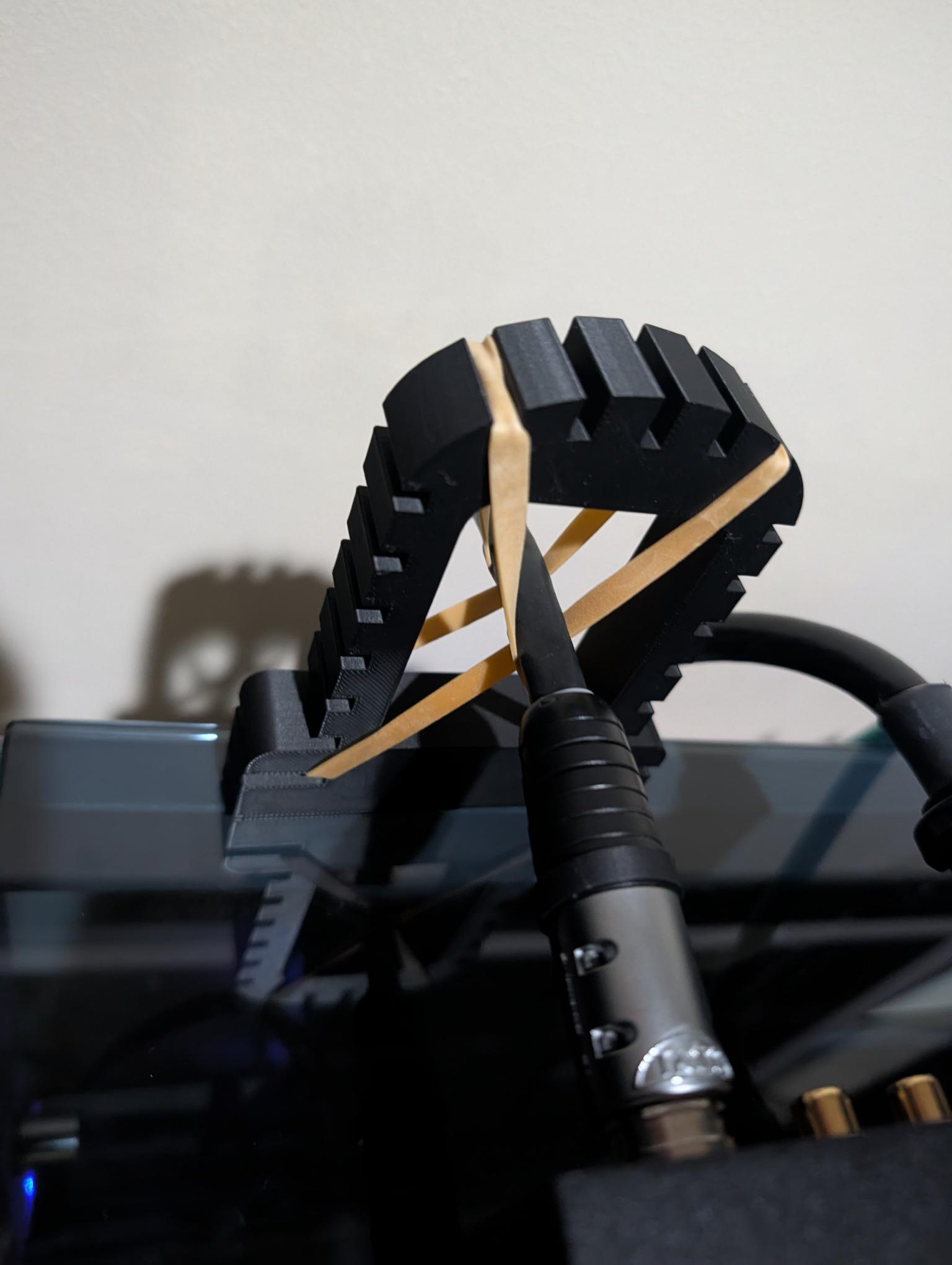

First I printed a ring that fits VERY snuggly over the broken ring. I thought that was the fix but the weight of the cable broke it again. I designed this support frame that holds the cable with rubber bands in an effort to retain the decoupling.
Any constructive criticism is welcomed and I’m happy to share the STL files.
Ingenious, but heterodox. I use a piece of string to keep a signal cable away from a power cable. In case you didn’t know, Heath Robinson was a Norse god.
I think part of the intended design of the Hiline is to let it hang freely without any contact. I’d send it in for repair and call it a day. Nice effort btw!
The two things you have done will negate the whole point of the Hiline design. Send it back for a repair and then use as intended, ie hanging freely, not touching the wall, rack or other cables.
I Think it’s time to rename this thing the LowLine.
The latest HiLines feel lighter in weight, better built and sound better. Have it fixed, sell it, and buy a new one.:index_pointing_up:

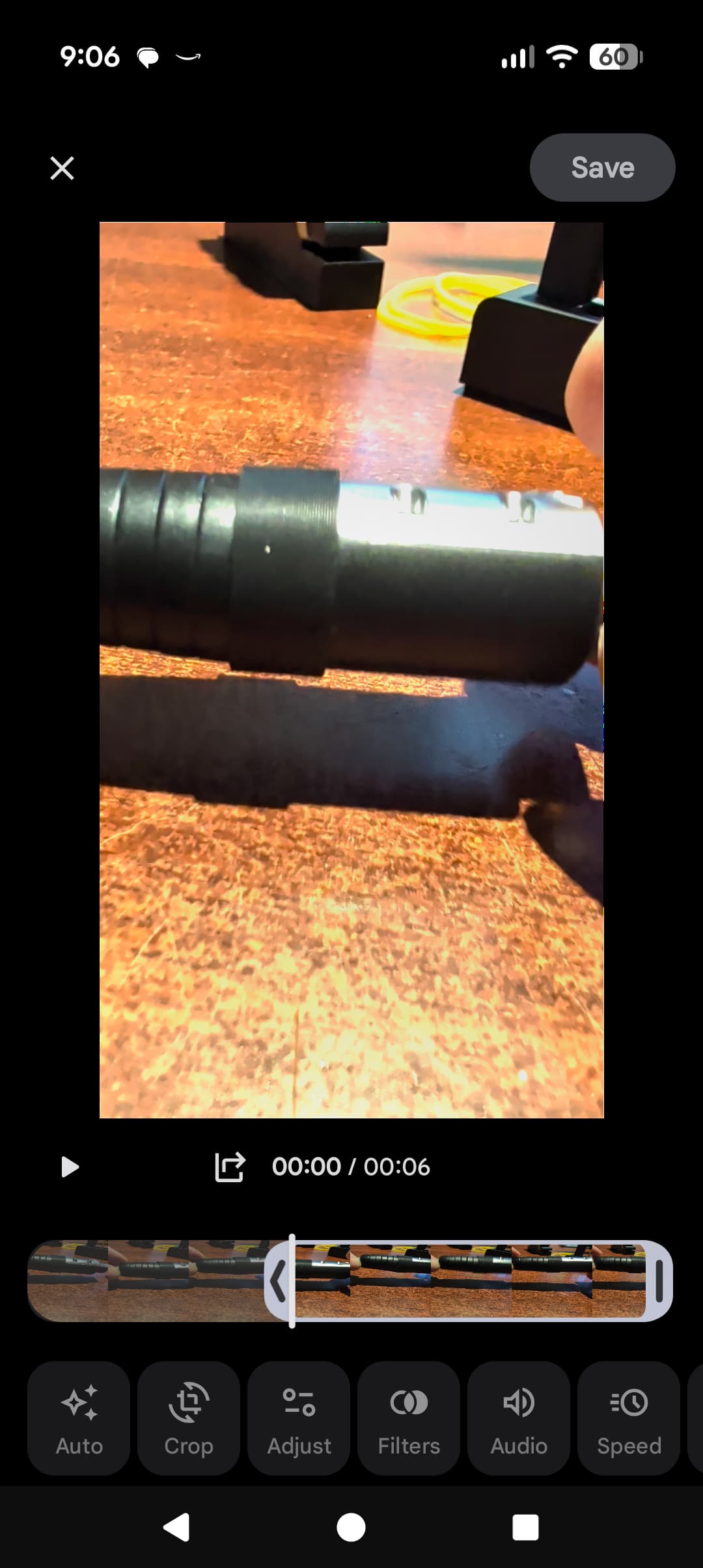

UPDATE:
Even though most didn’t like my “fix”, I thought I would post the improved version. This one holds the broken ring well enough that the support is no longer needed. I know two of the joints are bridged which will reduce the decoupling effect a little. When I compare the fixed one to one that hasn’t been broken, there barely a difference in how they feel.
That’s how I ended up with a damaged Hi-line. The piece of string suggestion is much better.
Of course, sending it in for a proper fix would be the ideal solution. However, this seems like a better work-around than the suspension rig to me. At least several of the microphonic absorbing rings can function as designed.
That’s my thinking as well.
I went through three and had two repairs before it being a contributory factor to leaving Naim. I will say that, regardless of how it was intended to be used, I never had any change in sound quality when it was in contact with anything whether other cable, wall or skirting board. The only time there was a noticeable, describable change was when it broke.
