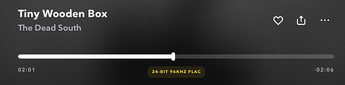

@bhaagensen
Tried this tonight…
Same track 24/96
iPad lightning to USB front input nDAC - NO two lights on nDAC.
Pause mid tune,
iPad lightning - Apple Camera Adapter - SMSL - toslink - nDAC… two lights on nDAC (hires).
So it does seem that direct USB connection is somewhat limited (I think to 48kHz).
Playing from Tidal the track Stevie Wonder, Superstition - via our normal setup (SPDIF to NDX2)…SMSL lights go red (24/192) so an iPad can output hires, it’s up to the connected device to interpret.
