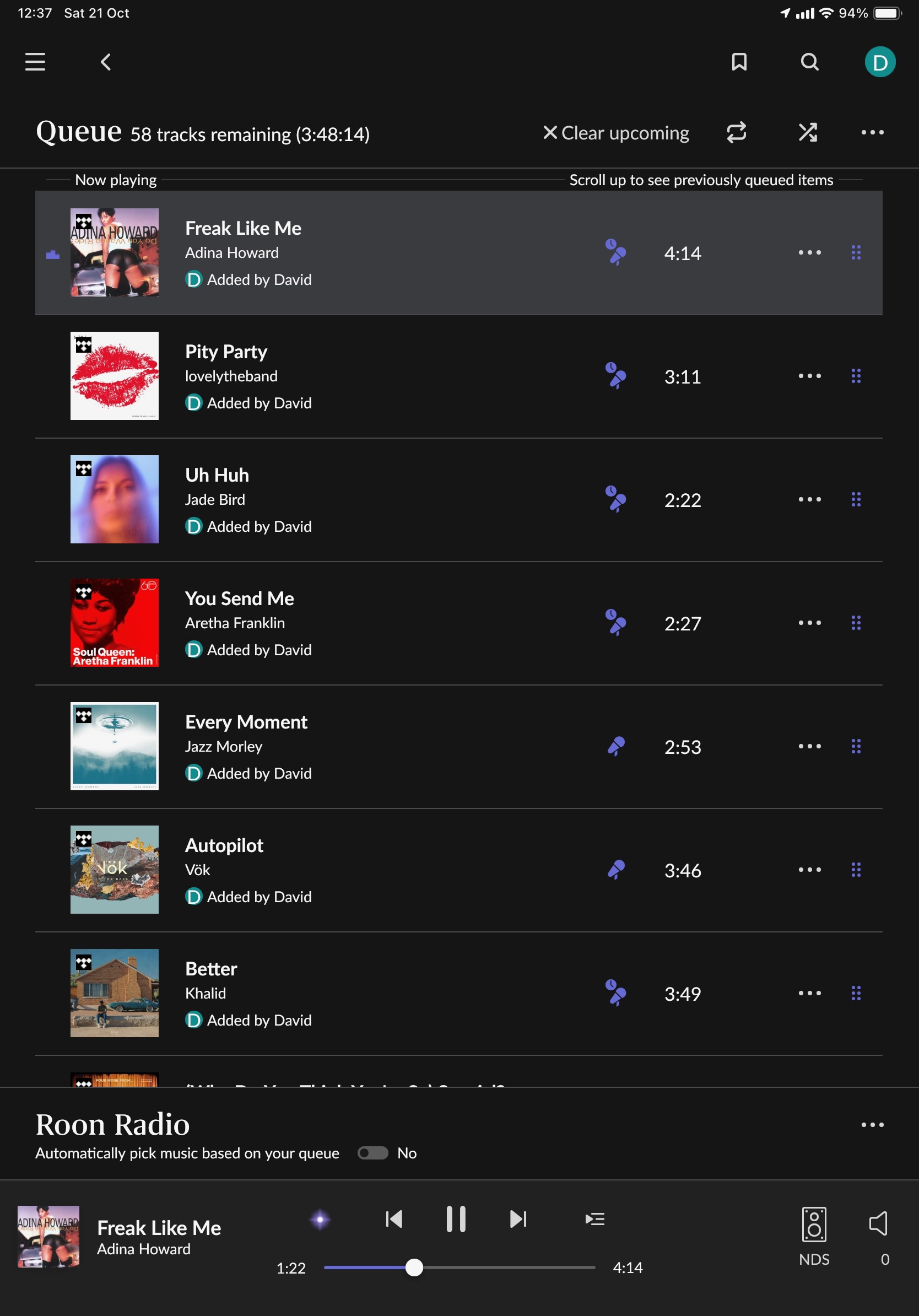

a) If i use the Naim app to play a HiRes file it works perfectly as soon as I select multi room to connect the Musos it stops and I have to restart the NDS
b) if i use Roon /Sonore bridge it works perfectly until I try the multi room then it starts skipping tracks and the NDS needs to be restarted.

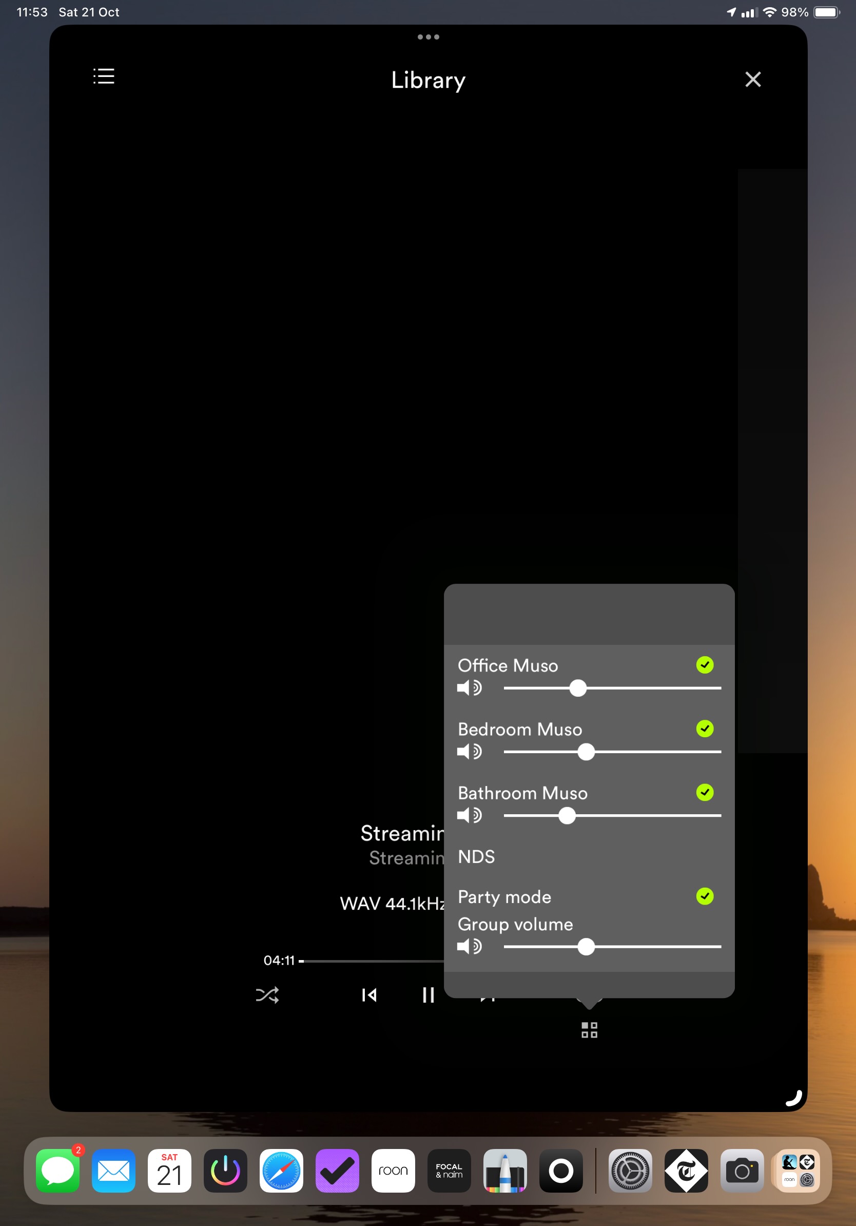

Airplay I guess. I select the track from Roon, then go into the Naim app and select the rooms. Clunky but it works and I only have to do it once.

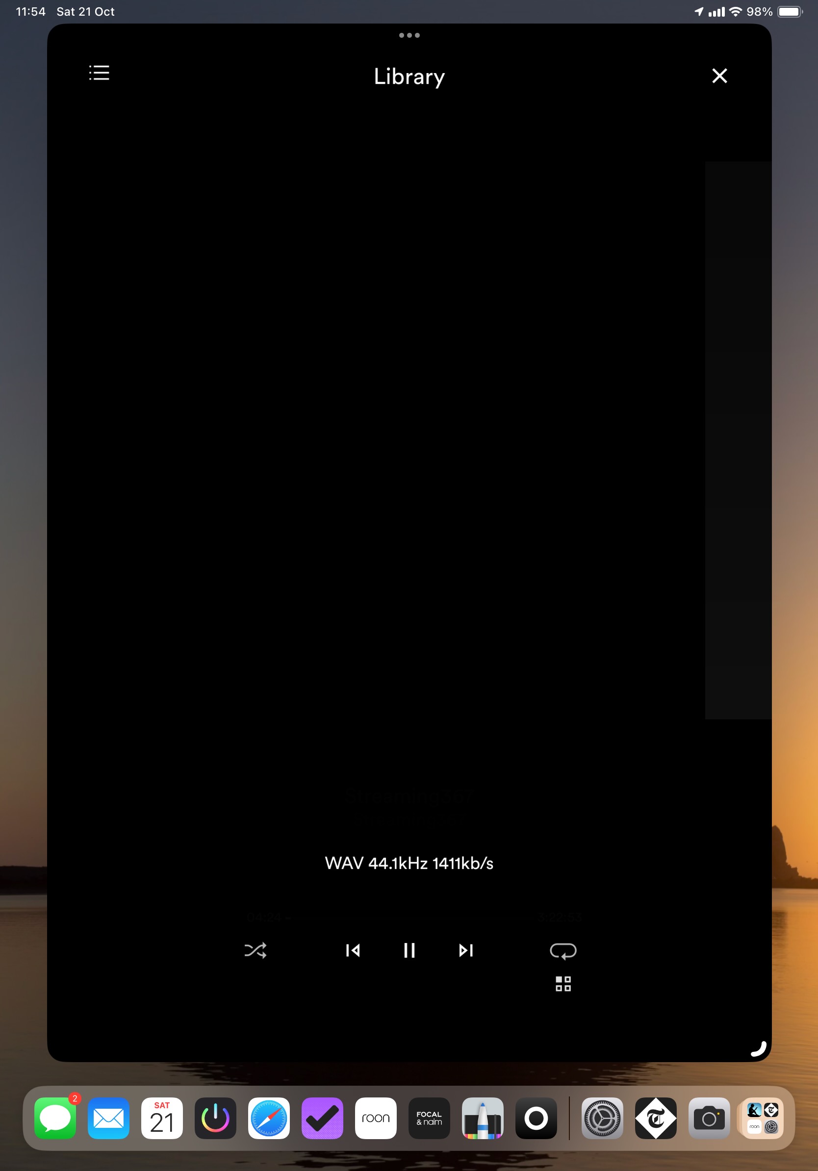

To clarify, the NDS, Roon/ Sonore works perfectly well with multiroom to 3 generation Musos until I try and play a HiRes file. Then it fails.
So my question is: will upgrading to Muso 2nd generation solve the problem and allow me to play multiroom as I do with regular files (CD rips)

Are you sure about this? Roon creates its own multiroom groups which are completely different from Naim multiroom, so can’t be controlled from the Naim app.
Absolutely positive. Select the track in Roon, play it then, got to the Naim app which says streaming, go to the multi room at the bottom right and select the musos. Been using it for years, work perfectly, totally syned between rooms . It all falls apart with Hi Res files as described!
One must have Sonore Bridge though which uses Squeezebox which you have to enable in Roon .
