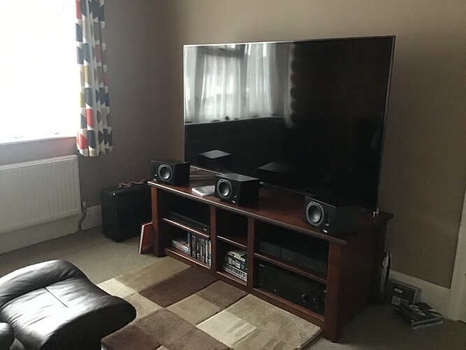

I posted these two pictures a while ago.
The room is only for cinema use.
65inch Sony although I think I will move on to 77inch oled. Bigger is better. I watch at least one film per day if not so mobile two.
Sony mid range blu ray and av. Netflix and Prime although I prefer blu ray.
Three fronts Neat Iotas
Two rears pmc db1
Q woofer although a rel 5 is in the offing.
Comfy Stressless recliner.
Not practical to incorporate my Naim system.
Local cinema is due to re open in the spring. Can’t wait
